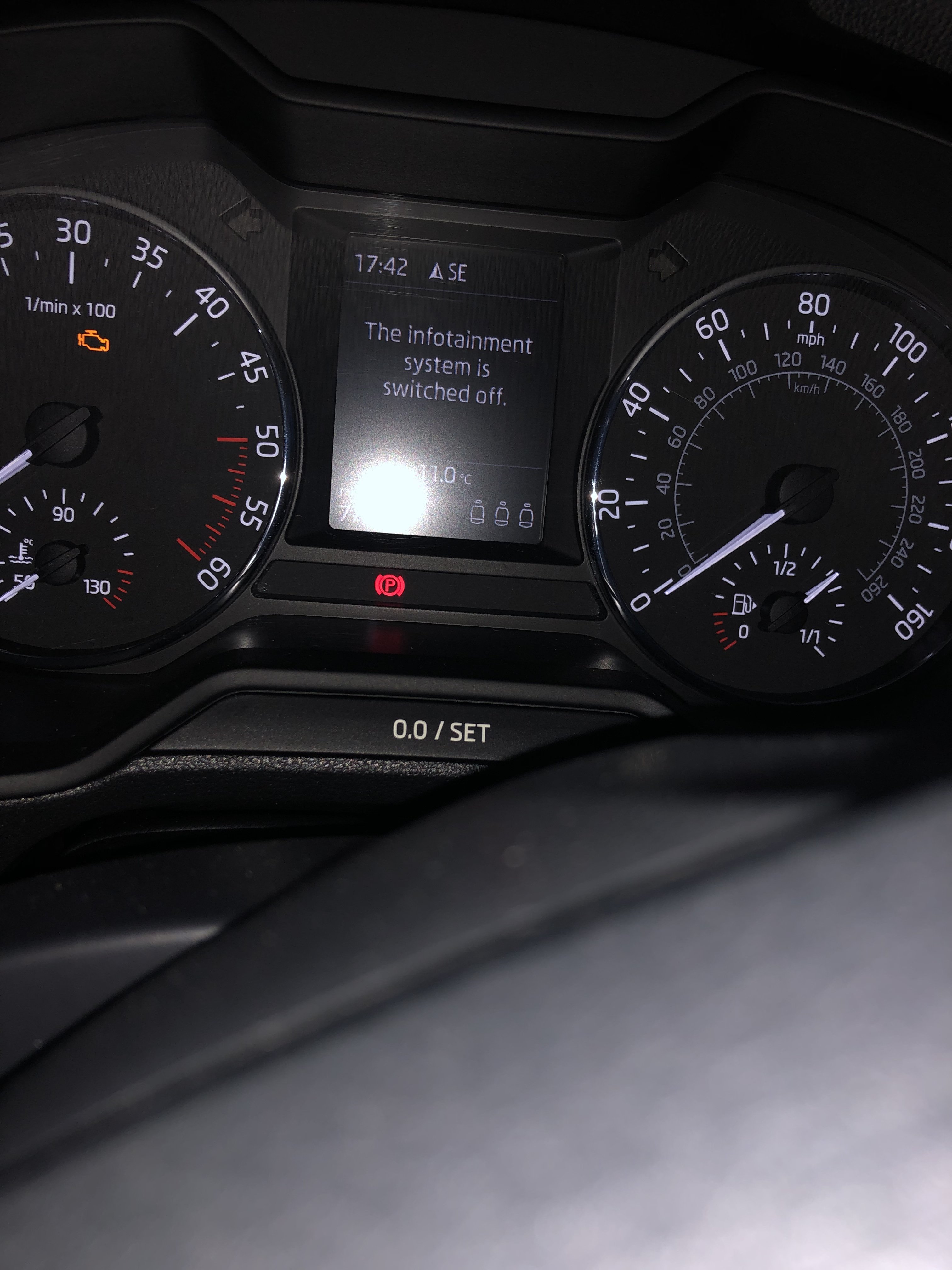

When I first start my car it shows 3 car seats on the dashboard, even if I’m the only person in the car.
Is this another thing wrong with my car that needs fixing or completely normal?

the seatbelts are unfastened too
Not a wonderful photo, but hopefully this helps
Completely normal in my experience
That's the default, try loading something on one of the seats and the symbol will change, and you'll get the "bong" noise if you drive without the seatbelt done up.

Mine does it too. Never understood what it's supposed to mean, but the seats disappear quite quickly.
It shows the back seats, will show up if someone is sitting in one and will then show when they have put a seatbelt on. Goes out after a short while.
It’s a requirement for Euro NCAP, seatbelt monitors on all seats. If someone is in the back and removes a belt the light flashes up with which belt it is and the car bongs. My Citigo has it too.

There is no sensor for a passenger (weight sensor) in rear seats, only sensors for seat buckles.
