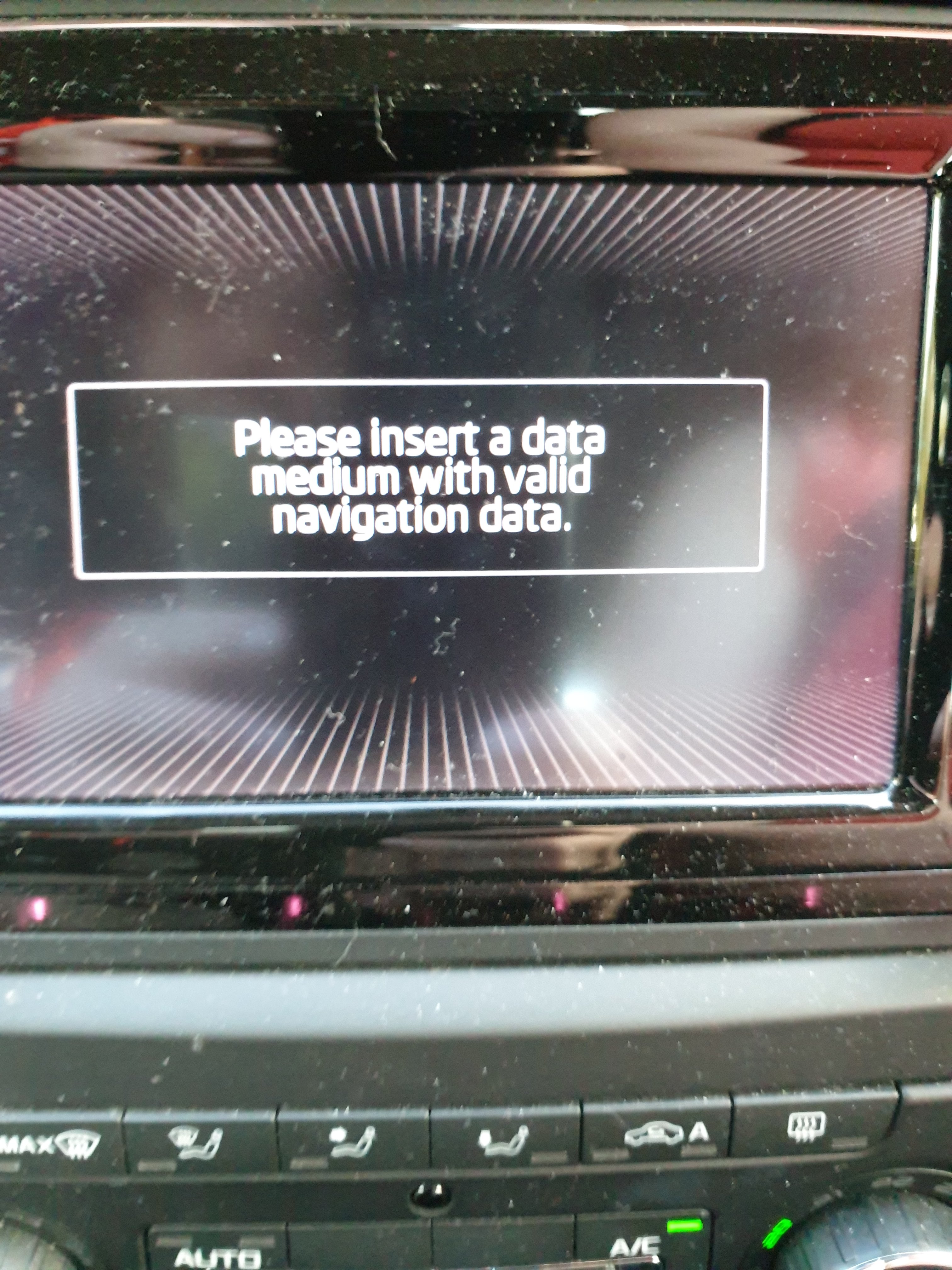

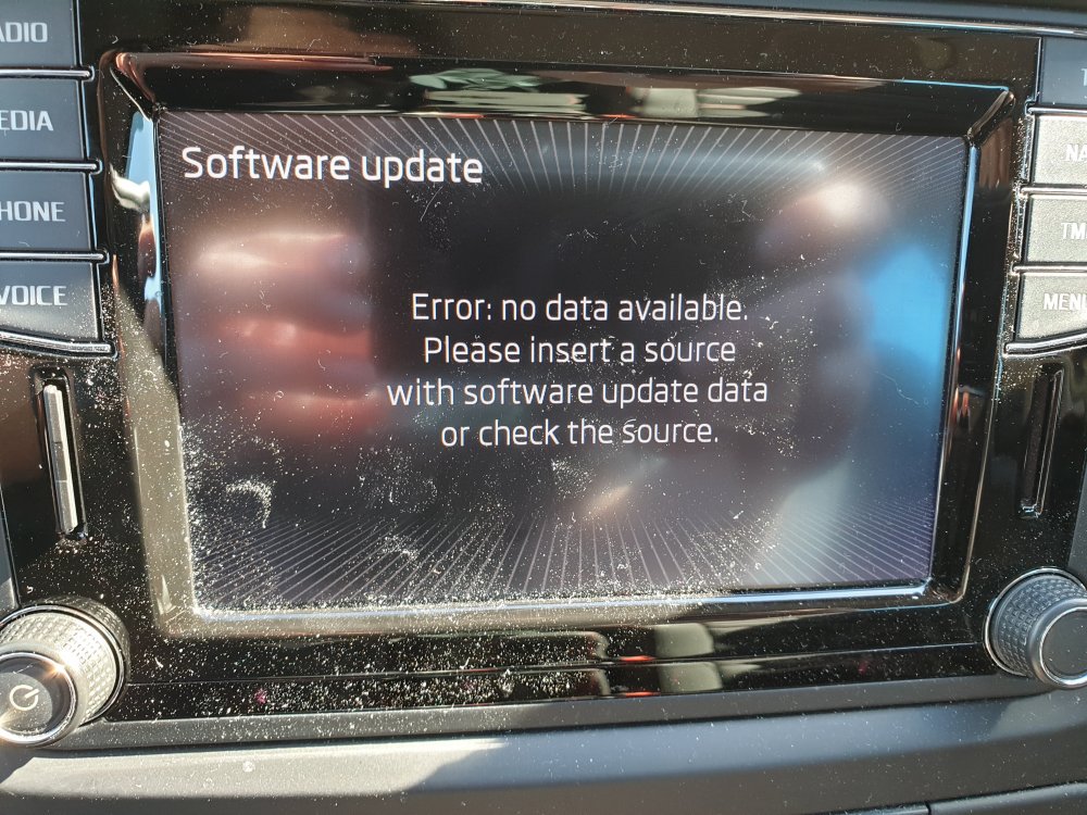

In the first picture are the details of my system before the dealership attempted the update of my maps. The second picture is the error received when attempting the map update. While I wait and wait and wait for the dealership to contact with a solution, I hope you smart people can assist. They sent me home with the 2018 maps for my Amundsen Sat Nav, Bluetooth, DAB+ system. Currently, I have no working maps. 2015 no longer works and as mentioned, the 2018 upgrade is failing. When the SD card is inserted, it tells me there are sources, however, it fails to update.  This has been quite the saga, as the update portal for Skoda failed to find updates, despite there being updates. Skoda eventually agreed to supply the new maps for free and install them. They were obviously unsuccessful and here I am. My car is a Skoda Yeti 2015 and I'm based in Australia. Any help would be greatly appreciated!

Just seen you have a Yeti. There's no "update" procedure needed. Once the maps are copied into the card all you do is insert the card into the slot and use the nav as normal. Trying to update the unit is not something you have to do with the maps.

That maybe true, but this is what happens when either SD card is inserted and I press the NAV button. The card can be locked or unlocked, it doesn't change the end result.
Then your maps are not correct. Can you download them from the Skoda website and copy them onto the card again?

Rookie mistake. I formatted the Skoda SD card and copied the maps folder to the card. I now get the original error that he detects a navigation database, but it's still not reading. I don't know what Skoda have done.
Looks like the unit is faulty then. Possibly repeated attempts to update the units software.
