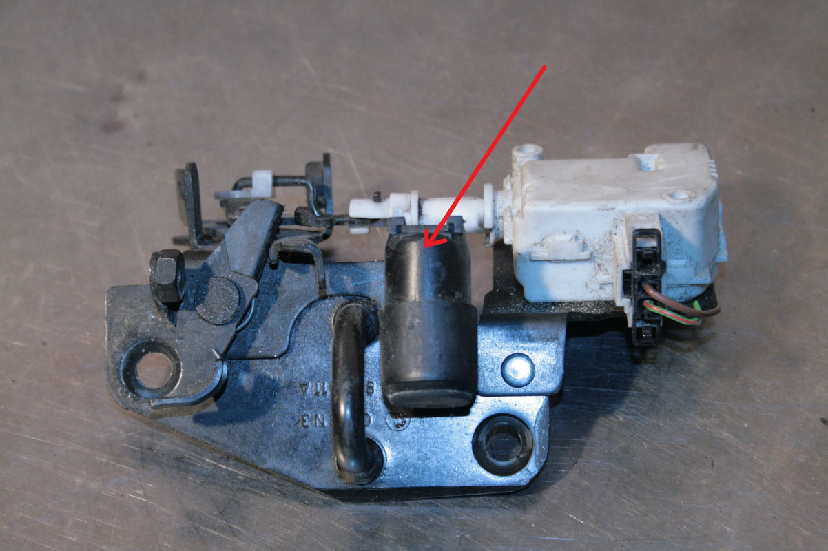

Lastly the boot release abouve the number plate doesn’t work. Can this be replaced on its own or do I change the whole door?

Open one of the rear doors and then see if the boot release switch works.  There is a microswitch in the driver's door lock unit that stops the boot opening if it's faulty. It's very common.

Also the boot release handle when pulled works, you hear the boot door release, but I think the switch under the number plate doesn’t work. Can this be changed on its own
Edited by Shabir
@TMB what year is your classic. When I pull the boot lever next to drivers seat, the boot does release. It’s when you go round to the boot, the doors partially open but still latched. I tho k the mechasim
under the number plate is faulty.

Give this plunger a good push and see if the spring is working...
