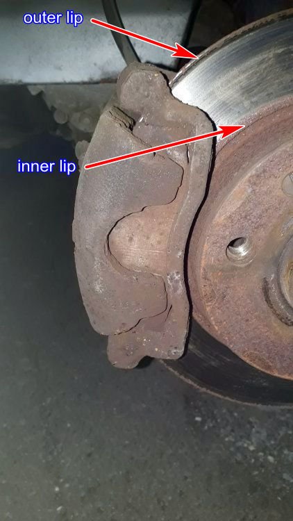

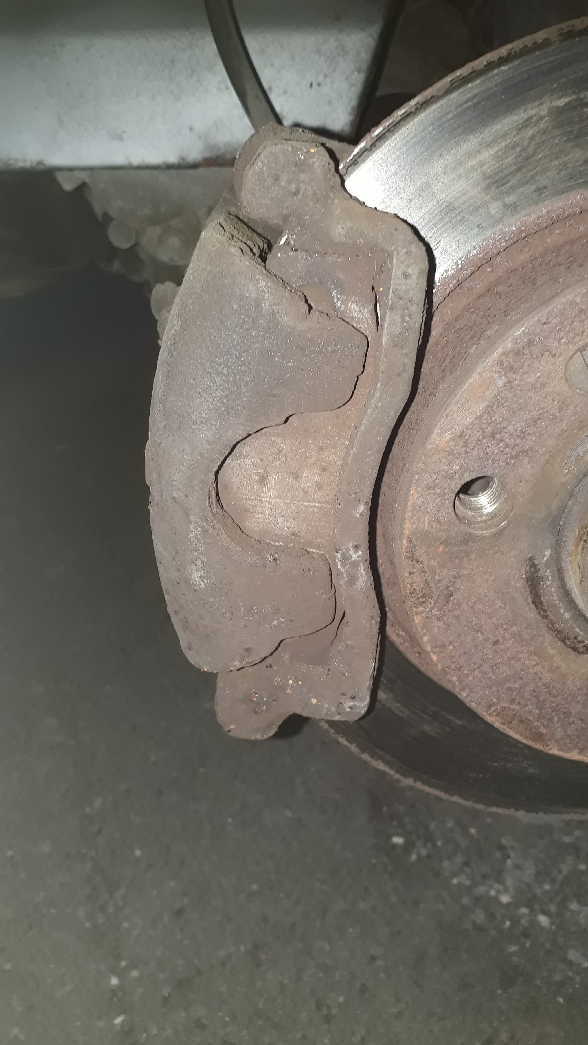

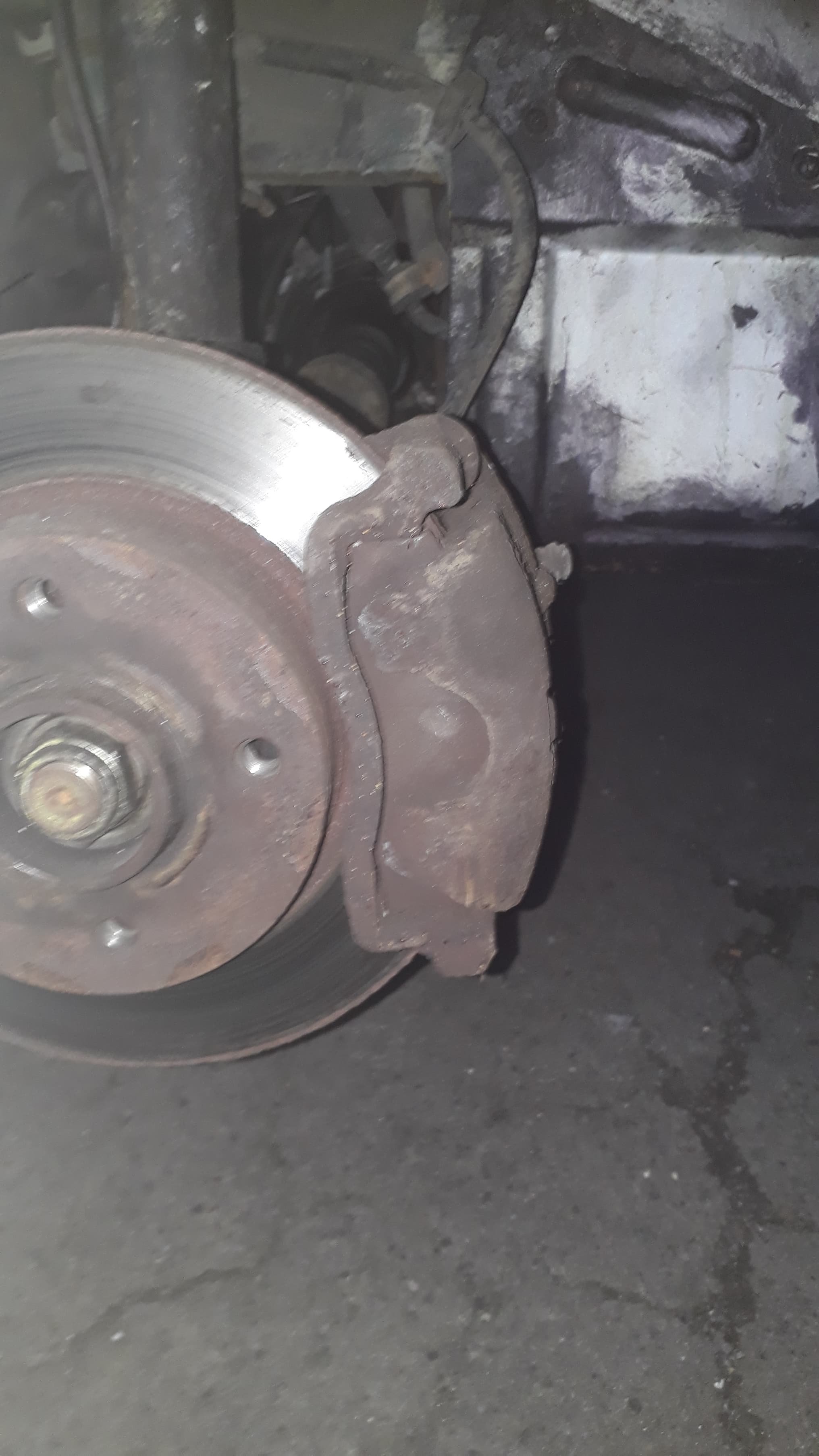

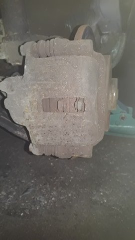

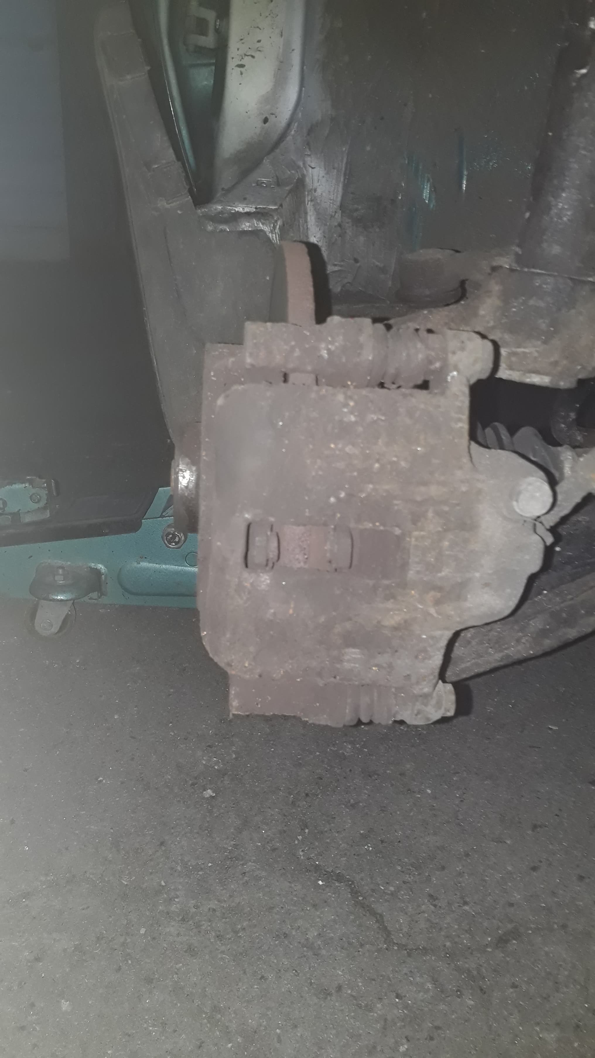

I had a look at my front brakes today when I was putting new wheels on, this is what they looked like:
I can't see something obviously bad but because it is a lot of dirt and rust I can't assess much on the wear of the brake pads. The brake disks seem to have enough 'meat' but their thickness should be measured with a caliper. Also it is a good idea to get rid of the 'lip' on the outer and inner part of the disk using a file.
When you say 'lip' Im not sure when you mean, should I try to remove some of the rust?
As far as the pads are concerned, the last time it was professionally checked, a garage had said the pads were 40% ware. The previous owner then had it on the road for a few months, then sold it to me and I have had it in my garage for about a year.
So I imagine the pads have more ware than the 40% but not too much more. I have ordered new pads anyway though.
Edited by lotrjw
6 minutes ago, RicardoM said:
Ah right thanks, so cleaning the rust off is a good idea then.

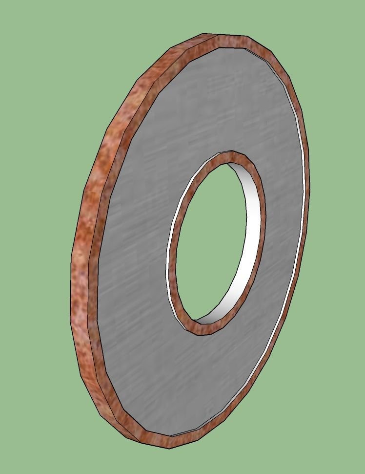

The brake pads chew on the brake disk during normal operation. Obviously the pads wear faster but nevertheless the disk wears too. Since the pads don't ride on the entire surface of the disk, two ridges get formed, one on the outer side and the other on the inner side of the disk. So it is not just rust. There are two ridges that need to be filed so the new pads seat well. See drawing below.
Ah OK I see now, so its where the rust is but more needs to come off to get them right.
