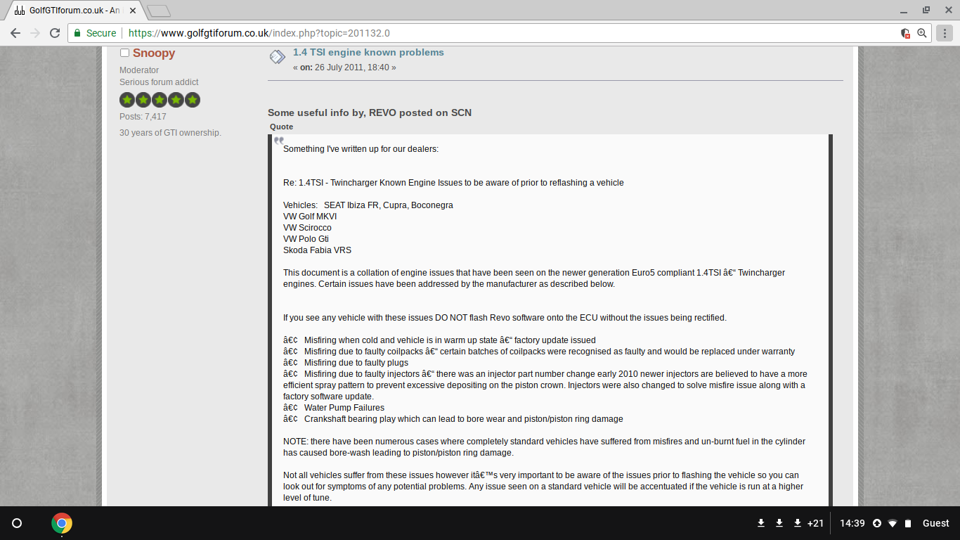

https://onlyrevo.com/blog/1-4-tsi-twincharger-known-engine-issues-to-be-aware-of
The Elephant in the room that VW Group just ignored with the 1.4 TSI / TFSI 132-136kW Twinchargers 2009-2014/15 is Borewash.
VW Group never admit to it, or that Long Life oils and Super unleaded petrols can be an issue,  just how much detergents does an engine require?
Funny how the Superunleaded even over 100 octane is not really an issue if you do not use the Oil VW Group Recommend.
Also funny how remaps were better than the Mapping / Engine Management that was & is OEM with the Twinchargers.
  Not REVO's though, they got theirs wrong. They were as bad as VW at owning up to that.
Over 25% of the CAVE engines had failures and like for like replacements failed as well.
VW Group changed mapping, breathers, oil spray jets and discontinued the engines after 3 years and still had issues and again played about with mapping.
All through this it cost many owners lots of money when they had no warranty cover and even those that VW Group sold extended warranties to then they claimed 'Known issues'.
There were known issues and the Management / Seniors / Engineers know who was to blame, it was them.
A CEO who was an Engineers Engineer.  As in Deaf Dumb & Blind to being the person signing the engines off.  Like with the Defeat Devices as well.
