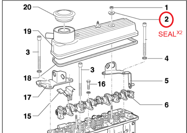

There are two rubber seals below the rocker cover nuts which could be leaking. The rocker cover gasket can also leak but I doubt the oil would end up on top of the cover.

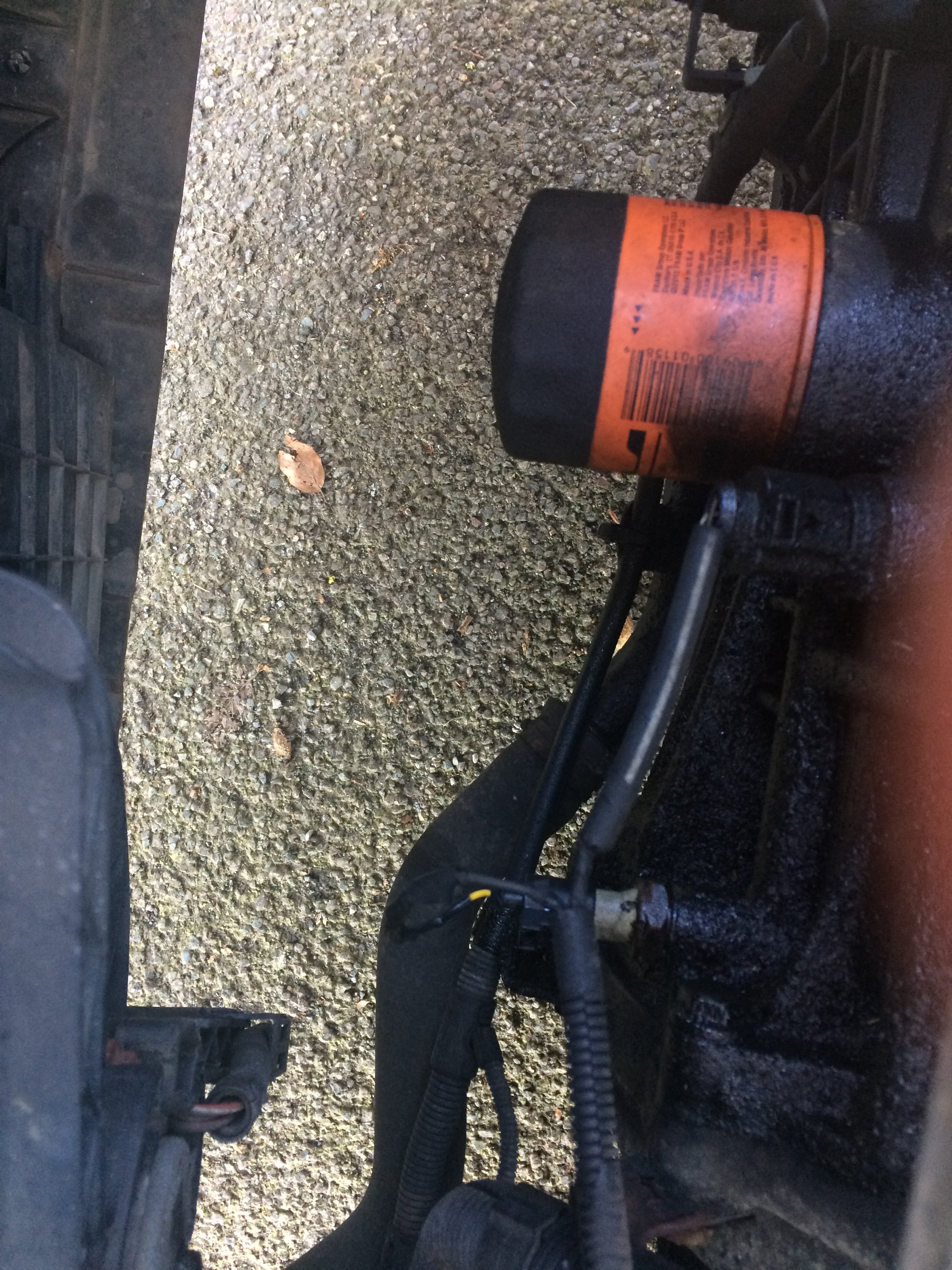

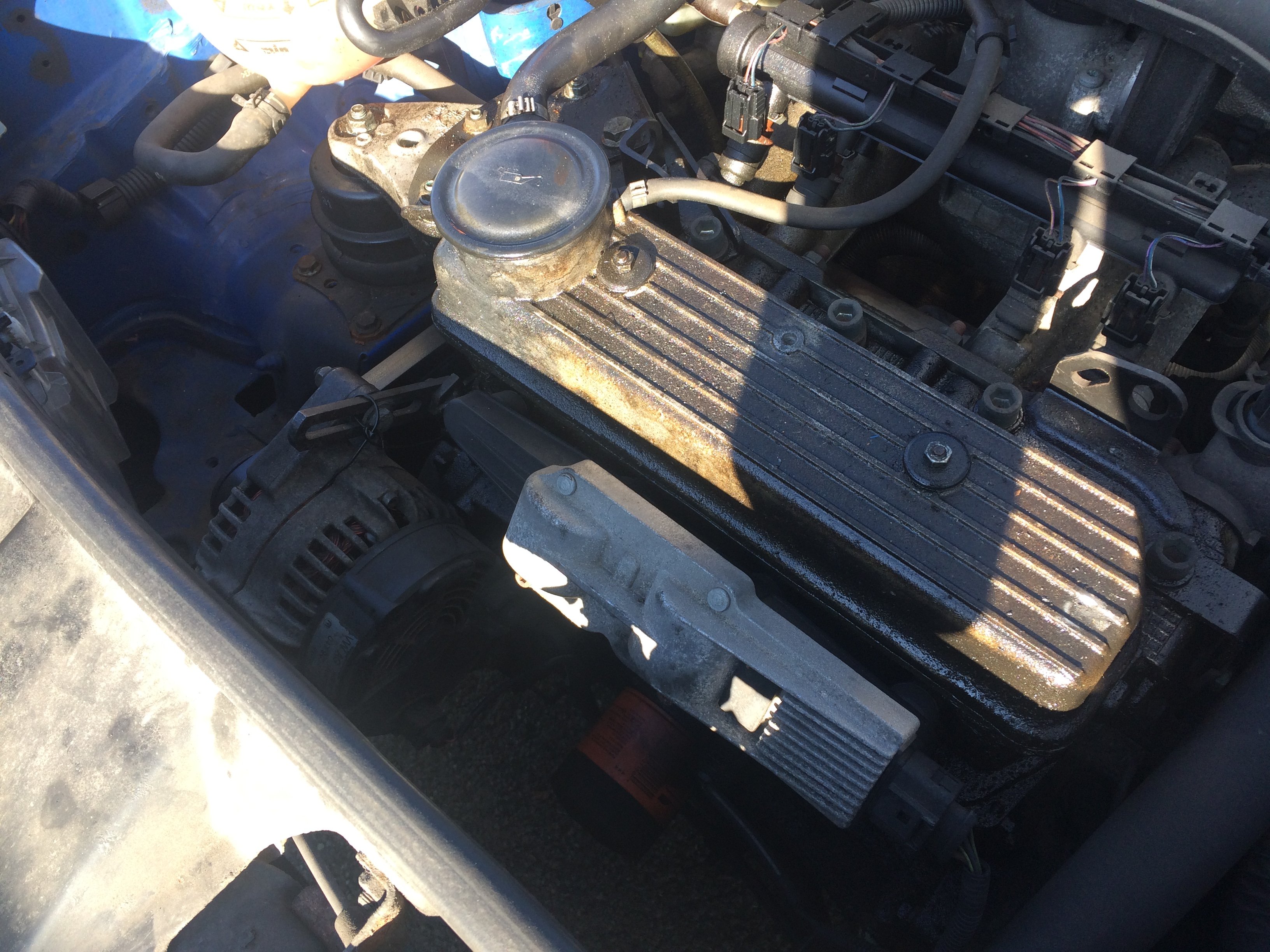

Added photos, they aren’t great due to the sunlight! The second one is just to show the random oil that’s around the rest of the engine. (Probably due to it spitting oil out for years!)
So couple of bits I’ve noticed - in the diagram above, there is a middle “bolt”. Mine appears to be missing, although the hole is “dry”, so the oil isn’t coming from here. Is it worth getting the missing bolt sorted?
i prodded the potentially faulty seal. It didn’t seem loose or squashy, but then that’s not a diagnosis!

The missing bolt doesn't matter. It was used to hold the engine cover. It's a blind hole so can't leak.
The rocker cover rubber seals don't look to be leaking. It might have been where the engine cover seals were leaking. Also, the rocker cover gasket might be leaking as they go hard after a while.
