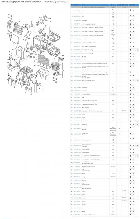

I'm looking for a parts diagram to see what lurks behind the dash area...maybe its a valve for the air con or something....engine revs effects it definately.

See illustration below.

The only motor item I can see in the partsex is the main fan - item 1 - part number for RHD 3C2820015F.  It's fitted to a wide range of Skodas so finding a replacement should be fairly easy.

Thanks for all the input :thumbup: thanks for Diagram Ricardo

There is a valve (11)...Im thinking maybe regassing renews the lubrication and helps valve etc???
