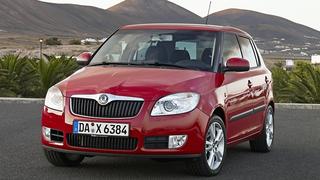

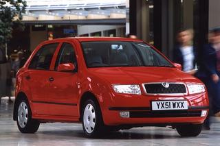

Surely you must know whether you have a Mk1 or Mk2 Fabia? They look entirely different....
Mk1
Mk2
But they're both red. :rofl:
