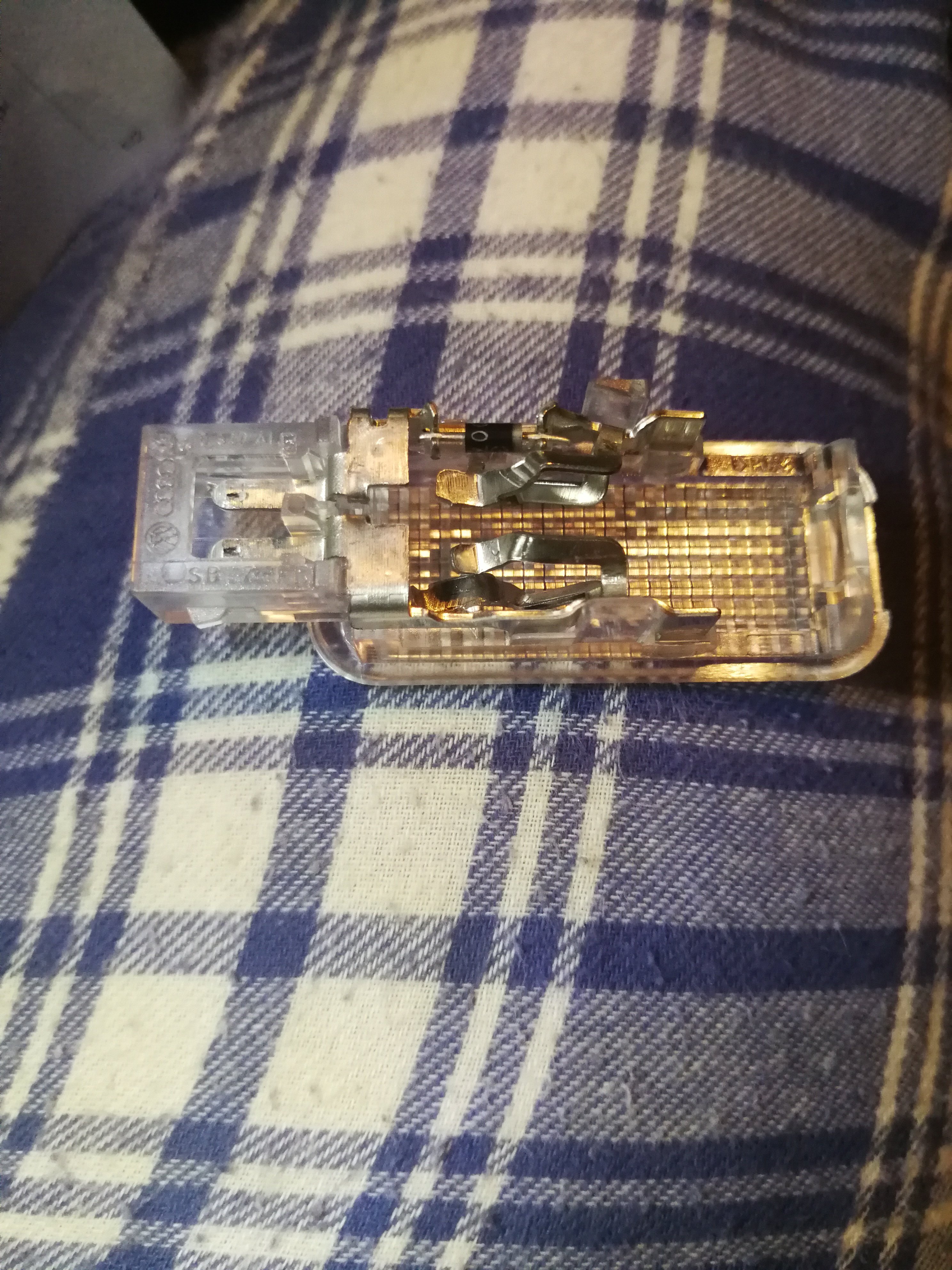

I got a new car Octavia 1.6tdi SE L 16plate. Unfortunately the glove box light is not working. i have taken the lamp out and saw a bulb there. i have replaced the bulb but still no luck..this is how the lamp look like. it looks bit different than what i can find on youtube. do you think my lamp is faulty or part is missing? please help me. thank you.

Yoh can check the light fitting you show in the photo above by swapping it with one of the boot lights if you think there is a problem, they are the exact same fitting.

I have already put a new bulb..but  it wasnt fitting properly..then had to push the metals down.
