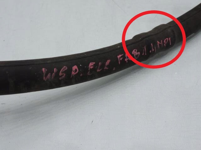

If it looks like there is a bulge in one of them it's meant to be like that. The pipe has a rubber sleeve over it and there is a metal ferrule under it that makes it look like it's bulging.
