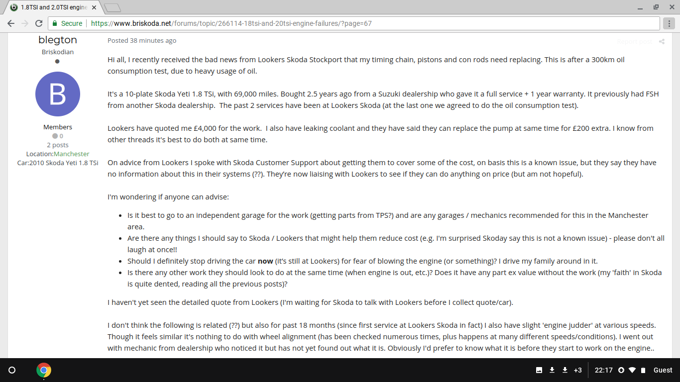

@Estate Man  As an example.   Just a one off obviously.
As to Skoda and known issues, here is one just tonight.   But then that is the bad old days.
