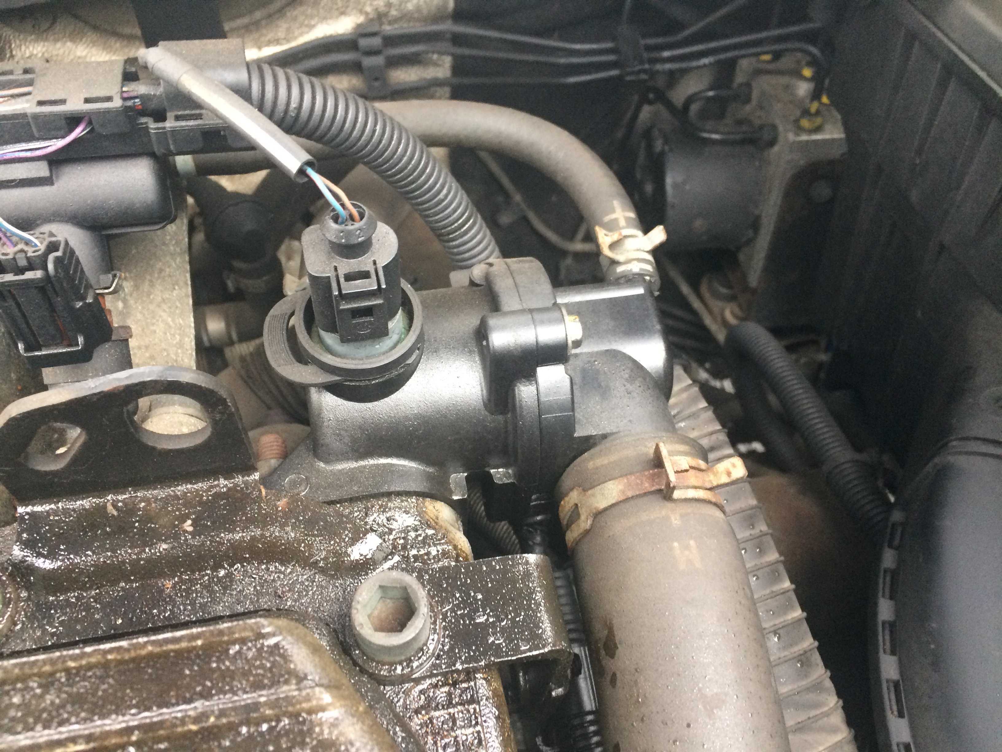

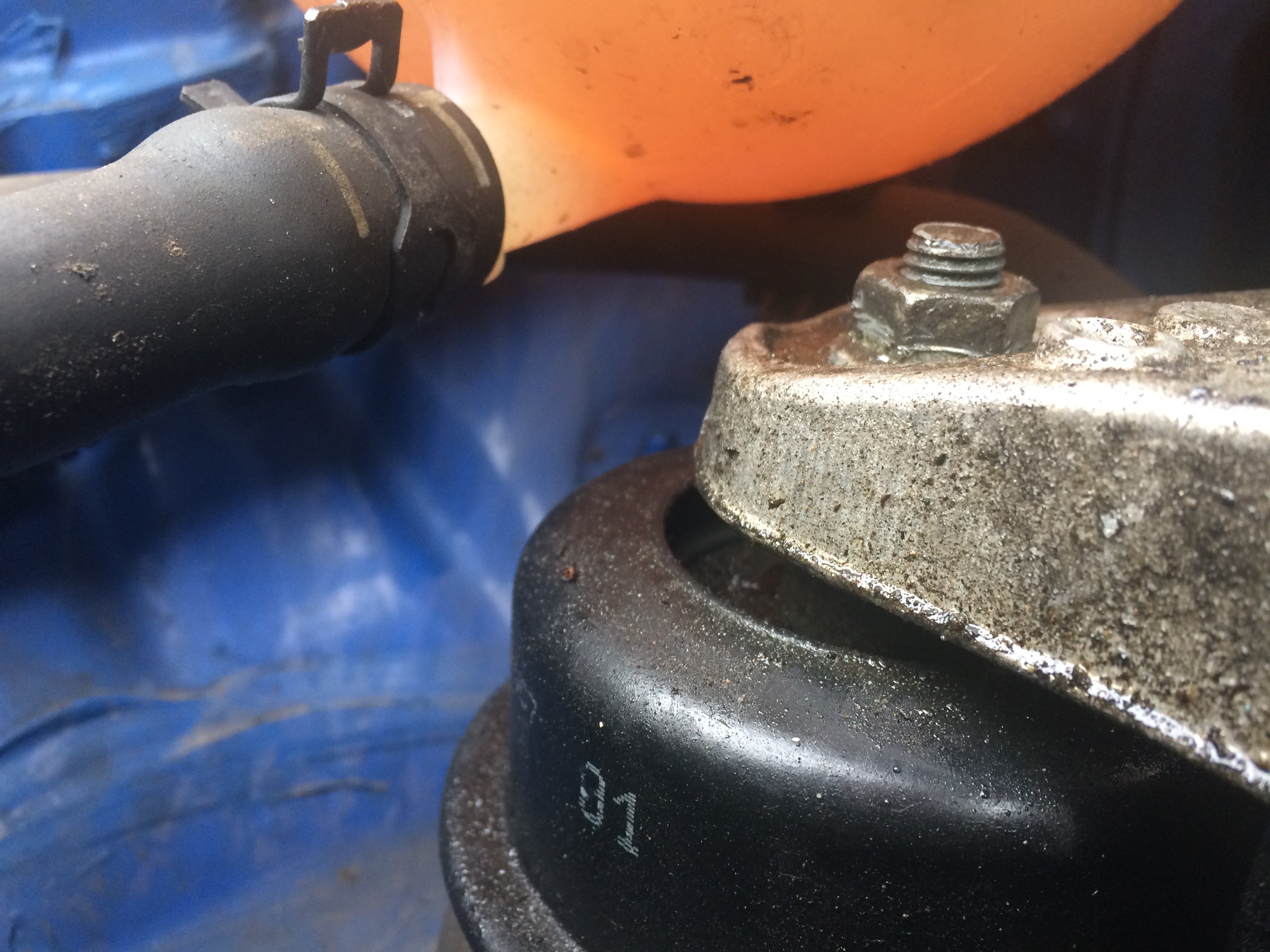

Photos of two possible “offending” coolant areas.
Dont look like there are any leaks immediately around the coolant bottle. Staining on plastic surround for switch isn’t easy to see

I can't honestly see evidence of coolant leak from your photo, but as you say, always easier to see 'in the flesh'.

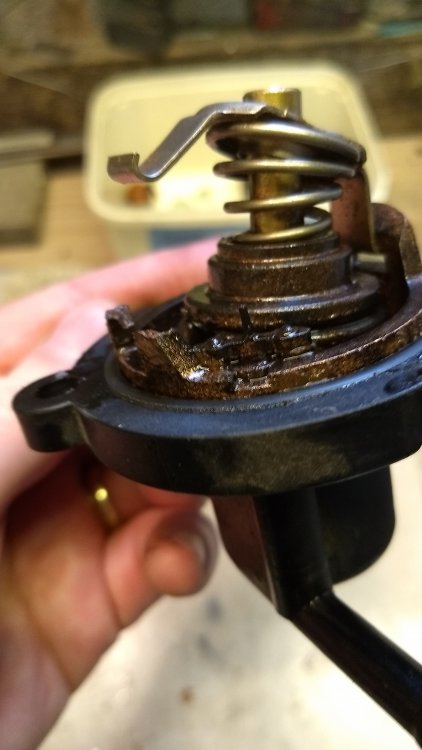

I'd advise replacing the whole thermostat housing which comes with sensor and thermostat already installed.
This is what eventually happens to older ones....

28 minutes ago, TMB said:
Is this the housing the sensor sits in?
Yeah, the grey bit sticking out is the sensor.

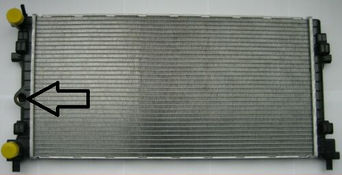

It goes in the hole marked on this image. This is the side of the radiator that faces the engine. The yellow plugs are where the coolant hoses attach.

Thanks very much
