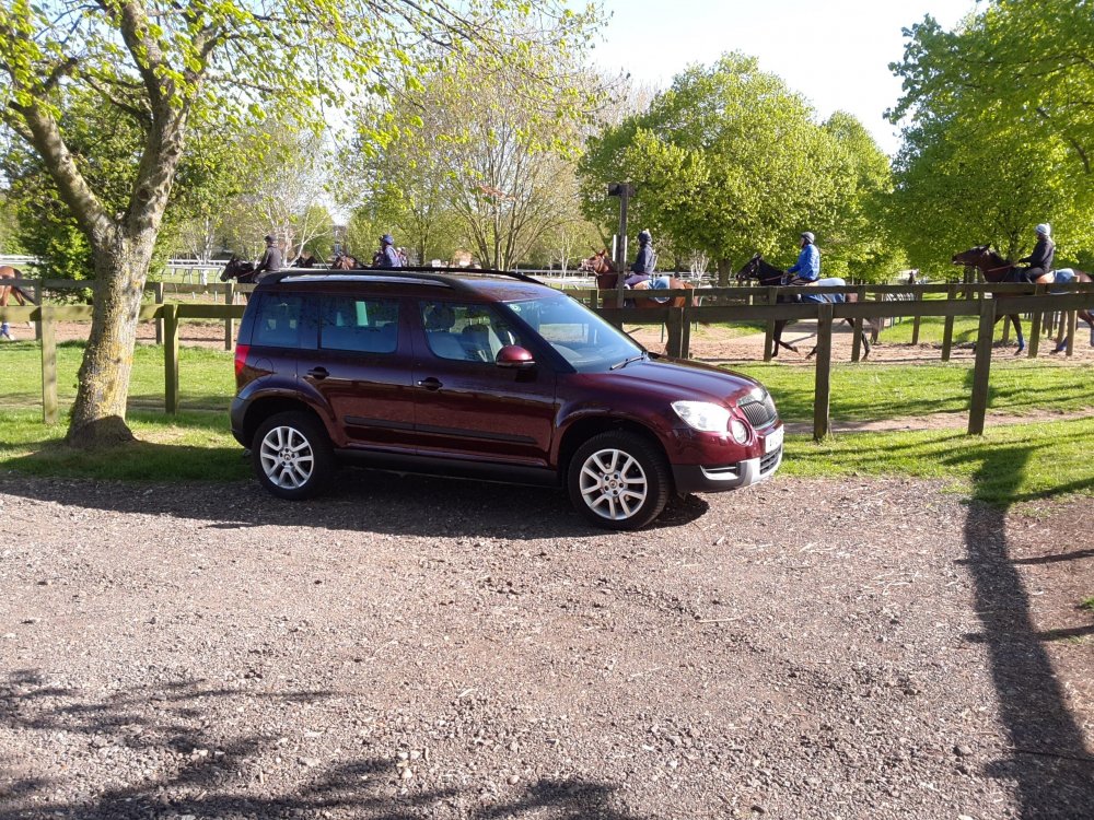

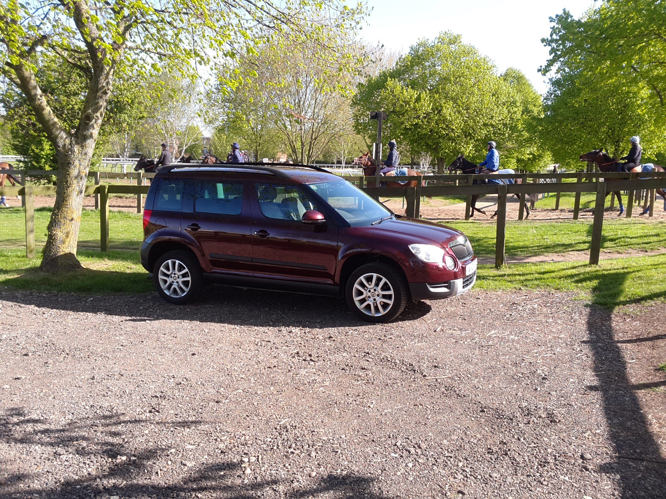

Fair point. Nice colour Yeti. What model and year would it be?
thanks.
It's a 1.2Tsi Elegance petrol 2013 in Rosso Brunello. Faults sorted as warranty coming to an end:- noisy final drive bearings & leaking front suspension struts.
Heated driver's seat repair- chargeable,  just after warranty expired. Only other fault was coil pack & no3 plug lead failure around 80,000 miles.
Currently 93,000 miles.
