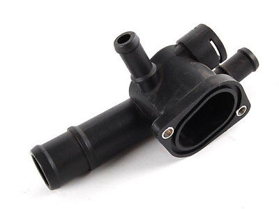

Yeah, I contacted the vw dealer and asked for a thermostat with the o ring and then I was offered a flange, but id not heard of that so said I needed the housing as they can sometimes crack when removing the thermostat. He had no idea what I was talking about and said there is only a flange which I understand is like a pipe union of sorts or so I've since read

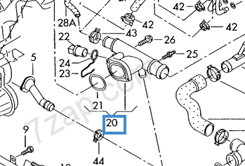

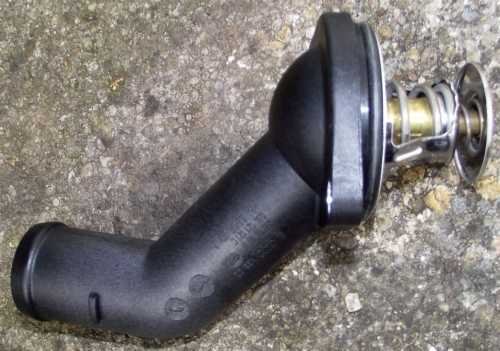

On my ASZ in the Bora the thermostat housing is actually part label 5 in your pic. Happen to have one in front of me as my engines running at 70C at the moment and bought a new stat which came with the flange and O ring. Wouldn't have thought BLT would be much different. Sits on the front of the engine close to the waterpump.
Edited by LB123
Oh right okay. So it looks like its part 5 I need then and perhaps Lee's part 20 is for the CTS?

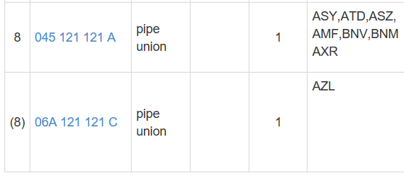

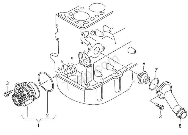

Parts are shown here, but unfortunately the "Use of" column for the first item 8, where I would expect to see BLT mentioned, doesn't mention it. I suspect just a listing error.
https://nemigaparts.com/cat_spares/etka/skoda/fab/453/121100/
Edit: Oh yeah, it's a Polo not a Fabia, back in a sec...
Yep, Lee's part doesn't contain the thermostat.

That part isn't listed as being for BLT as far as I can see.
EDIT: Just seen where wino said there must be a mistake in the listing.
Ah right, if it doesn't contain the thermostat it can't be the right thing. Sorry about that, Tom.

On all the petrol engines* the stat is up at the head; not really sure why the diesels have it down the front of the block, maybe just lack of space elsewhere.
*Except the AZL 2 litre Mustang crusher..
