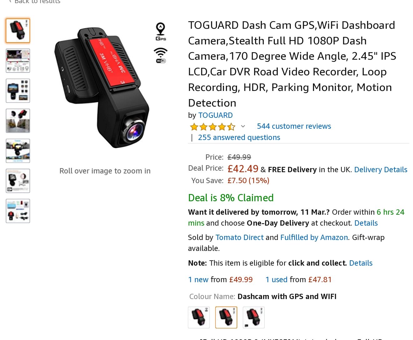

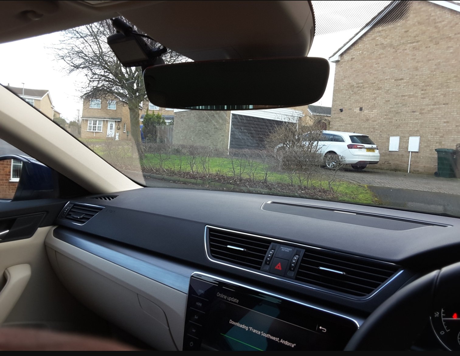

I have four of these Camera's in four cars.
VfrVrs, attempted the piggy back route today, no joy/ran out of daylight, looking at Youtibe vids, many use some kind of converter/inverter, is it possible to hardwire without one if these devices?
My install uses half a fuse as a spade terminal into one of the unused swiched live fuses.  Fourth car it has been installed in for either the dash cam or TomTom.
