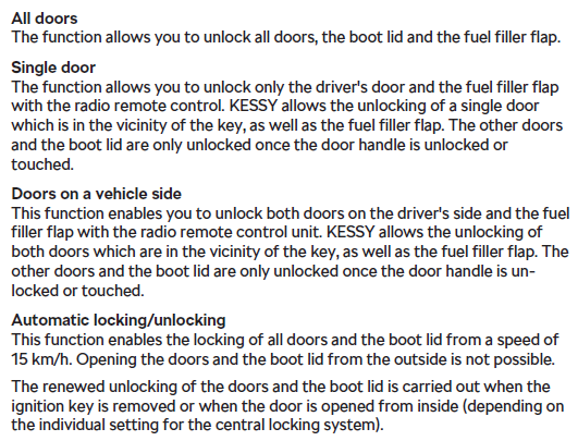

Grab the handle to open, (the sensor on the inside edge of the handle will open the door, this is why it is impossible to lock the door when you hold the handle normally... as you are trying to unlock it at the same time) the  if selective unlocking has been enabled (in the infotainment) then you would need to pull it twice to open the other doors.
If a passenger tries to open a door whilst you are stood next to the drivers door (without holding the handle) then their door will not unlock, the person with the key can only unlock the car.
