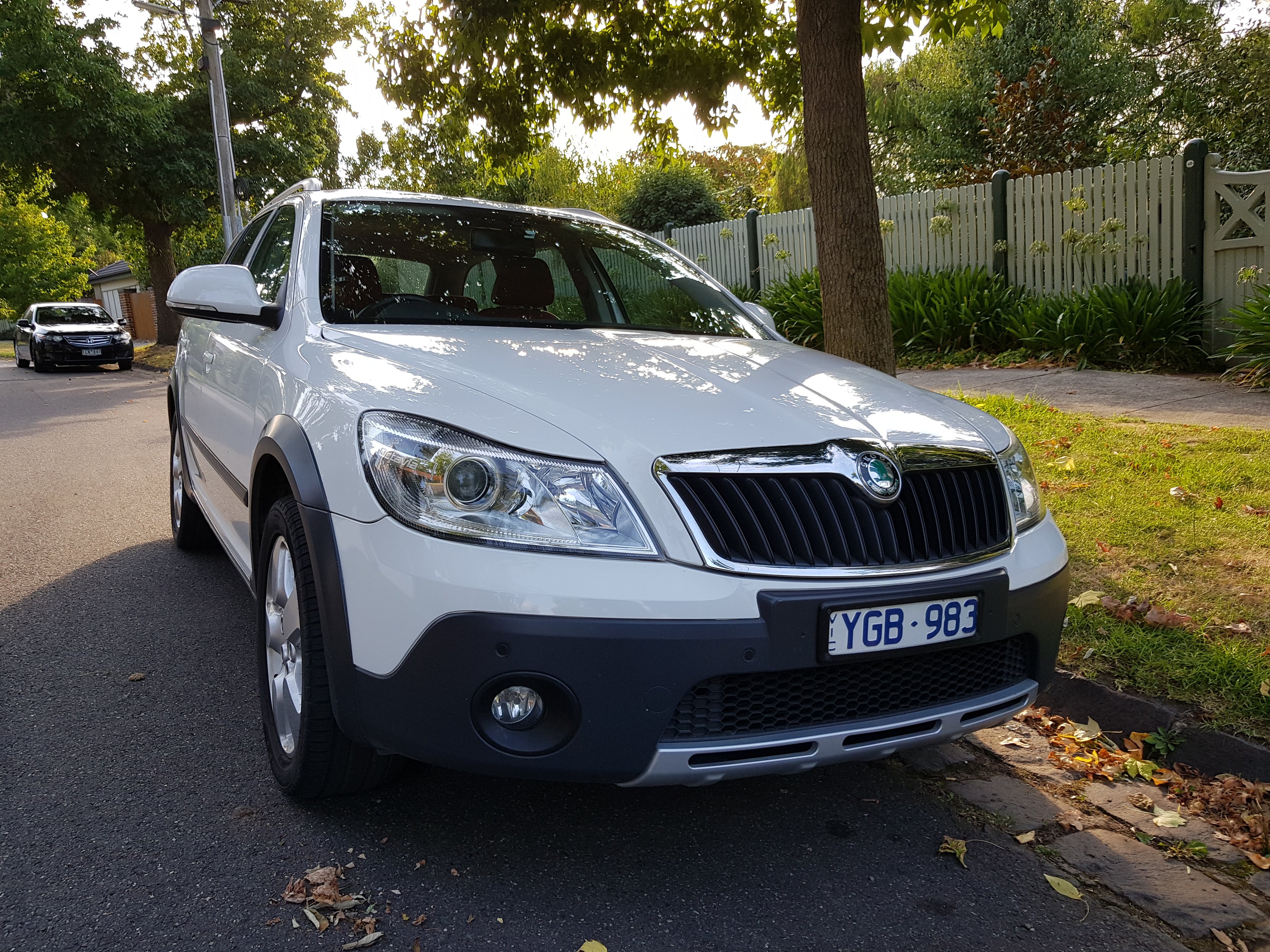

Just bought a used Octavia Scout 4x4 TDI
Howzit?
I picked up a used Scout yesterday and am pretty happy with it, given its age (2011) & mileage (139,000 km).

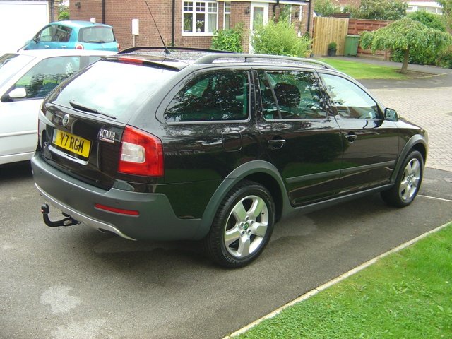

Any pictures?
Here's my old Scout, long gone now though...

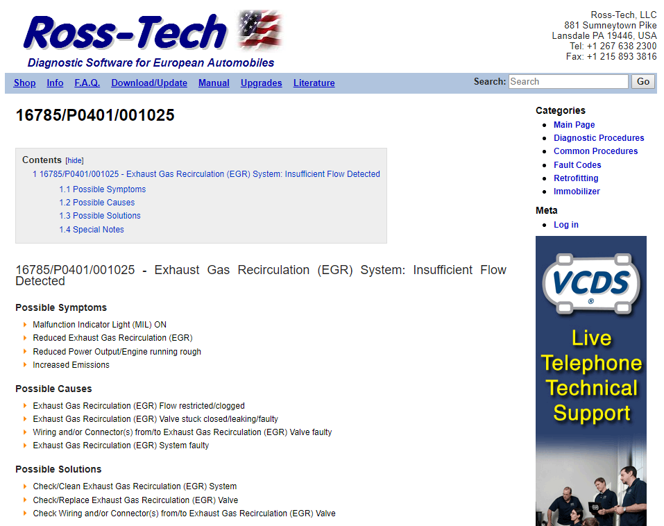

The errors reported by the ECU were:
  • P040100 Exhaust Gas Recirculation Flow Insufficient
  • P012100 Throttle / Pedal Position Sensor A Circuit Range / Performance
The bit of reading I did (here) suggested carbon build up as one possible cause. Note that it drove well over the last 1000kms. I couldn't notice anything wrong with it...
