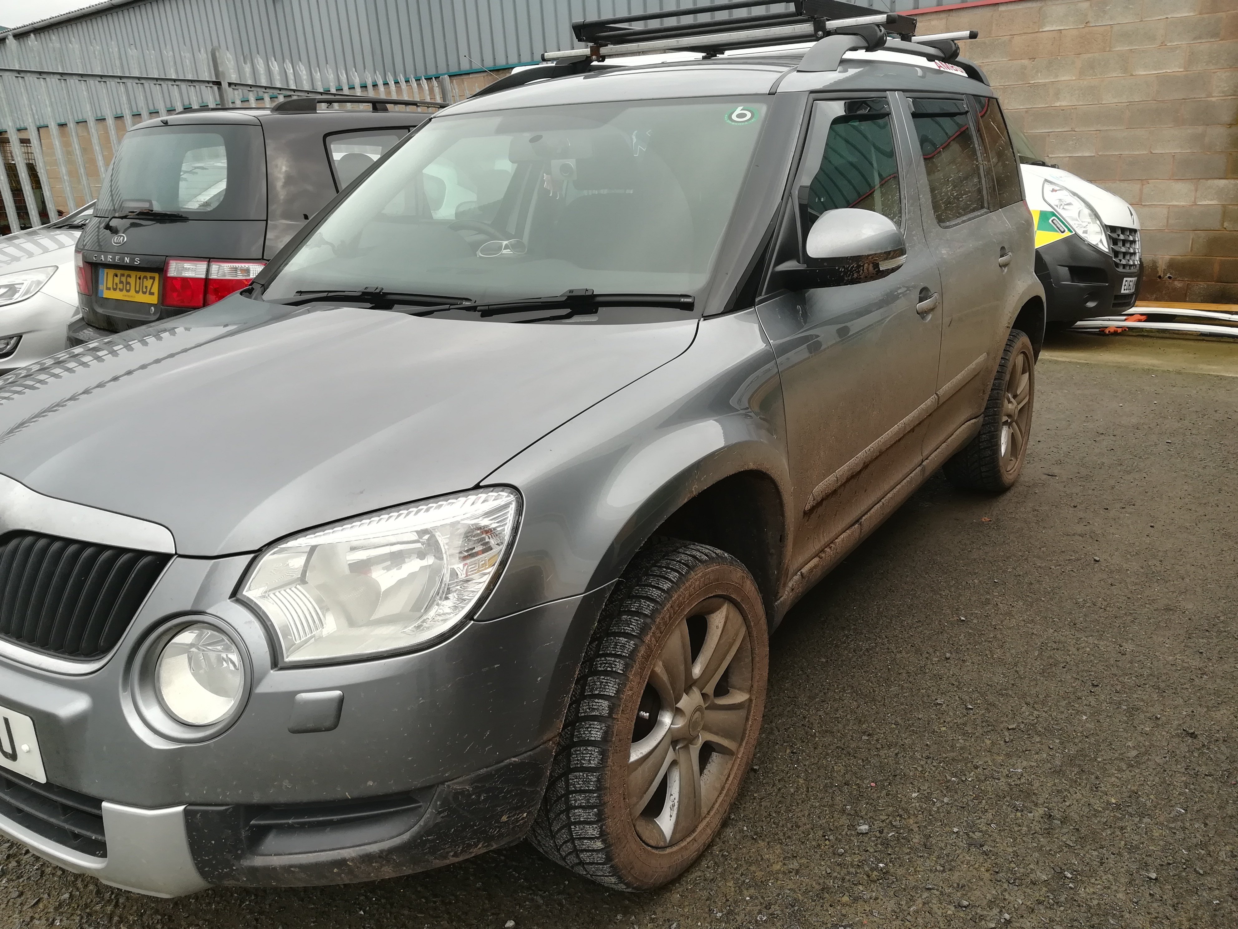

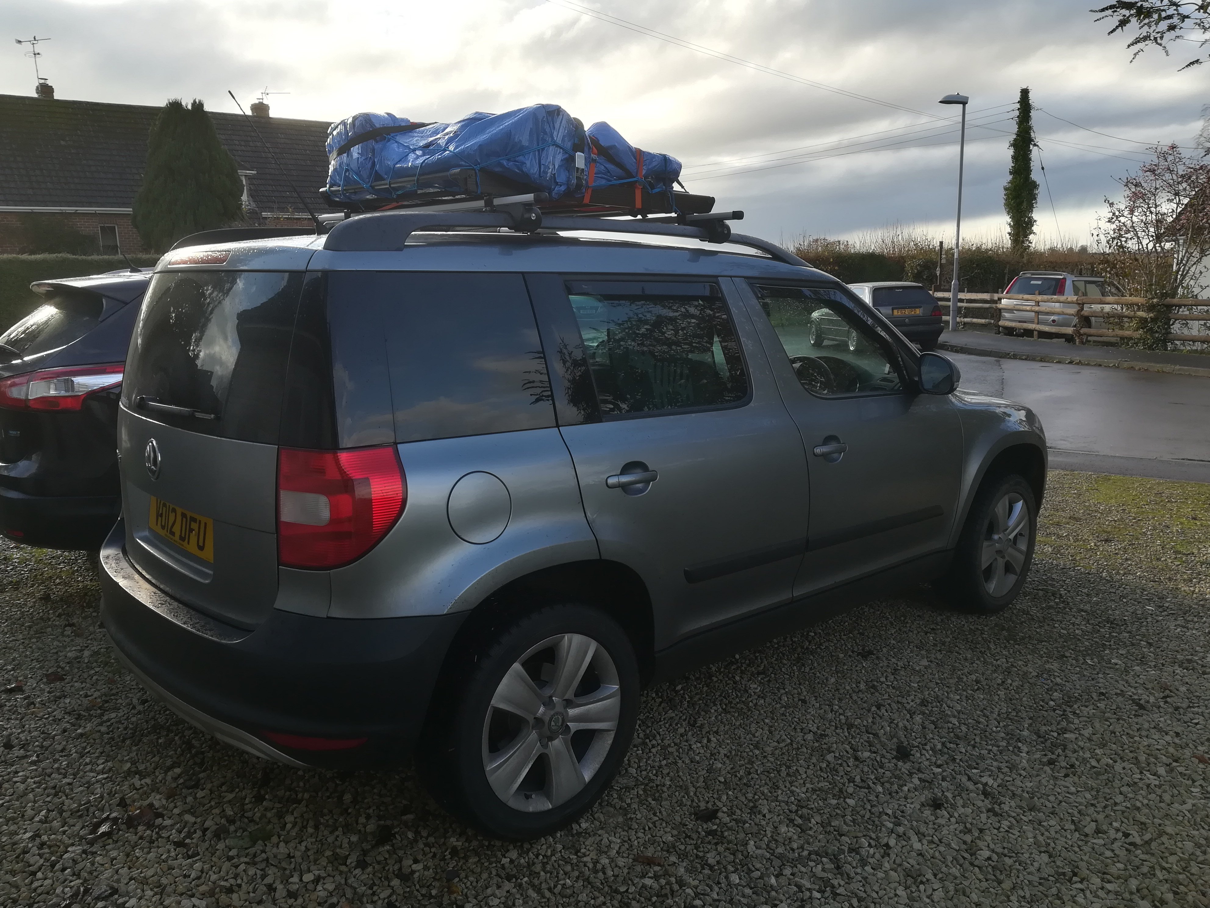

Not quite on topic -- sorry -- but I'm intrigued by WelshYeti's roofrack.  What is it and where did you get it?
It's an ancient Thule 581 I believe, I had it years ago on an old Beetle and just kept hold of it!

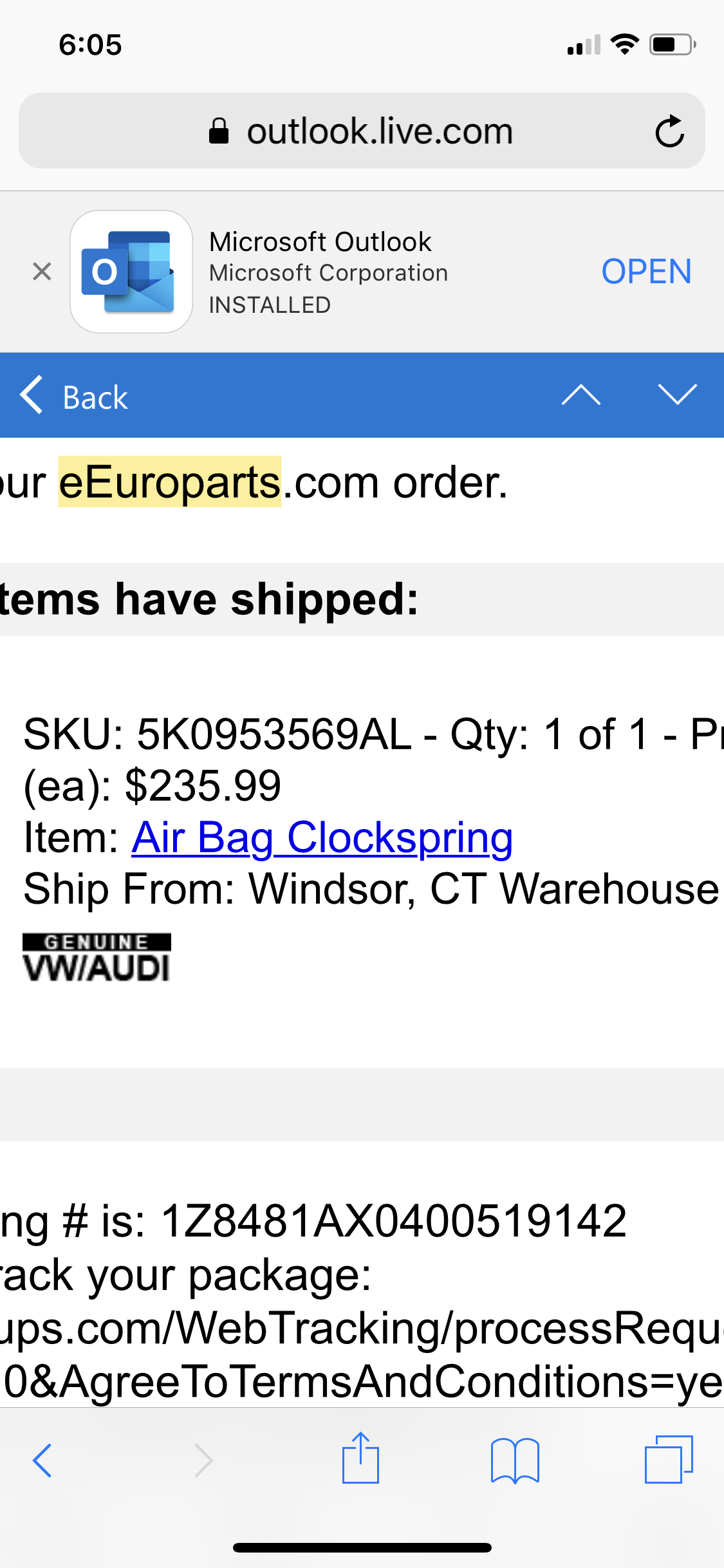

Hi. I have the same issue with my yeti, the clock spring is defective. Part number 5KO953569AL. You ordered one from overseas, can you tell what company you purchased this from and how much approx. You also  said you had problem with coding the new part but this was sorted? Would you recommend purchasing from overseas. Skoda here want about $800 for part but I may be able to get for $243 plus $25 shipping, thanks
Hi PPW I. would definitely purchase overseas again.  But definitely buy a genuine part if you are going to get Skoda to install it. They will not onstall an aftermarket unit. Skoda wanted to charge me over $800 plus fitting. The coding issue was sorted when I went back. My car was the last one done on the day and they did not run the scan tool over it, just gave it back to me. They had to do a software update to bring the car in line with the part. I will look up who I purchased from in the US.

Thanks Meyannos, i would appreciate if you could tell me the company you purchased from in US .
 The company I found is FCP Euro in Connecticut who can supply the genuine part for about $270 including postage to Australia. ( I just hope the price I have seen on the net is Aussie dollars), thanks
Hi PPW I bought through eEuroparts.com. The pricing I saw on line was all US. But cannot comment o what you have seen. A lot of places won’t sell to Australia. I have attached a photo of the order confirmation. They were prompt and easy to deal with.
