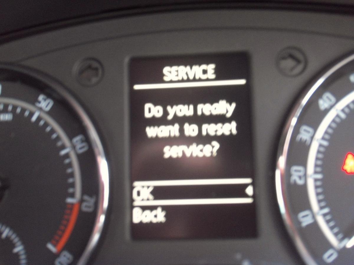

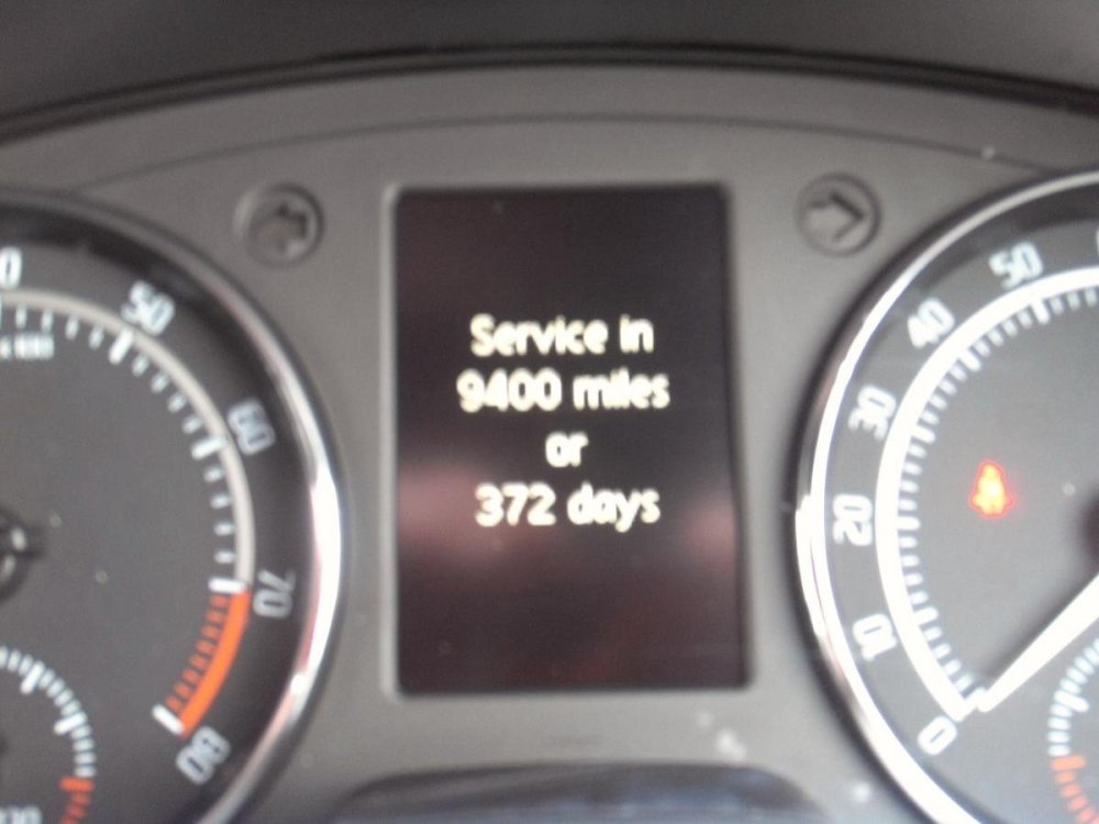

When I have reset either service or oil inspection it has reset to about a year or 10,000 miles.
If the car is set for Fixed Service Intervals and you reset the Service indicator it was to 372 days / 9,400 miles.
Now with newer cars that might be 365 days not the year and a week on fixed servicing.
Resetting those on Variable / flexible servicing is different.
post-86161-0-36120700-1445351597.jpg.f735efbfd01a5d6c1719116e80fbf319.jpg.d7a34e205df99f9ae89d599abf87cdb0.jpg
post-86161-0-63865800-1459249072.jpg.d73eb96fac75b35b16e085bd2bdd2e4f.jpg.03a9296d74aac0fdeb3fb5f88987bd99.jpg
