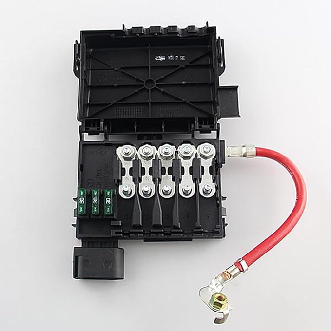

Check wiring. Also, check the fuses. In the past I've seen a car with strange issues like this, which was caused by a broken fuse.
There are multiple kinds of fuses, the one which caused the issue was a 'in line' fuse which was basicly a flat piece of metal (Don't know how they are called)
See for example this picture:
When I had a very close look, it appeared one of the fuses was broken. The fuse itself wasn't triggered by overcurrent, the metal just was broken. (Due to vibration I assume)
Since the breaking line was very thin, it did work, but randomly lost its connection.

Ok that picture is a in line fuse, the whole black plastic housing is called a inline fuse containing smaller fuses?
If so where do they be?
I thought the main fusebox next to the battery is where all the main fuses be.
On my O2 this is the front of the fusebox. When removing the top you'll see the regular fuses, this is the front side.
In this picture you can seem them (well, just a little) at the right bottom corner

Ok I just checked all the coloured fuses in the fuse box next to the battery and all fuses look ok.
Are the fuses in the interior of the car relevant to the issue?
Do you mean the wires coming up to the front of the fuse box that is next to the battery going into those silver nuts/bolts/washers?
If so I can see black fuses with numbers on them. How do I tell they are broken?
I took a photo of the front of the fusebox:
The wires look fine and I don't see any burnt marks on the silver contacts/nuts/bots.
