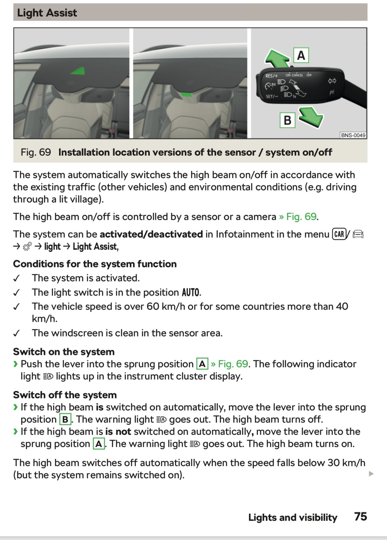

Yes, just for this.
But you can also try to adjust the sensitivity of th assist.
From the manual....

Anyway, the easiest way to switch off the auto high beam is to turn off the headlight switch from Auto position.

Country roads as in slow, narrow, bendy ones? If so, you're a bit stuck I'm afraid. The high-beams won't automatically activate until 60kph (38mph), and there's no way to change this through any menu option. However, according to the manual, the speed is 40kph in some countries, which means it is probably software controlled and thus altered via VCDS or similar (this is just a thought, I have no idea if it is possible or not!).
