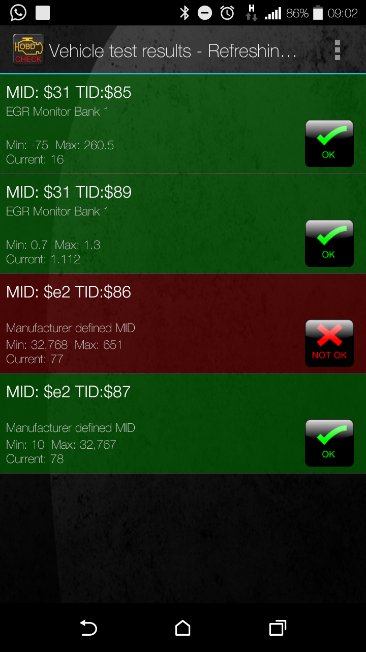

Anybody know how to interpret what the hell is wrong?
I ran a torque pro test  scan on the insignia as something just felt off in how it was running on way to work earlier.
No fault codes code under the tests i got the below..
Anybody know what that translates to so i can figure out whats actually wrong?
Its a 2litre cdti a20dth engine.

32_768 >> 651 to start with!

not entirely sure the test failures in my op were directly related to what is actually going on (in a more serious capacity than a maybe bad sensor), i think it was just my paranoia kicked in early enough that something felt off... highly likely if id kept driving it today I might be sitting on the side of the M8 somewhere around Fermoy now contemplating the most efficient way to set fire to the car in a rage..
