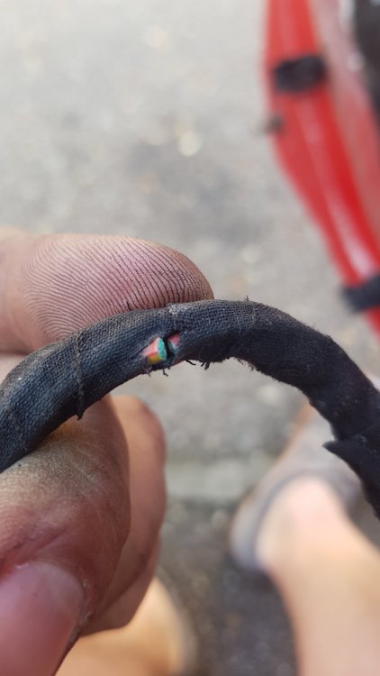

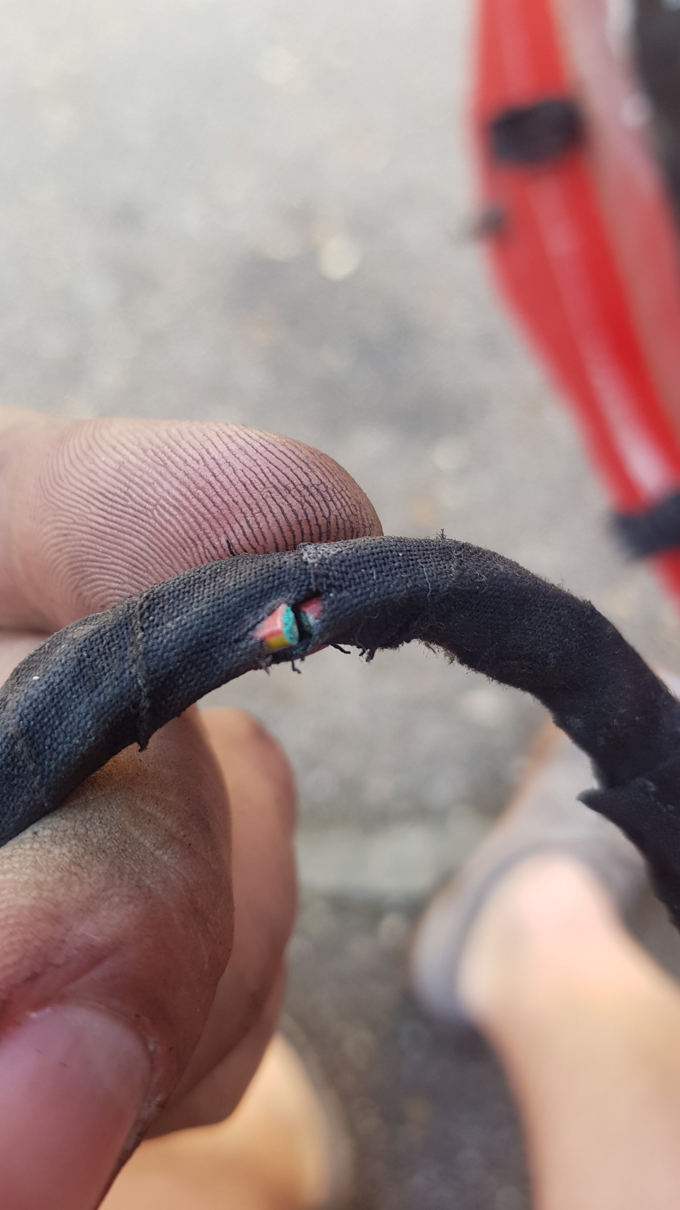

I think the problem may lay between the door shut connection and the back of the white multi plug - there's some wires where I'm not getting continuity.
Quick update, managed to find a single wire snapped, resoldered and all working. Looks like I have a spare working door lock mechanism, just incase. This was from the door plug (b pillar) to the back of window motor.
