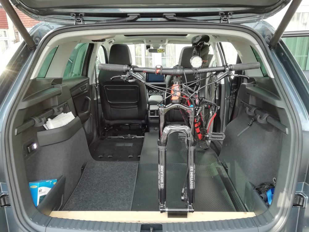

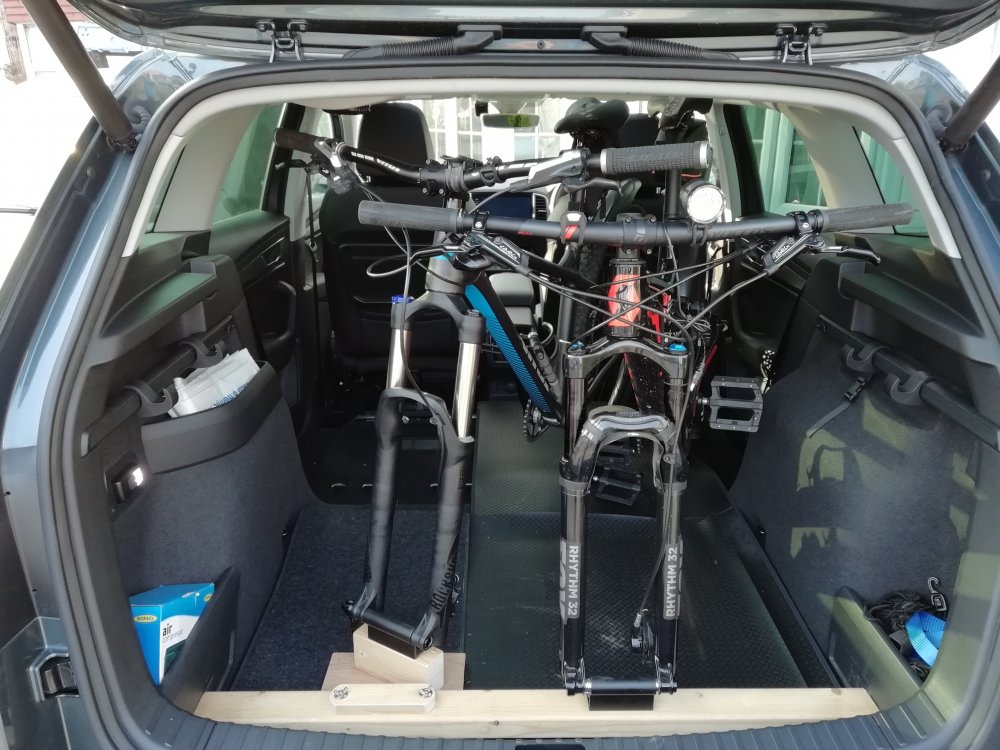

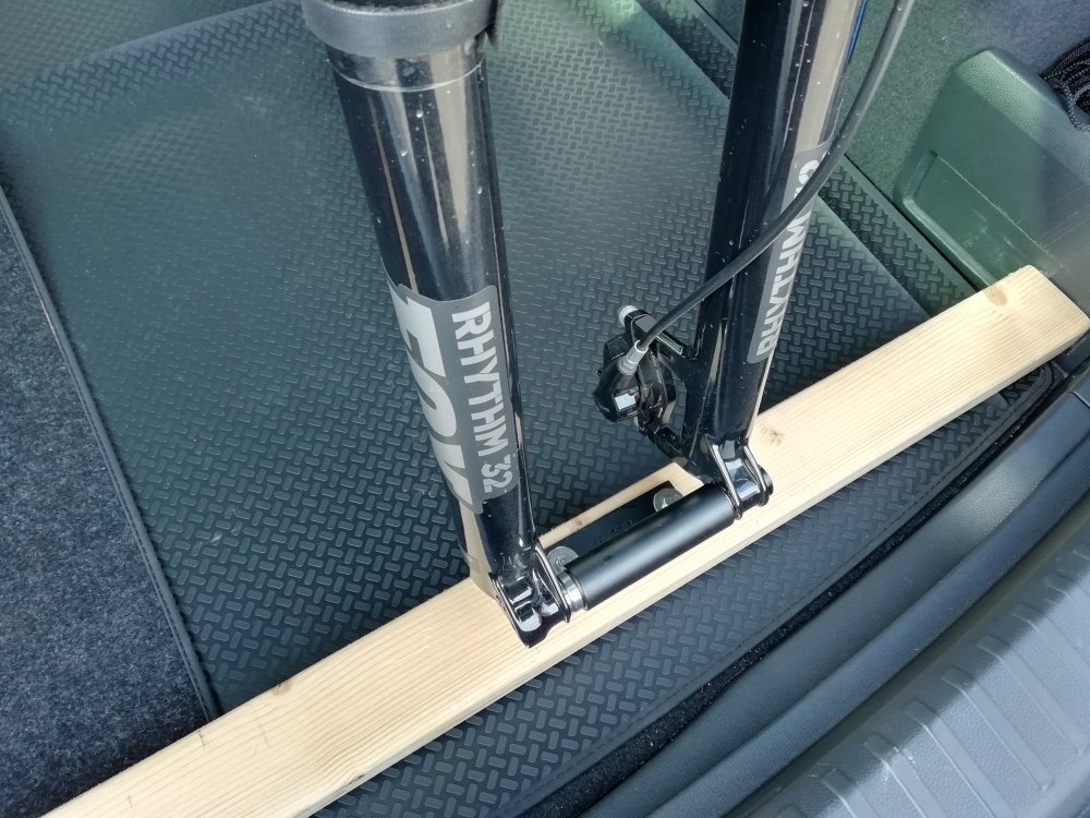

I made my own with a fork mount on a bit of wood, works perfectly. Today I added a second mount so I can take 2 bikes now.
It's the first time I've taken all the back seats out, it's massive inside.
You can leave one seat in and 2 bikes still fit.
