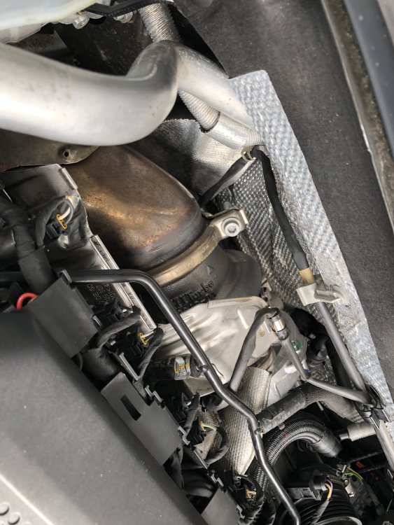

Doing a bit of googling and I reckon it’s the same issue the golf r and Audi s3 cars have in that it’s a turbo issue. There seems to be a service bulletin for vw that involves replacing the turbo and doing something to the air intake, I doubt if Skoda have this so I may just have to live with it.

Sound has got worse, so I took it to the dealers and they were able to verify the sound. They’ve had it for a day and said it’s the turbo actuator. The warranty ran out yesterday but they booked the job card in on Friday when I was there so should all be covered by Skoda. They’ve kept it overnight as the ran out of time.

Well Skoda are going to replace the turbo. No idea how long it takes them to get the parts in though so it will be off the road for a while now.

Skoda have replaced the turbo under warranty and the sound has gone, hopefully it doesn’t come back.
Just hoping ping they put it all back together properly!
