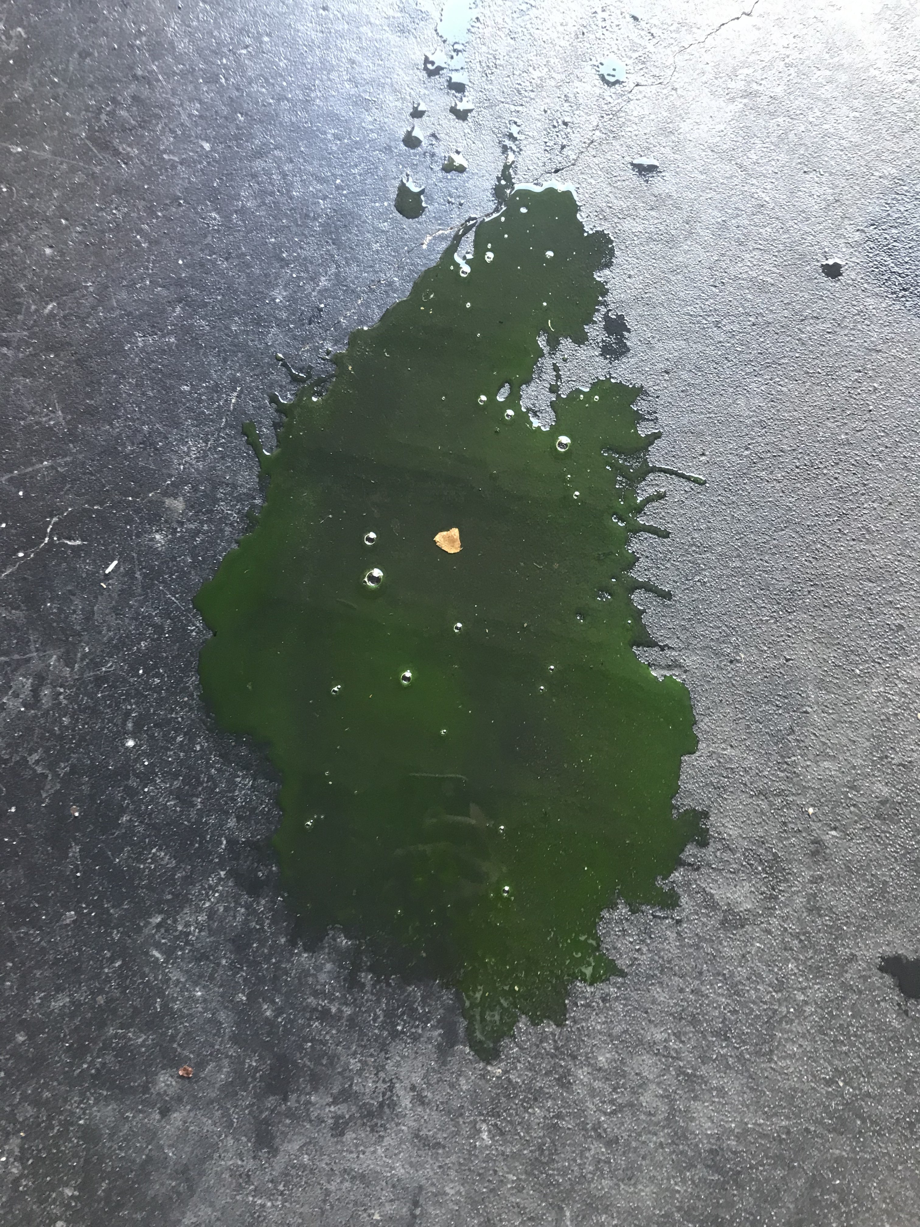

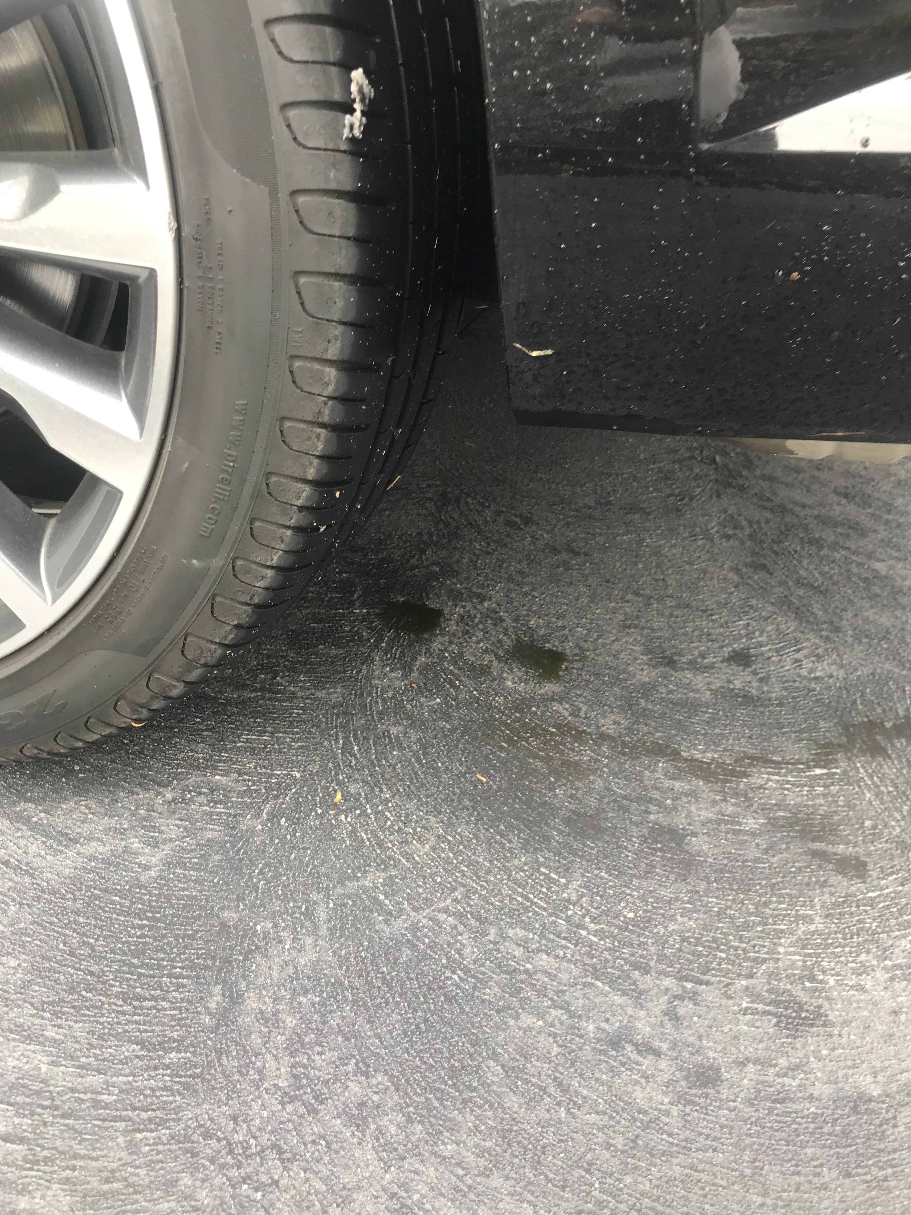

I ignored initially it but seems to happen more often now. When it rains or after a car wash this watery green liquid trickle from the rear wheel arches. Any ideas what it could be?

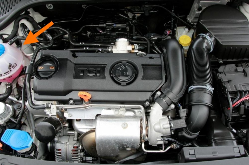

That looks like coolant. But yours should be pink no? Is the coolant in your system green?
coolant.jpg'
It looks a lot like the green fluorescent dye used in a lot of automotive products anyhow.
What color is your brake fluid? Could be that?

Better you have to let your car dry up and then to lift it up or to go under it somehow in order to inspect very carefully what it is. From the first look it seems like coolant but this is at the front section of the car and not at the rear....As #digfish mentioned mentioned this could be brake fluid....Definetly you have to inspect underneath the car with a torch .....

Hi, You don't have any fluids in your car that are this colour as it left the factory . From the looks of the wheel and paint your car is pretty new so you're unlikely to have swapped the pink coolant out. Aircon just drips water and it's not oil. It isn't brake fluid . As a left field suggestion, check in the spare wheel well and see if there's a split bottle of screenwasher fluid in there. Also consider that there could be a leak in the rear screen jet feed pipe- if there is then the water has to get out somehow and it will take the path of least resistance.
What does it smell like?
Don't taste it, you might have a seriously ill dog in the neighbour hood..........:biggrin:
Can of tyre gunk leaking in the boot floor area?

Did you say it only happens when it rains to it could well be a blocked drain or back of the arch liner full of moss and tree  crap and the water collects around it then drains out catching bits of it causing it to be that colour

 That’s correct only happens when it’s wet. I noticed it more after I wash car. It’s very odd.

So does it feel watery or oily? What does it smell like? Does it evaporate, or remain?

Sorry, they jacked the car up checked everything. Washed the car and nothing came out. The mechanics said none of the car fluids are green coloured so this is very odd.
Told me to monitor closely so they can pinpoint the exact source inside the wheel arch.
