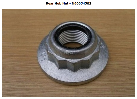

The genuine nuts don't look particularly like locking nuts, especially after years on a car. If you zoom in on the picture in the first result of the ebay link I posted you can just about see the ovality at the end of the nut.
Spring washers and nylocs don't really work very well at preventing loss of preload, they'll just stop the nut falling off completely after preload has been lost. If new nut and bolt are correctly preloaded with torque then angle, that situation won't occur.
I believe the nuts are serrated flange type. The serrations grip and stop them coming undone. You can always use loctite if you want belt and braces.
