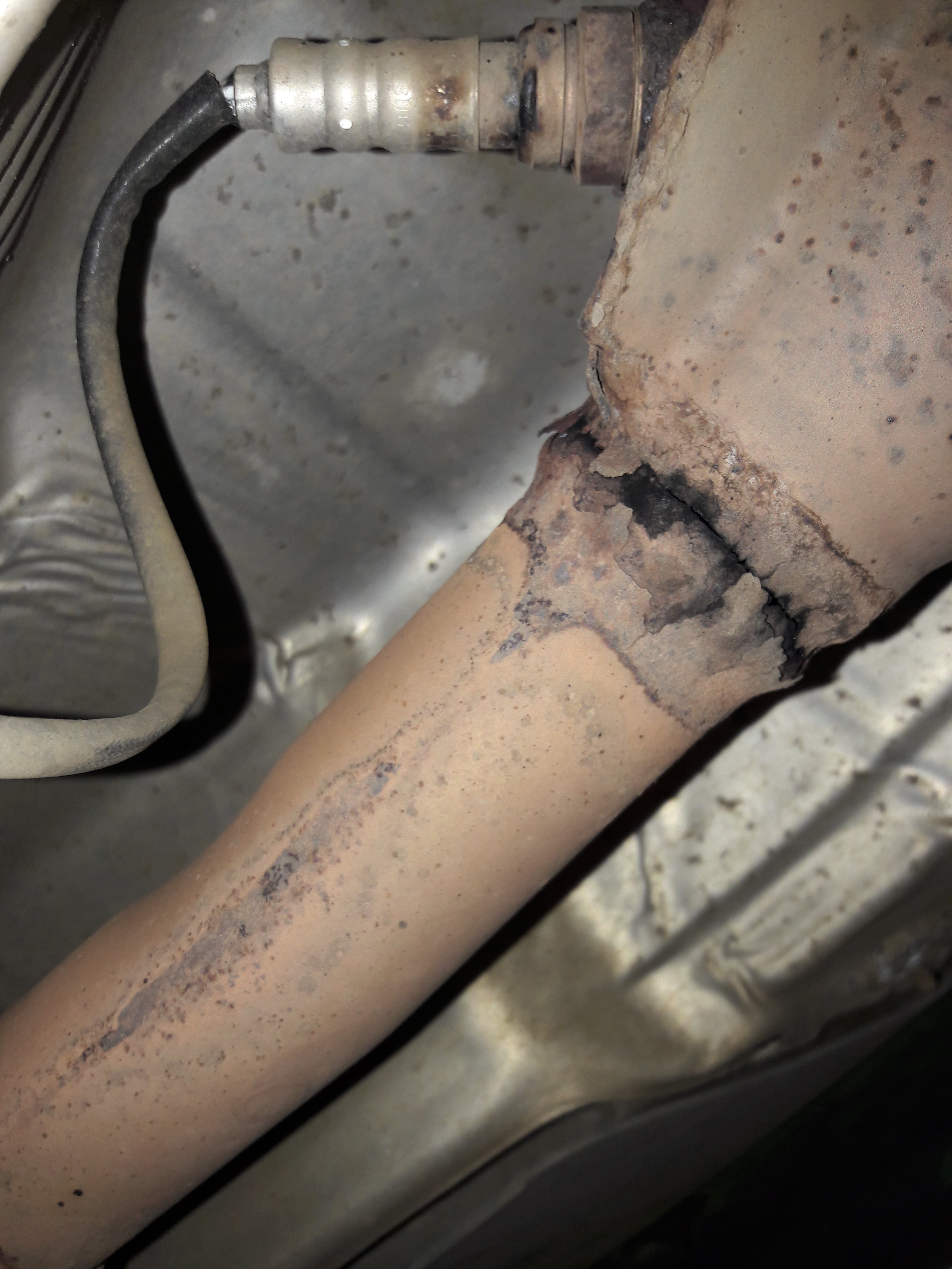

I'm really not keen on them. Their parts lookup by Reg number is shocking, and some of their bargain priced stuff is just junk. Yesterday I found that a 'bargain' main cat pipe ('React'' brand) I'd bought and fitted just 20 months ago was now in this condition :
ECP own-brand and off-brand stuff is absolutely craptastic, stick to the few quality items they sell and you'll be ok.
