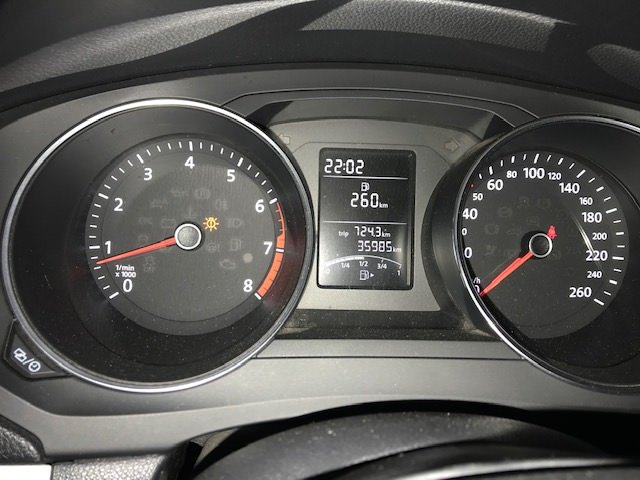

Possible to turn off bulb error light vcds?
Guys quick question is it possible to turn off bulb error light using vcds lite?Thanks all
That doesn't look like a MK2 Superb dashboard. Have you posted in the right section?
As for the light warning error, you might want to add what you've done to cause it?
hi mate no its not a superb mk 2,i just got a pick to show the light.it the fog light that is causing it broken wire somewhere,cant find it
Fix the problem and it will turn off. Simples!
Assuming it's one of the front fogs that's causing the issue, then VCDS cannot disable the bulb warning. You'd need something like VCP or ODIS-e.
However, you might be able to code out the front fog lights completely. That could remove the warning although you'd probably get an implausible signal error if you put the light switch in the front fog position.
If it's the rear fog light then clear a Saturday morning and get to work fixing the broken wire/s...
