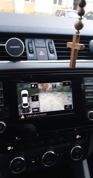

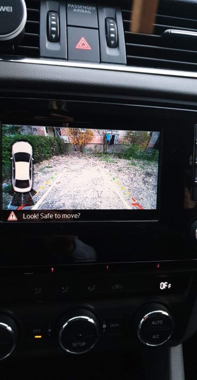

Two months ago i installed a rear view camera on my octavia III  ..everthing was ok..but the problem is the black display on the little white car?i can't see very good due to this black font!!!
I will attach pictures to understand the problem(I pic. is mine)
I saw a lot videos on youtube with instlled cameras and all with incolor font...
I tried to find from coding in VCDS..in menu navigation..but nothing...to be from old version of firmwre navi???
If someone have an ideea or the solution i will thank him forever!!
It’s definitely a firmware thing, you need to update the radio to a newer firmware. There was a thread on it, but it doesn’t appear to have anyone on it with a current link. It’ll be around somewhere though.
Thnks a lot..i have the same idea!i will wait to find someone to give me the update!!!
Yeah the firmware needs updating.
Quote from Trust2k below on this issue:
"The difference you see in the image at the old software version of the rear base of the park distance control is black and transparent with the new software version to also see the complete range of the camera .
The navigation system Amundsen (SW <435) and the Radio Bolero (SW <0435), does not work due to software by hiding the parking aid correctly. While the right settings panel hides itself autonomously, the left side is not hidden on the monitor."

Today i resolved the problem!!! The problem of black view was from old firmware version..i updated the system firmware at 0490 version and now everthing it's ok!!!
Thanks a lot again to Aki78 who was a great person and helped me!!!

Hi, I have a very similar issue.
I just installed the reversing camera from aliexpress: https://www.aliexpress.com/item/4000230897829.html?spm=a2g0s.12269583.0.0.291d299fXIJHwU
However, whenever I select reverse gear I get the image displayed in your second picture and the box on the left with various buttons never disappears! I was hoping I would get a display the same as your first picture but the buttons block some of the image :sadsmile:
Is this also likely to be a firmware issue or do I need the long coding via odbEleven?
The camera I have used is meant to be a plug and play, but I find it frustrating that the menu items never disappear once I am in reverse gear.
Any help would be very much appreciated!

Looks like I managed to fix the issue by playing around with the picture settings, i.e. brightness, contrast etc, (perhaps initial setup registration) then went for a drive and now the menu doesn't stay up permanently.
The other thing I did was clean my amundsen head unit as described in other threads as I had been having issues where it wouldn't register my touch or it would think I was touching the screen when I wasn't/
