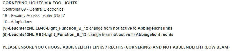

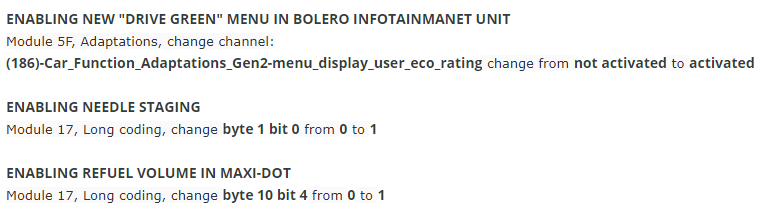

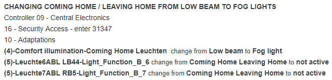

Have a look at some of these;
Your car may have the DriveGreen menu already, press the "Car" button on the radio, and the left selection button on the touchscreen should bring up "status, drivegreen, etc", if not, then you can enable it. Gives you an eco score rating.
The Refuel Volume is kinda cool, though it seems to be based on needle position, i can fit about 10L-15L more after the needle hits "Full", though it's useful as a rough estimate of at least how much you will spend to make it go to full mark (though you can put more in after that point).
Needle staging is what i have, though as i like to preserve my fog lights (a family members Yeti had soo many foglight bulbs fail), i didn't bother with the cornering lights. though it is there as an option.

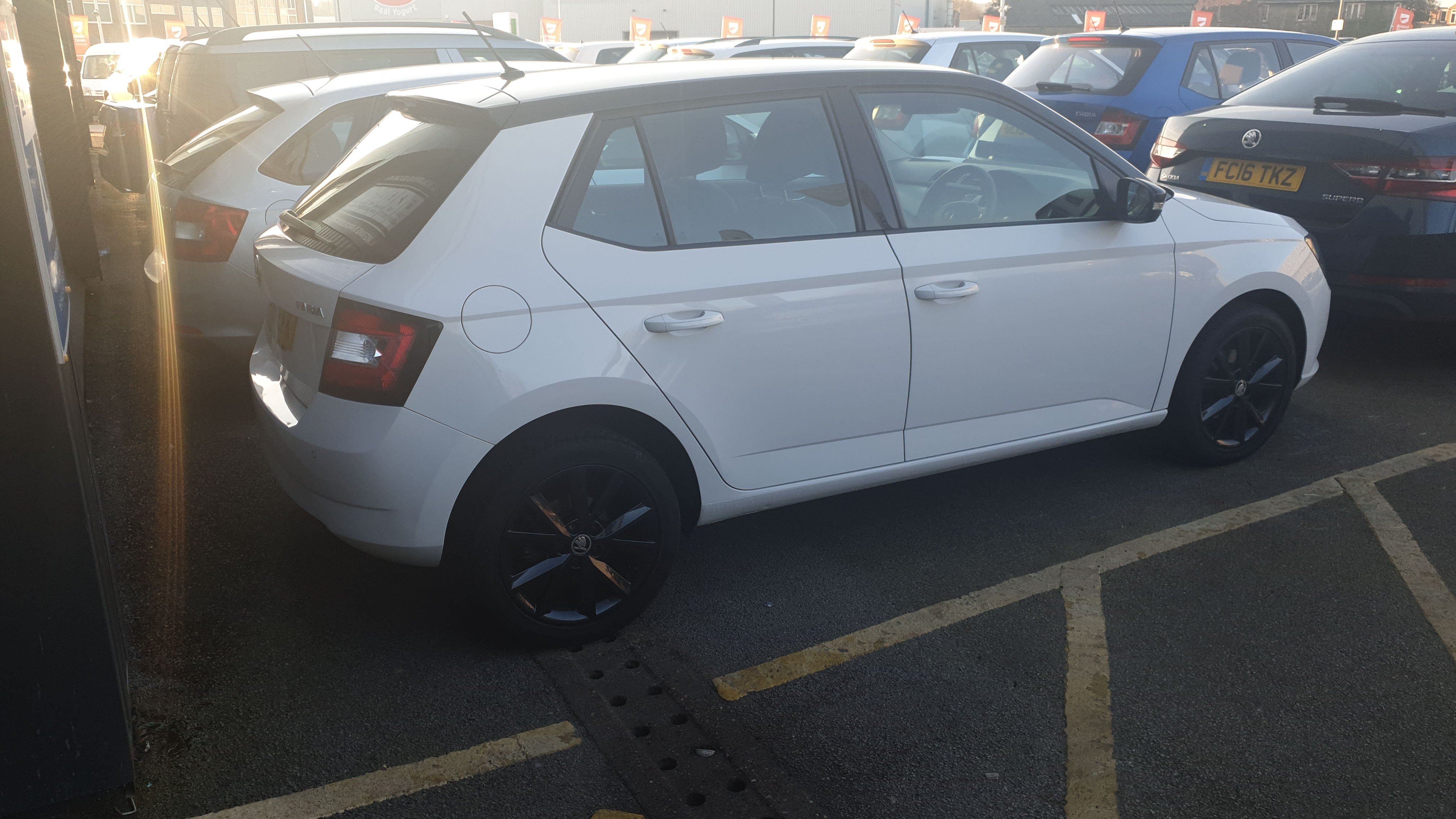

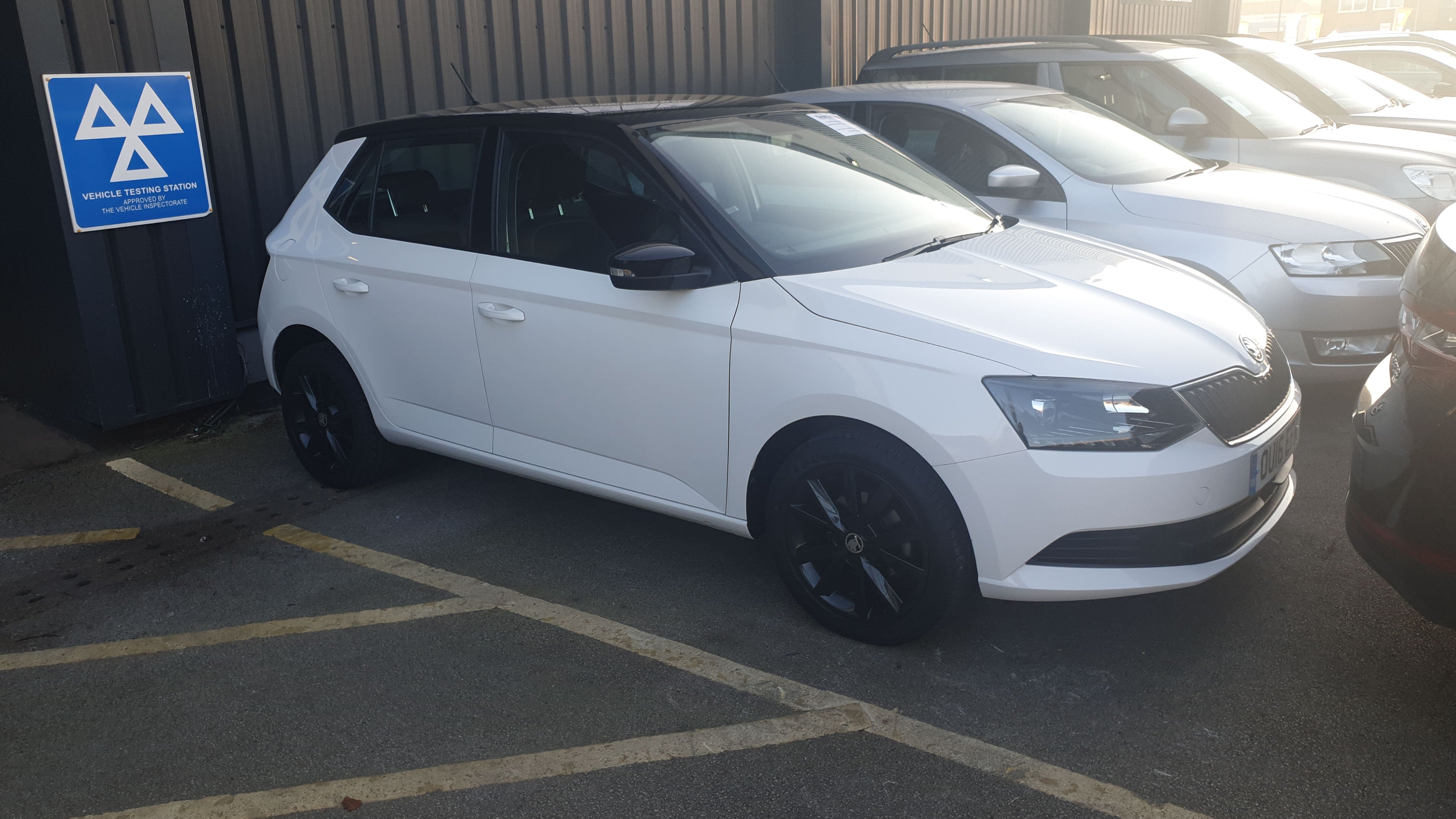

Looking at the picture of the car you posted in particular, it doesn't have front fog lights (oddly? - i thought fog lights were a legal requirement?), if that's not your car, check if yours has them, if not, you can get them retrofitted by your dealer, at a cost, of course.

How is that black and white car a 'colour edition'? :D
Black roof, black wheels, black wingmirrors vs white everything else.
non colour edition would just be white all over, likely with silver alloys.
Some colour editions have white roof/wingmirrors/silver alloys (lot rarer though, only seen one and that was on autotrader lol)
alloys alone wont tell you, ive seen non colour editions which have the black alloys. Its all 3 parts being different to the rest of the body.
