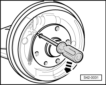

There is a method of releasing the auto shoe adjuster by putting a screwdriver through one of the wheel bolt holes. Lever the adjuster wedge upwards. This will release the shoes from the drum. Give the drum a few taps with a hammer around its circumference if it's stuck to the hub.
https://workshop-manuals.com/skoda/fabia-mk1/chassis/brake_brake_mechanics/repairing_rear_brake/resetting_brake/

If you use a torch (phone is ideal) shine through a bolt hole positioned just past 12oclock position rotated a little toward the front of the car. Look through next hole down in direction of front of car and you should see the bottom of the adjuster wedge pulled down by a light spring. Put a  flat blade screwdriver under the wedge and hold the drum and lever the wedge up.
