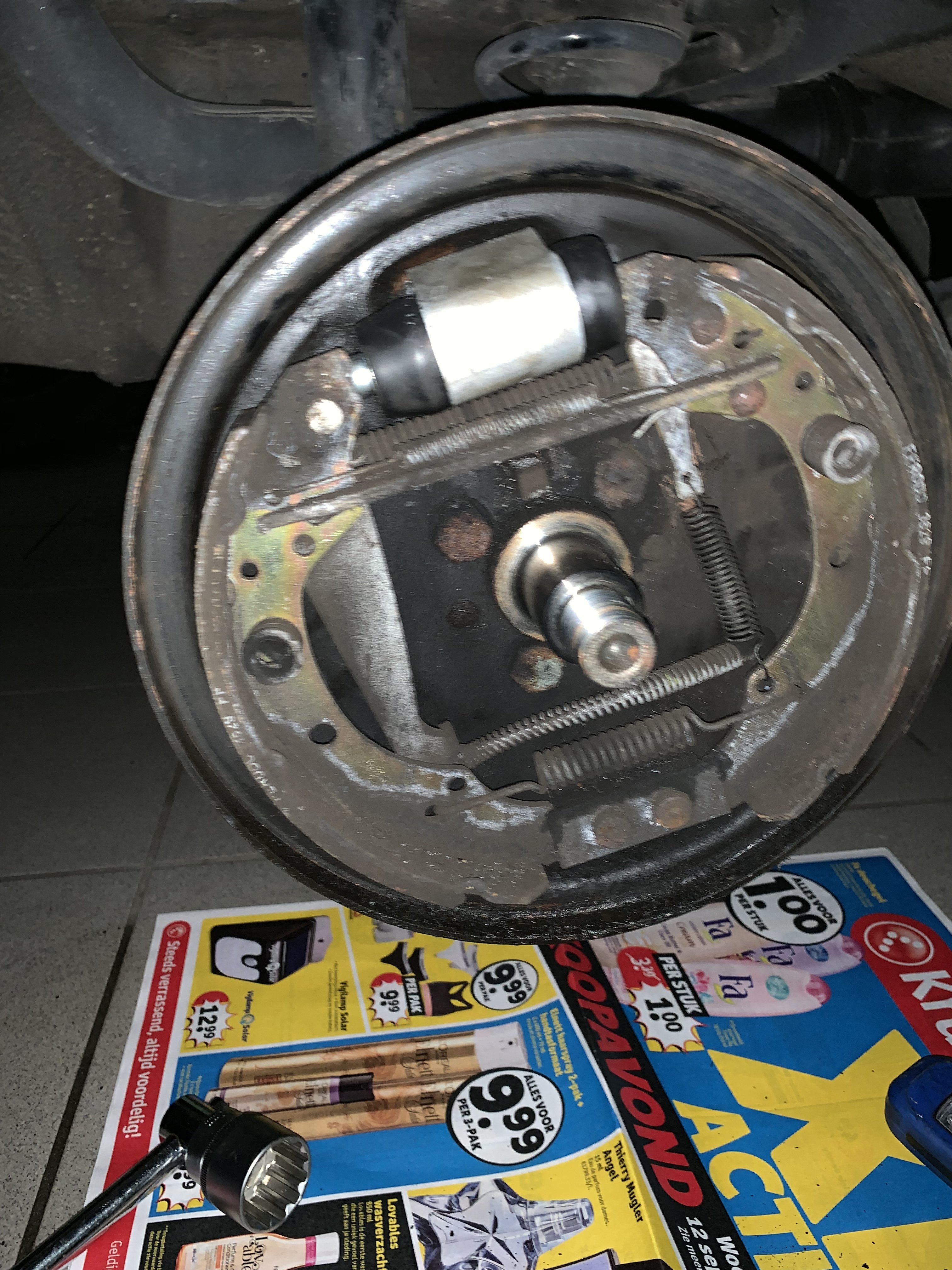

You could always remove the hub nut and pull the lot off. Having the hub out of the way makes fitting a new cylinder/shoes much easier too. You could separate the hub and drum once it's off the car.
I'm going to try this next time I get involved with a stuck one.
At first I thought "brilliant idea", then, a few minutes ago, I thought "but you've still got nothing to really catch hold of to pull". Then finally I realised "you'd just bolt a wheel back on and pull that, or kick it from the inside".  :giggle: :thumbup:
Is there a part number for that special "wheel" tool :giggle:. However on  a more serious note if this is used and kicked from the inside I'd worry about the stability of the car. Sideways forces on axle stands can cause them to topple. However used as extra leverage / pulling power may work from the outside.
I remember Fords of old (eg MKII Cortina) with drum rust issues - usually where the middle of the drum touched the bearing housing near the dust cap. I used to drown in Plusgas for a few hours and then persuade the drum off rotating and tapping around the drum top/inner edge with a cloth covered hammer (never hammer metal on cast drum as it can shatter)

Oh I whacked the sh*ts of the drum no movement and it ain’t cracking it’s verry rusted getting a tool for the hub nut this eve and then looking to do the job correctly. How a simple wrong turn with a wrench can be such a headache awtch

Wino - never looked at the hub bolt side of it, but on one car many years ago , I found that first slackening off the nut tension I could use the nut to pull the drum off bu fixing a spanner across the drum using the wheel nuts. Slacken hub nut to be slightly proud of hub- tighten spanner on top of hub but and then turn drum to wind off nut and thus apply tension to drum . Sometimes an adjuster 2.5lb might be needed ( AKA 2.5lb hammer) to aid drum removal . I've never had a problem getting drums off .Most of the earlier cars were drum all round  .  I found that either the drum came off leaving shoes in place, or as in Furby case- the drum dragged the shoes off. ( The one car I've never had to resort to the spanner method)
As an updat by getting the 30 mill 12 sided nut of the bearing and drum came off as a whole. Brake cylinder has been replaced but noticed the pedal would still go to the floor afster bleeding... turned out the self adjustment yoke broke off... so lucky I ordered a full set of 2 brake cylinders and pads for both sides :) only got a small question the bottom of the shoes are hold in by bolts it seems?
No the shoes are not held by any bolts. Don't know why you would think that.
The 2 bolts at the bottom just hold a steel pad which stops the shoes sliding forward off the bottom pivot.
You need to refit the drum before bleeding.  Make sure the handbrake is off! Lift the adjustment wedge, and make sure the shoes are centred, and the cylinder is balanced left/right. After refitting the drum. Slowly pump the brakes to push the shoes out and for the adjustment wedge to move. Do not apply the handbrake at this stage!
Don't forget to keep an eye on fluid level in the reservoir.
Bleed the brakes.
Press the brake pedal hard several times, this is necessary to get the shoes correctly positioned and adjusted.
Then apply the handbrake a few times. Check the handbrake adjuster which is located at the back of the centre console behind the handbrake. The two cables ends should be balanced when the handbrake is applied, i.e. the cross bar that pulls them should not be skewed. If it is badly skewed, you may need to release the drum adjusters again by levering up with a screwdriver and repeat pressing the brake pedal hard several times. Then recheck the handbrake function and cable cross bar.
There are 4 nylon pads pressed into the back plate (part no 6N0 609 589)  on which the shoes slide. If these are worn or damaged, its best to change these as otherwise they will add to sticking brake problem. If they weren't supplied as part of your kit, they should be cheap from your local dealer.
https://www.skoda-parts.com/spare-part/6n0609589-sliding-part-skoda-10625.html
Edited by xman

Allright evrything is fitted newly now I cant get the drum over the new shoes since its too bigg ... anyone got an idea how i get the tention lower or the shoes closer to eachother?
Are they new shoes?
1. Make sure the handbrake is OFF
2. Make sure the brake cable is attached in the drum correctly and the lever* it's attached to, is pushed as far out as it will allow
3. Push the adjustment wedge right up to let the shoes retract
4. Push the pistons fully into the brake cylinder. You may need to open the bleed valve to do this.
5. Ensure the shoes aren't too high or too low. Push them up/down to adjust.
6. If still difficult, then slacken off the handbrake cables in the centre console behind the handbrake in the car.
*lubricate the lever at the pivot with shoes particularly if the shoes are the old ones as this point is the main culprit for drum brake sticking on
Shoes and all springs are new (bought a full kit off amazon from TRW) will try all of this tomorrow
