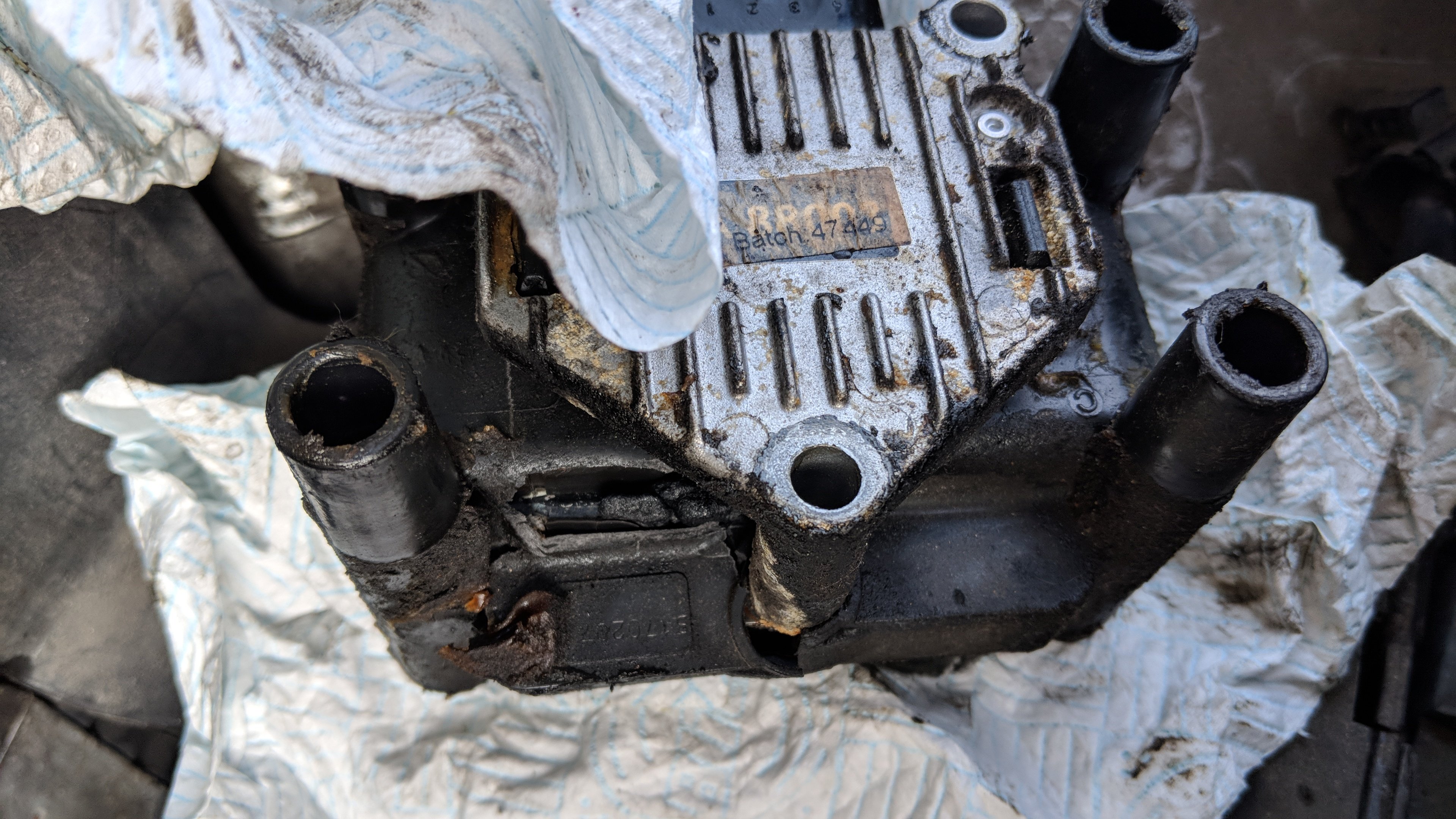

Actually if it has plug leads and the wasted spark module - JUST CHANGE IT. I've been through two on my Octavia 1.4 16v (similar engine).
Attached a picture of a (broken) wasted spark coil pack - some versions have seperate ones per cylinder!
Edited by bigjohn

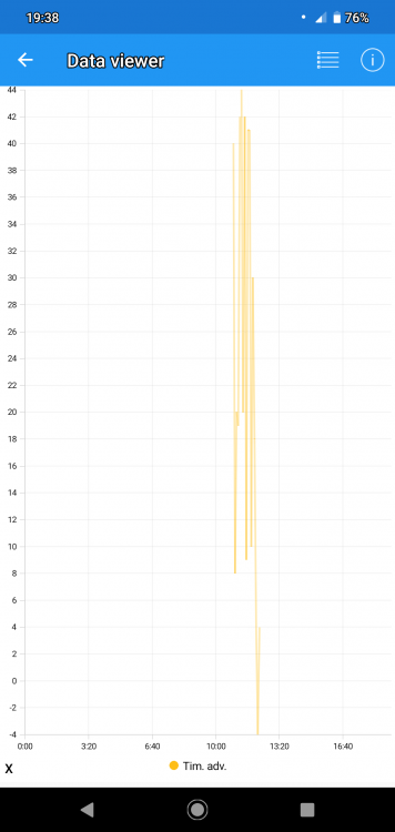

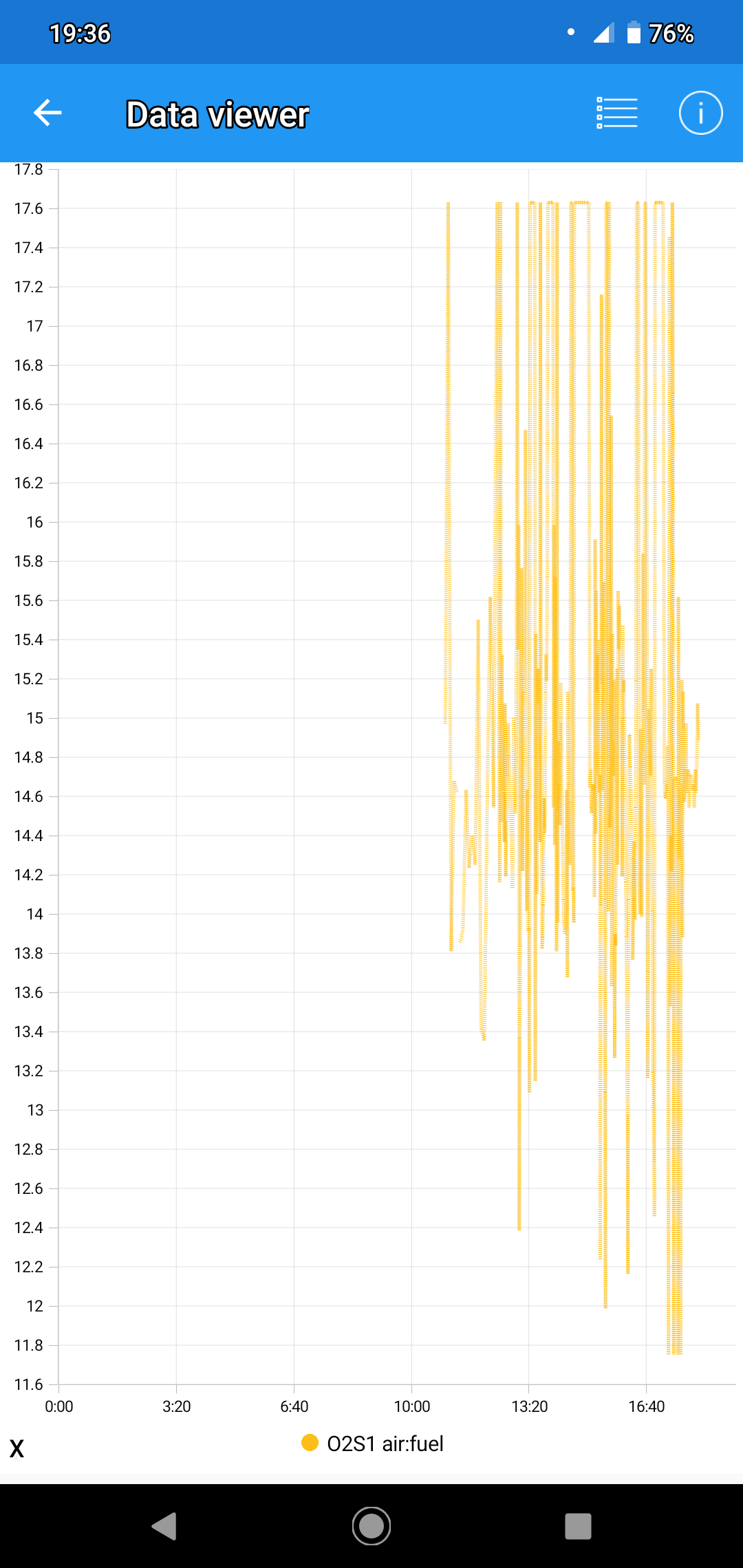

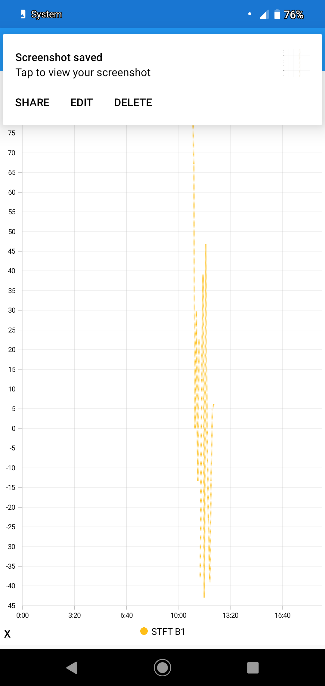

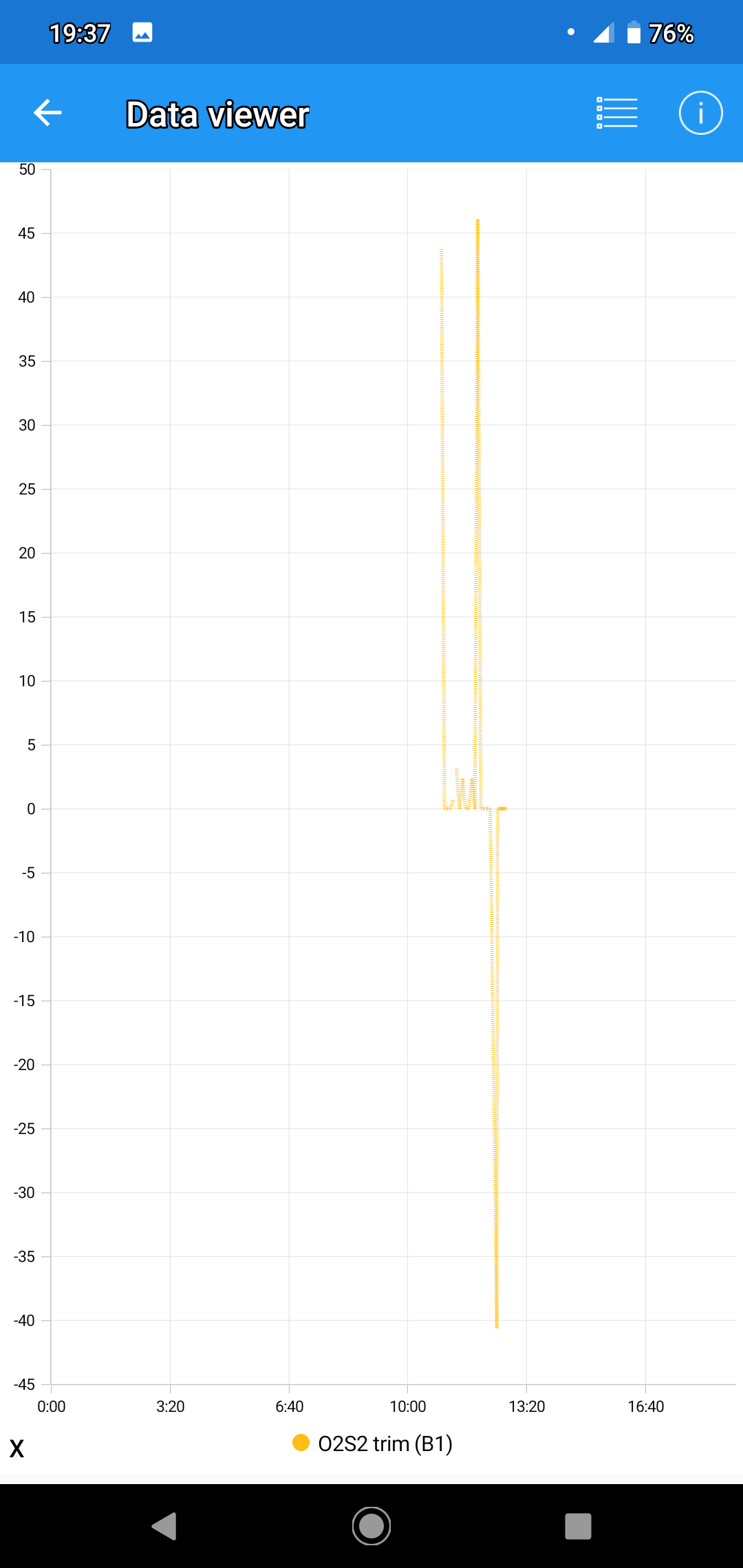

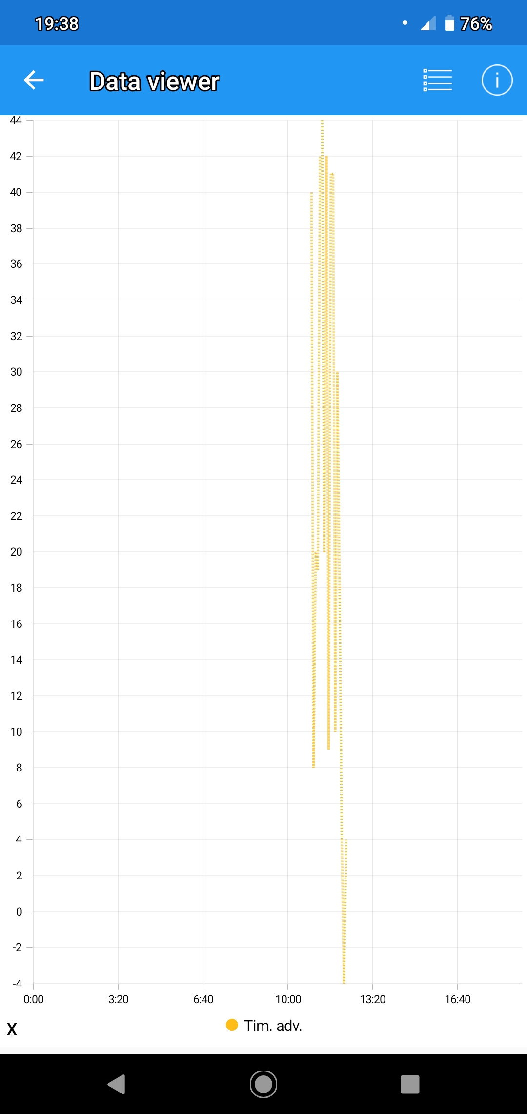

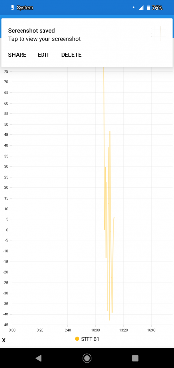

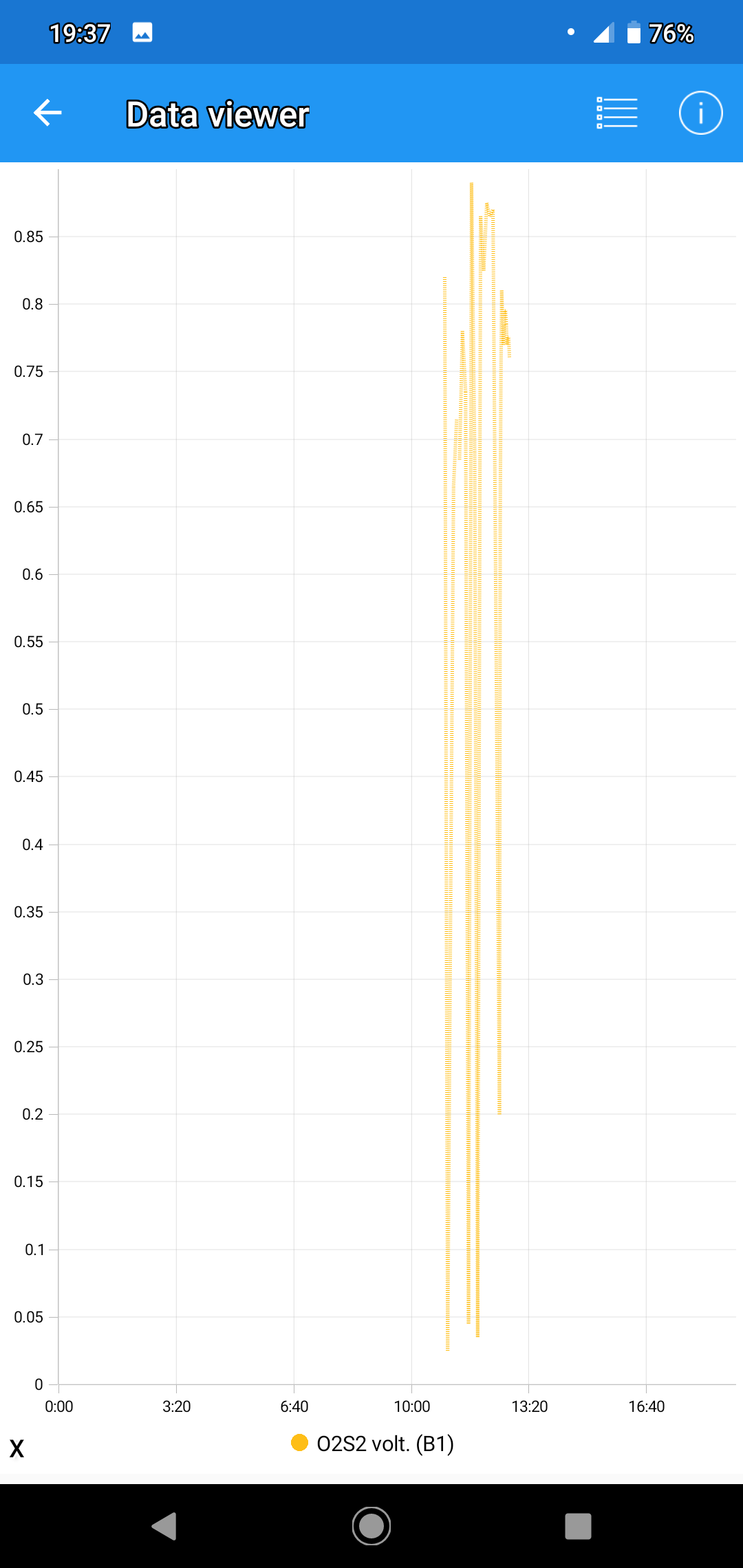

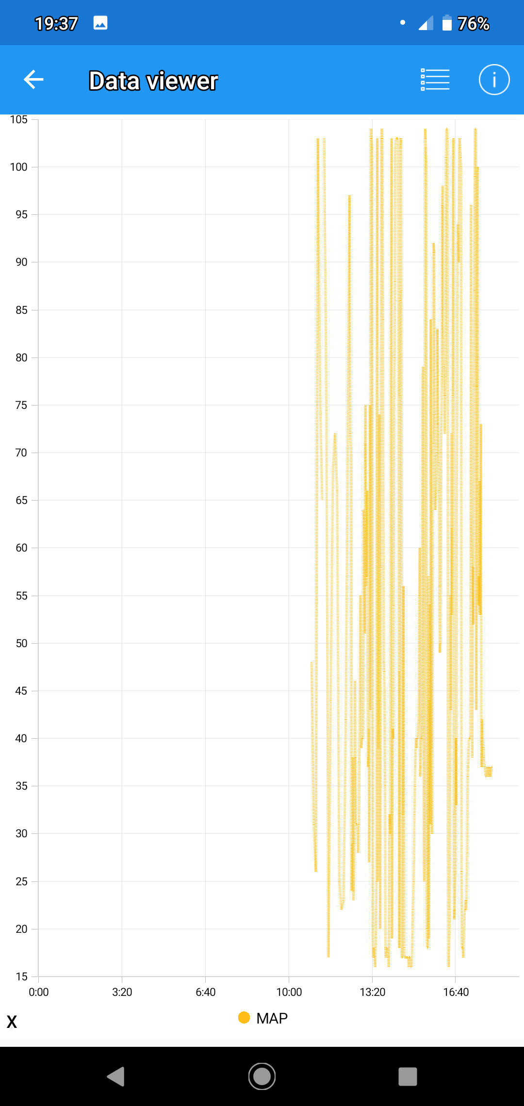

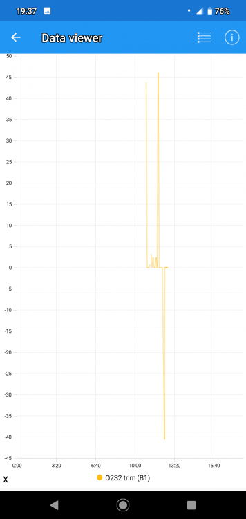

The app I have shows live readings. The AFR seems to hover pretty much around the 14.7 magic number but does fluctuate during acceleration/lift off. Is there any way particular numbers I need to look for, i.e an acceptable range for both front/rear sensors? The flap in the air box was stuck in the closed position when I looked so that's a bonus. Attached some screen shots from app.

I think I'd expect the precat sensor to show a much more stable reading, if it were controlling things in a timely manner.
