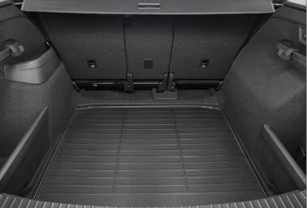

Hi all, thanks for your help.  What I'm actually after though is to get the floor (and supports if necessary) without any spare wheel at all.  If you don't configure the kodiaq with a spare wheel, the boot is far deeper (see below)

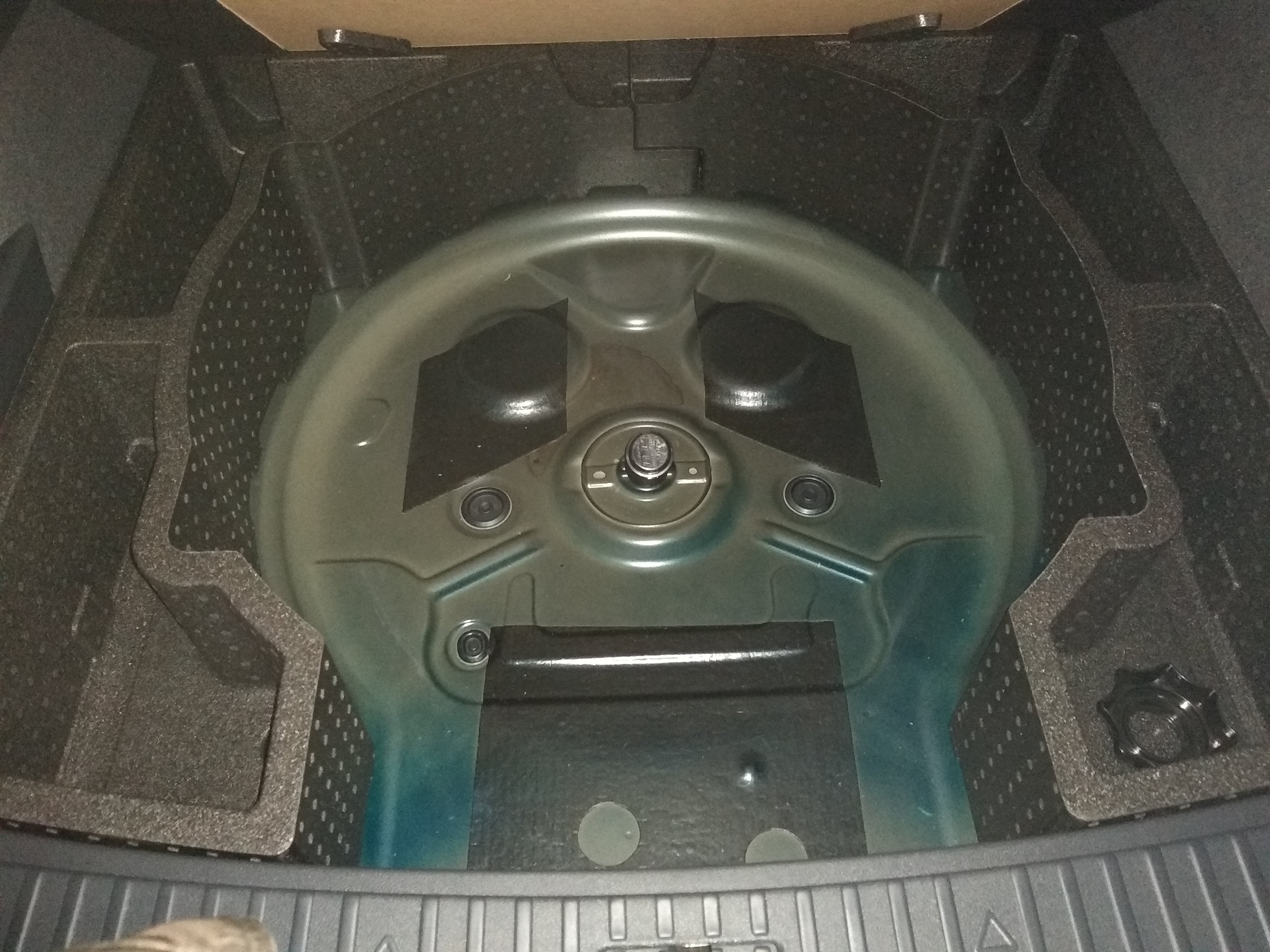

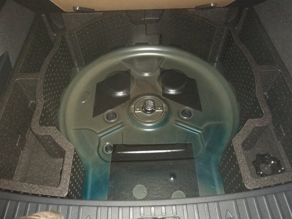

Does anyone happen to have a picture of what is underneath the floor in the 5 seater that doesn't have a spare wheel?  I'd like to see whether the difference is solely the polystyrene supports, because the metal underneath my spare wheel seems shaped especially to accomodate the spare wheel (see below) - I wonder if this is still the case for the version without spare.

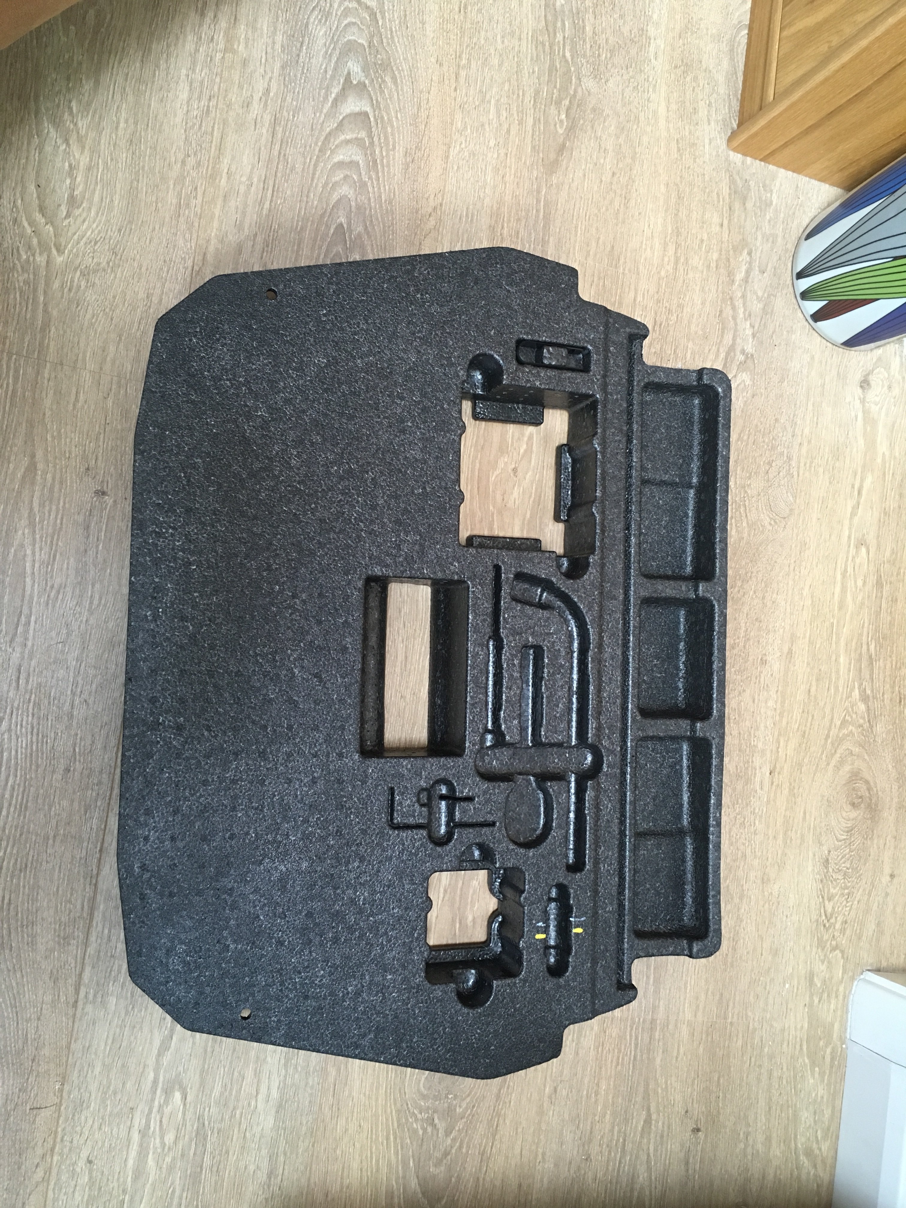

Hi the part number is 565 863 957 and this is what it looks like

Hi the part number I quoted is what is moulded into the polystyrene insert and nothing else. This fits into and smooths over the indent in the floor plan which a spare wheel normally would sit in so you have a smooth floor if you dont have a spare wheel. They may supply it with some tools etc but I am surprised if they want to sell you a wheel as this part would be only  for the 5 seater without a spare wheel!.  The spare wheel kit which others have mentioned is to retrofit a spare wheel into a 5 seater supplied without one.  This includes the tyre, tools and polystyrene larger/higher inserts in peices to fit around the wheel.  As I mentioned before I have both and swap as needed. Earlier in the thread the link to an Ebay listings shows that in situ.
The 5 seater floor mat for a boot without a spare wheel fitted to sit on top of 565 093 860 is 565 863 463 N CA 9 on mine.  I know from previoius discussions with the parts people that N CA 9 is the colour code (I have dark grey - they do a sandy brown as well for example)
