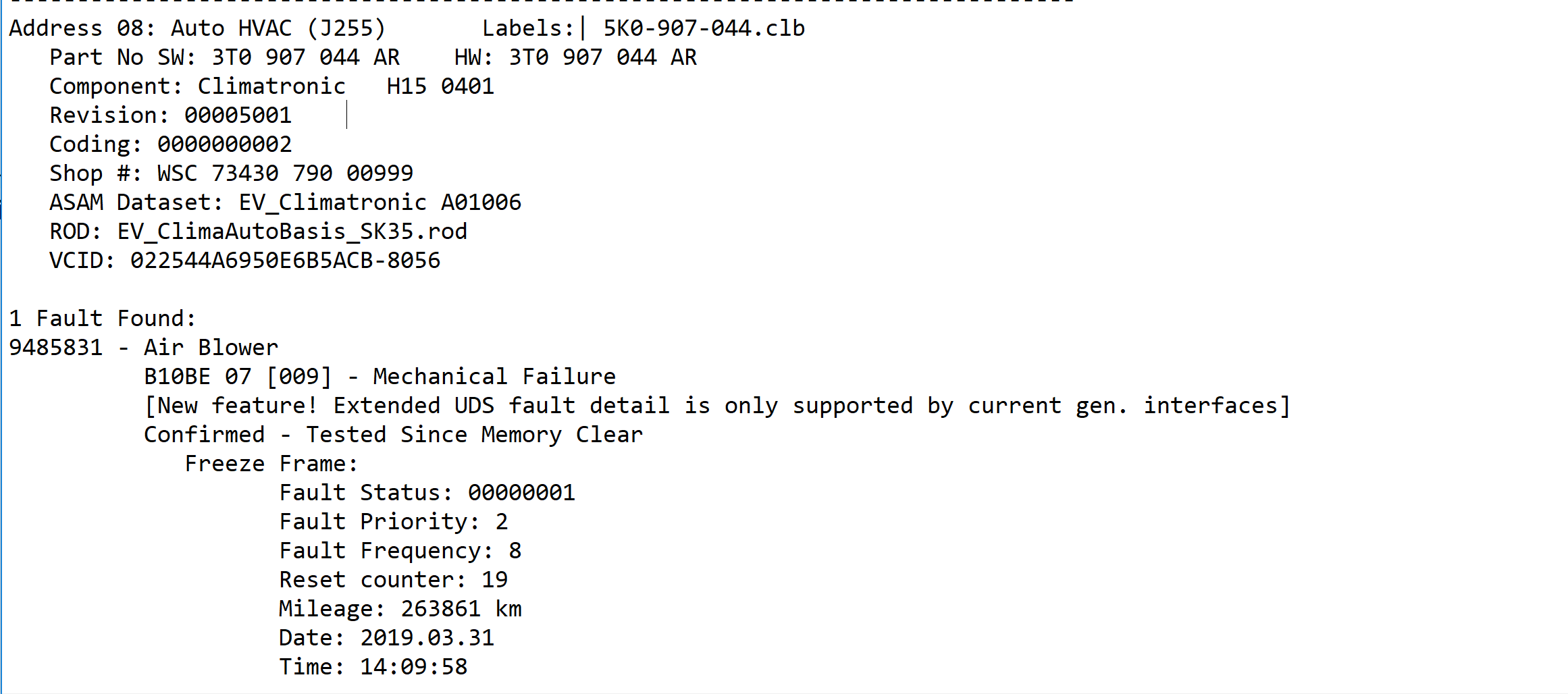

So reset the flaps but still no joy. If plugging into VCDS, what am I looking out for?
Check the pollen filter is not clogged with leaves then check the heater motor shunt resistors, a known fault I believe and which might show up on VCDS if they are monitored, someone else can confirm.
VCDS will give you a complete view of all modules in the car, including the Climatronic module and sub parts, with details of faults and module part numbers. The fault codes can be decoded on the Ross Tech website (makers of VCDS) together with advice and possible causes.

So carried out VCDS scan and nicely presented with the image attached along with a list of other fault codes with my nav, central locking, parking sensors and few more!!
Looks like it is a new blower.
