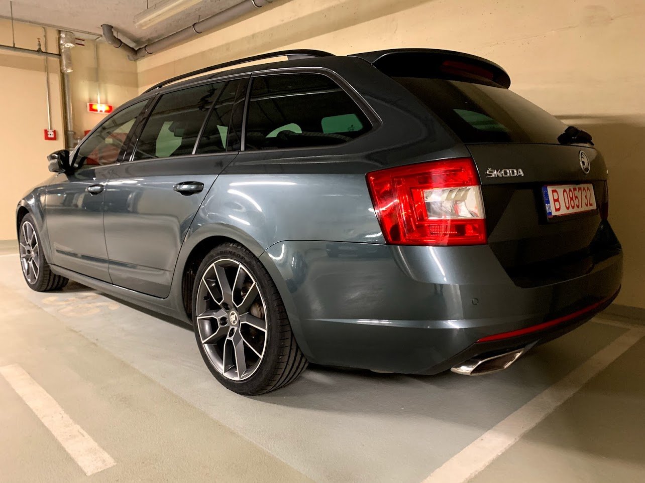

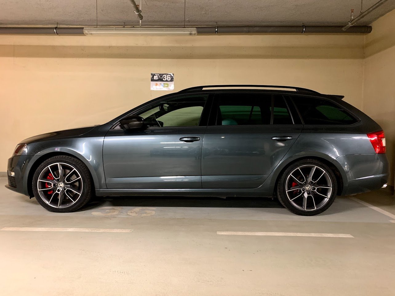

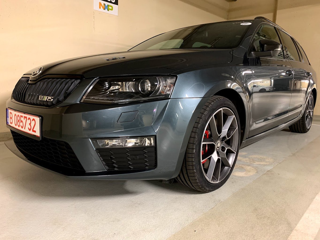

after 3 years with a 2013 octavia 3 combi, 150 hp dsg and 150 000 km on the clock, with modest equipment i bought a very nice diesel vrs with 85 000 km on the clock from 2016. it is such a nice car, lots of options compared to the old one and a very nice ride (rough but joyful).  i also attached some pictures, will add more.
