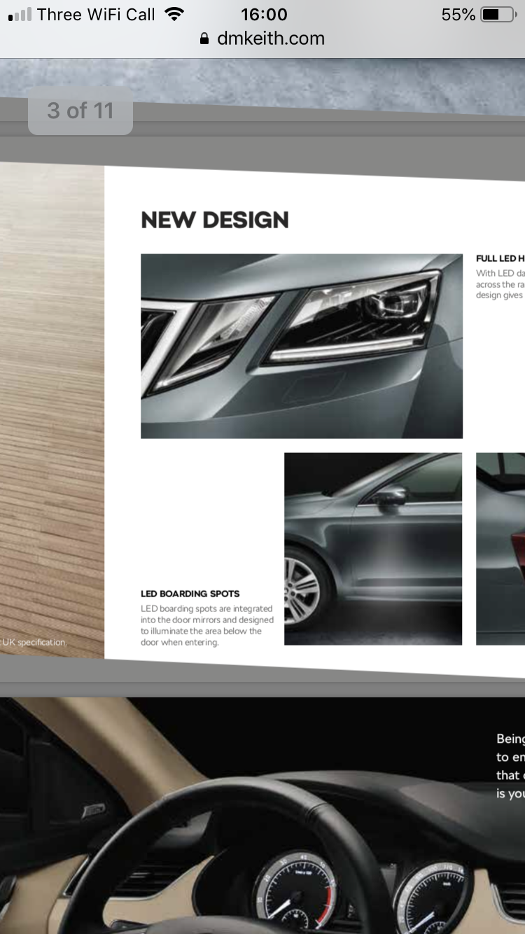

Hi all,
Can anyone tell me whether the genuine facelift puddle lights which I believe are LED (anyone have a product code??) - Do they fit pre-facelift like for like swap??
i am aware of superskoda fabricated ones but interested if genuine ones would fit??
thanks
ryan
Edited by Rybu79
Add brochure

They fit but the wiring is different so they aren’t plug and play. Also they are very dim. Aftermarket LED panels are much better IMO. I have tried both.
