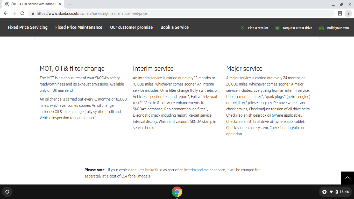

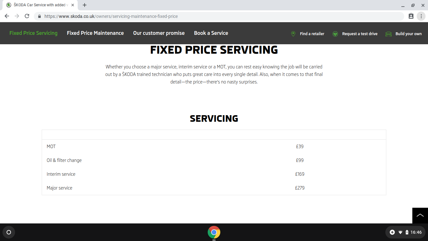

Do you have a Service Plan for Fixed Service intervals?
  Or are you paying for any services as the car goes in?     I would not pay the £169 they might want for a 1st Service.
I would want a 12 month old car even with a low mileage inspected if you are not doing checks.
http://volkswagen.co.uk/owners/servicing/regimes
This is the Fixed Price Servicing on cars 3-10 years old.
I would not pay this for a first service which will be a Oil / Filter service at 12 months and look sees.

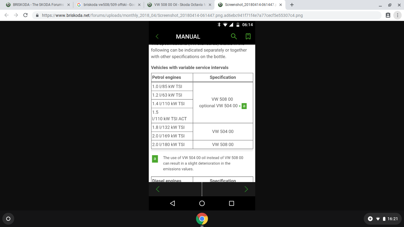

I'm wondering if the new thinner 0w 20 oil is a step towards lower consumption/emissions, for the price of a less effective lubrication?
It was exactly that.
 See
'The use of VW504 oil instead of VW508 can result in a slight deterioration in the emissions values'.
So about WLTP results for Certification / Approval
, emissions and economy when the cars retested possibly as Imported to countries like the UK when still Un-Registered.
No more need to do the 'cheat' of Diesel in the Engine oil.   Not that Skoda would do that, not to say VW, SEAT or AUDI never did.
