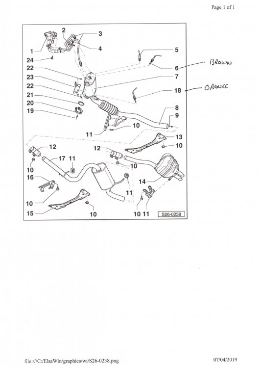

It's black and orange that I've mixed up and I don't know which one goes below the turbo into the manifold. .many thanks
Yeah Black one into the turbo manifold the orange into the upstream end of the DPF
I was wondering because it's tightened up but the sensor is still loose
