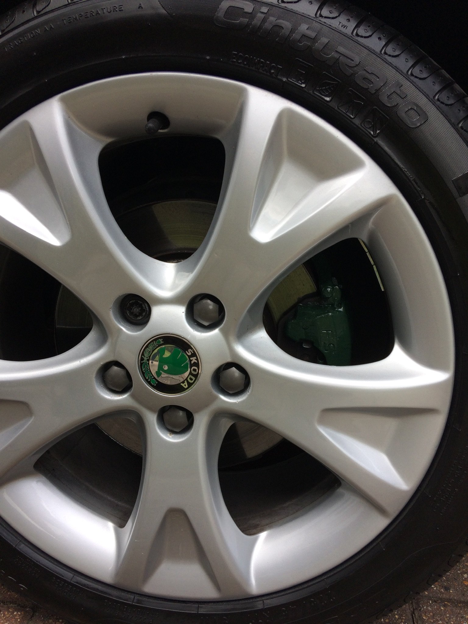

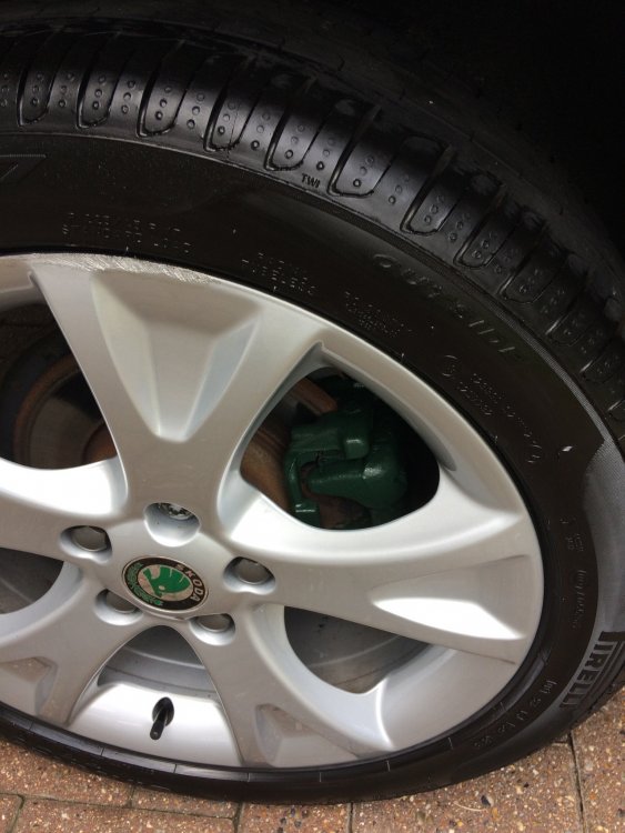

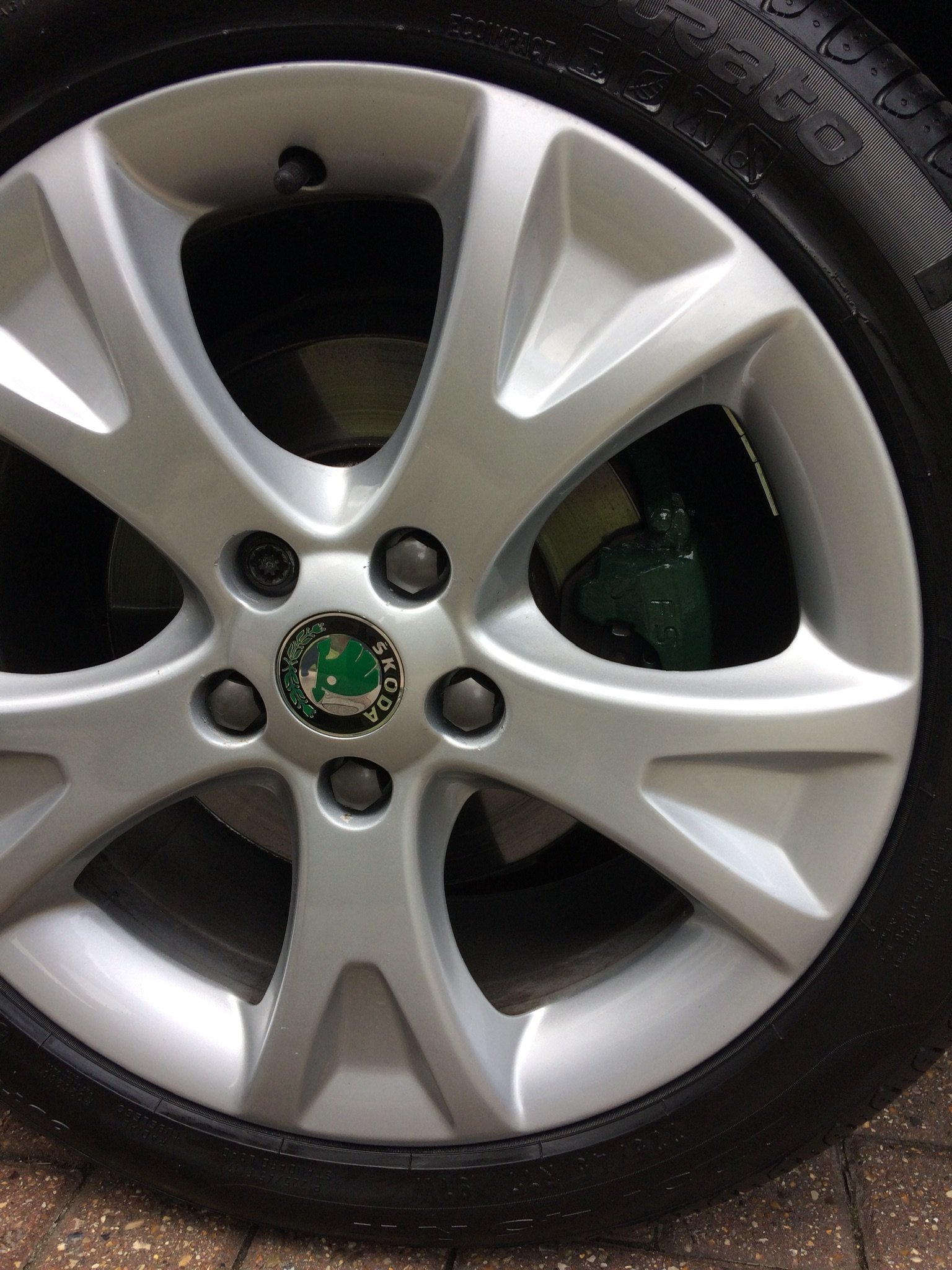

Done my Octavia Estate today British Racing Green,
