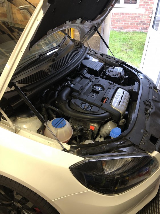

I did do bonnet struts. Forget how much I paid for them but they are really simple to fit, the biggest obstacle being the need to loosen the bonnet hinges to slip the brakes in and re-tighten. Need to take cars so as not to damage the bonnet or lose its correct alignment position. Do one at time and all should be fine. I will try to look back at where I got mine as at first, I was gonna get some which I mentioned here once but they were more expensive and I ended up buying a kit for I think, around £20.

Found where I got mine and they are now a tiny bit cheaper, too!
Aliexpress, The seller was called Auker Auto Accessories store. They came within a few weeks so don't worry too much about that. (There's an eBay seller, selling a similar product, for £40-odd quid). Go to aliexpress and type in this.
Car Bonnet Hood Support Lift Spring Bracket Strut Bar Hydraulic Rod for Skoda Fabia 2007-2019 Car accessories

I mentioned (And negotiated discount for this site) The Soki ones a few years ago but the prices went up and are now over £50, for what you can have for less then £18 on Aliexpress!

fairplay for the negotiations and I undertsand your point ref cost V aliexpress, unfortunately I....as have many others around the world I'm sure been burnt by chinesium quality and I just don't buy into cheapness.
PS just looked at ALi, personally I don't like they way they mount to be honest, the Soki ones are far better "imo"

Three times better? Depends on your budget, I suppose. I would rather have the functional £18 ones, then the more expensive variant on my 11 year old Greenline driving school car but if I had a nice, expensive shiny VRS, I might have had the better ones, too! The cheap versions do the job though and lets face it, the gas shocks are all most likely "Chinesium", as you put it. The brackets are purely aesthetic.
