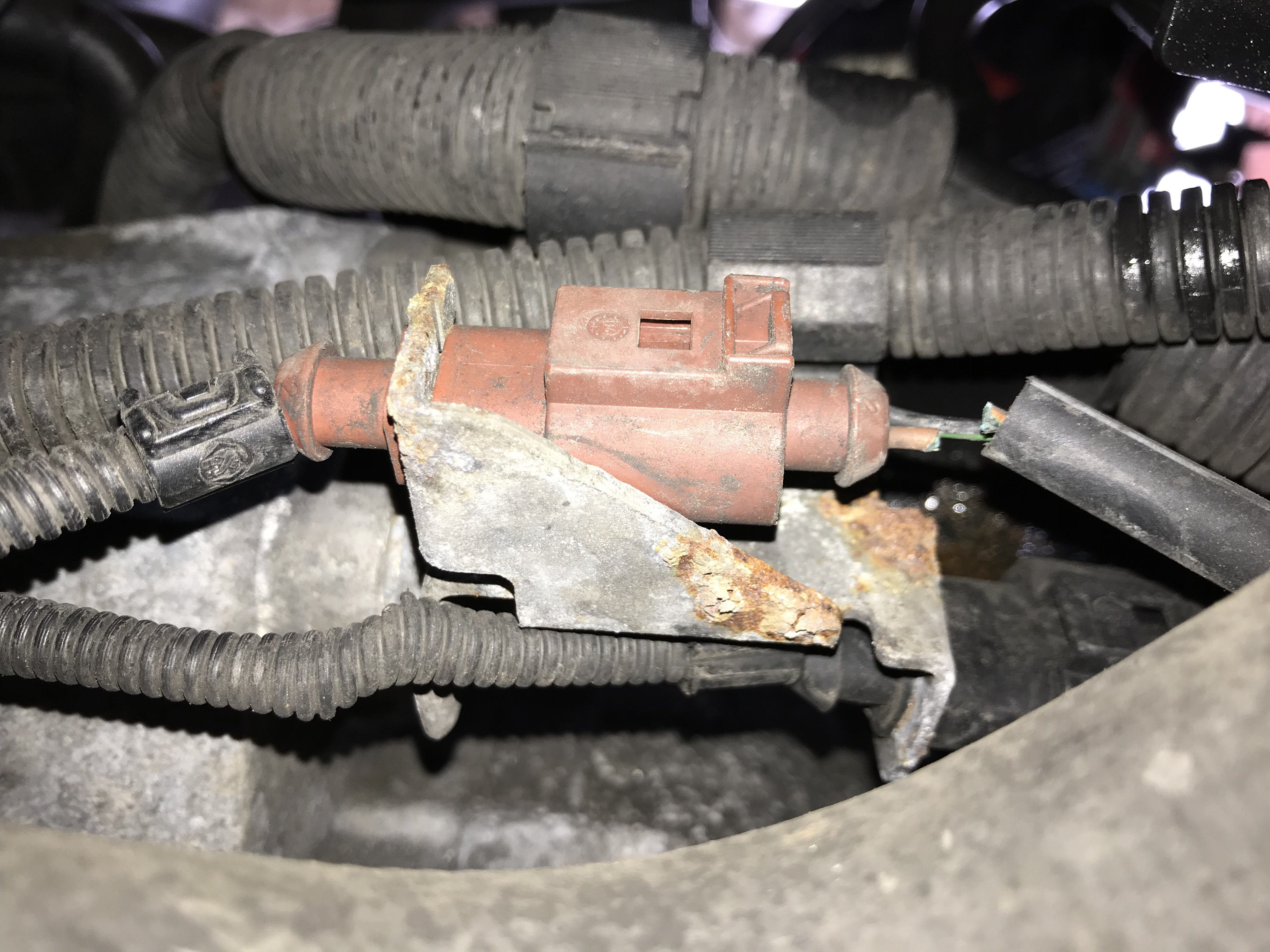

Check the wiring near the brown plug/socket connection on the bracket on the front of the gearbox.

As Wino has said, worth checking as mine had a broken wire....

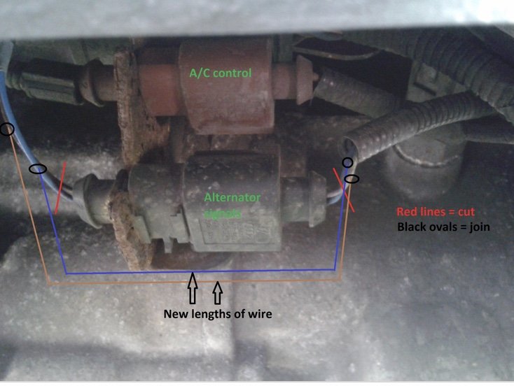

So,decided yesterday to have a look at this problem as the weather has warmed up considerably, removed the belly plate and there it was,a broken wire on the brown plug,when I moved the wires to have a closer look the other wire fell off!
Cut the wires off the other end of the connector plug and soldered in 2 short lengths of fresh wire,started car and it’s blowing cold within about 30 secs.Result!
