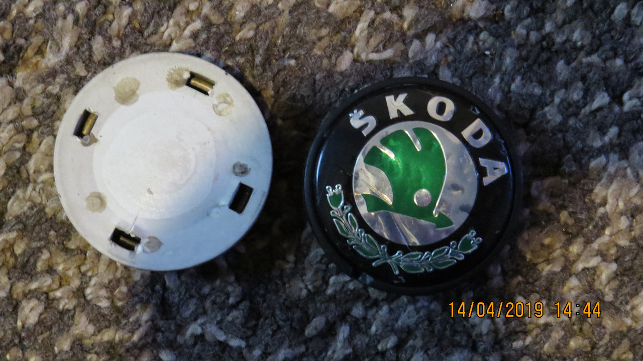

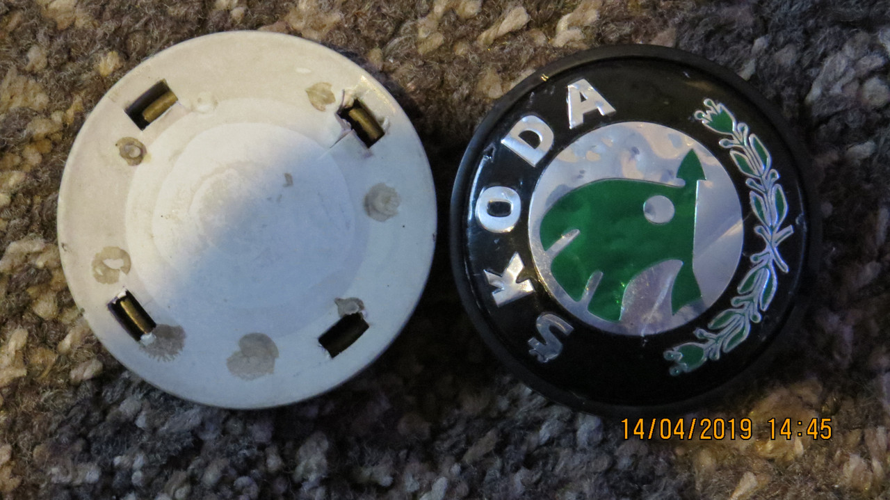

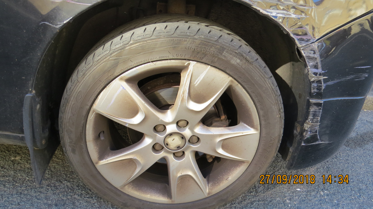

as you can see, on my wheel i have 4 holes and the new logo what i bought has got 8 clips.
I see the issue now. You need to pull those centre pieces out. You have just removed the covering bit but not the whole cap.
Where you have the holes in the caps, try slipping in a screwdriver or something and prise the whole bit out and then the new ones should just push in.
The clips you are counting on the new caps, are the back of the piece that is still in the wheel.
If you can't get that centre bit out easily, with either a screwdriver or even screwing in a screw and pulling it with pliers, the slower option is to jack up the car, remove the wheel and press them out from the back of the wheel. A pain in the proverbial but wheel-sorry, will work!

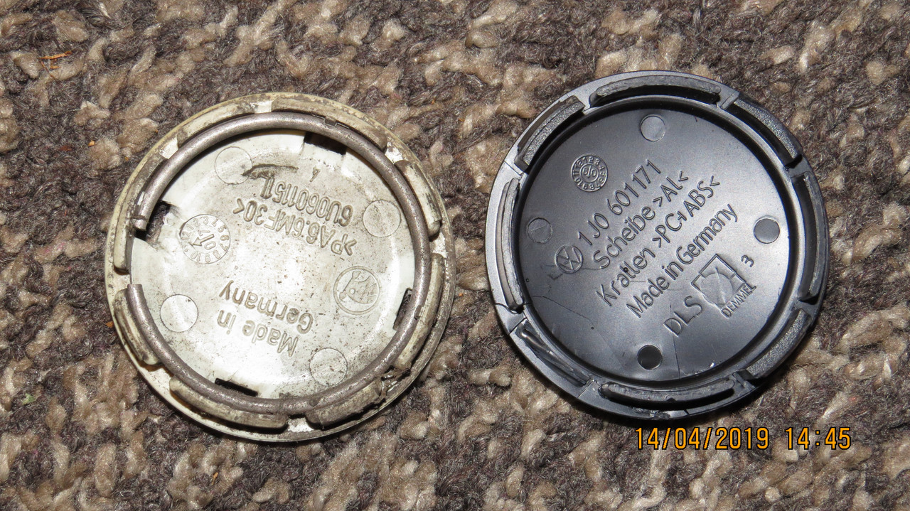

ok i have took the cap out and tried putting the new one in but it wont go in at all. i have put the old cap back on without any problems but the new ones just wont go in.
have put up some pictures, they are both the right size s i have no idea why they wont go in
Well, if you have measured both versions and they both are the same size, then it might be down to one having light weight clips boosted up by that inner spring ring - and the other having no inner spring ring so has and needs stronger heavier weight moulded clips - try tapping them in using a  rubber mallet.
One other thing, if you look inside the original centre caps, you will find the part number that you should have bought instead of the 1J0 version that you bought instead.
Perhaps try popping them in hot water and then tapping them in gently. Otherwise, smear some grease on the edges and tap them in. They look the correct size just might be tight.
Although they appear German, they are still non genuine parts, I think. They look like the Chinese versions you get on well known web sites. look at the VW logo. On Skoda caps, they should have the Skoda logo, which is usually a good clue.
Try placing an old and new one, back to back to see how much difference there is in the diameter, it will most likely be so small you can't tell, without a real close up look or measuring them!
I was thinking more likely, they'd be loose and need a little spot of silicone sealant to stop them falling off but yours id the opposite issue. Perhaps you could get a bit of rough sandpaper or emery and rub round and round the outer lips, until it fits. Again, a spot of sealant if you overdo it.

I bought some replacement centre caps to fit VW wheels I wanted to put on our Superb. VW and Skoda centre cap sizes are different and I bought the correct size going by my measurements and online descriptions. The size of the replacements was about right, but the clips had a slightly different shape and would not easily go into the centres and after some minor and careful filing down they fitted.
File em and fit em with a little tiny bit of silicone to stop any chance of fall out!
