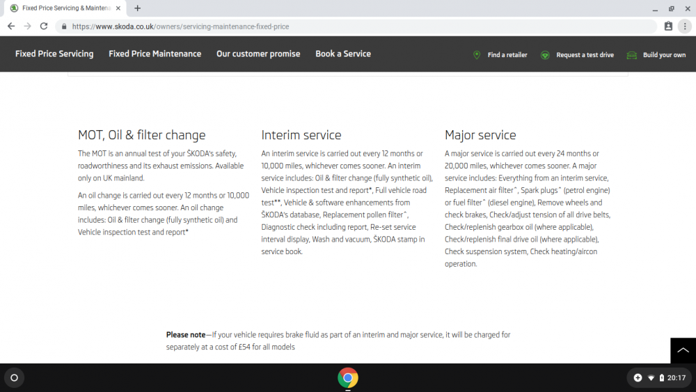

Oil & Filter, Fixed 10,000 miles / 372 days or sooner.  18,000-20,000 miles / 24 months on variable.
Look see's etc.
Pollen Filter and Major Service.
Maybe Spark Plugs at 2nd major service / 4 years, 40,000 miles, same with Air Filter.
Brake Fluid at 3 years if you pay extra.

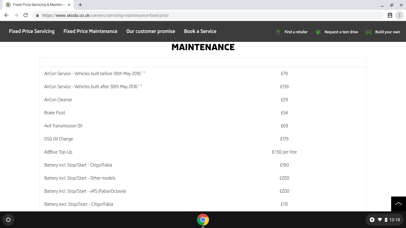

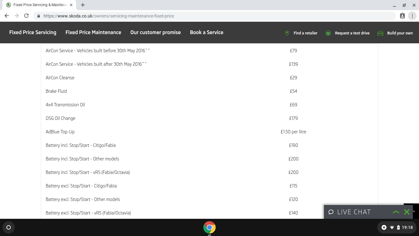

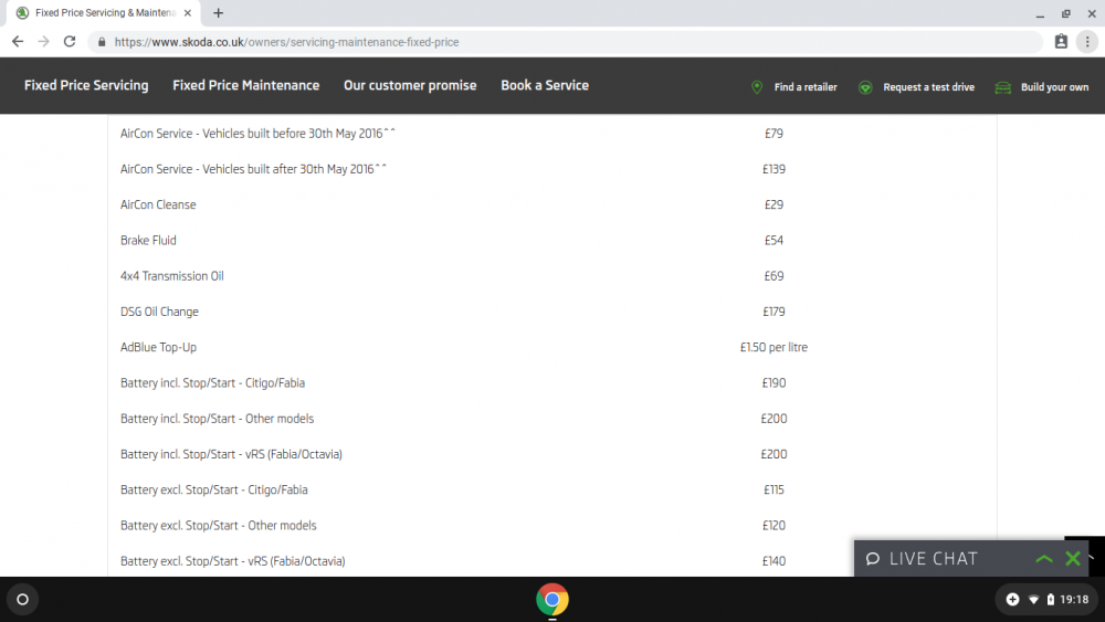

Your DQ200 DSG has no Service Interval or Scheduled Maintenance, so nothing to pay to have done so not expensive. No oil change, no charge.
Cars that have 6 & 7 speed wet clutch DSG's are £179 for a service under the Skoda UK Fixed Price offer at participating dealerships,
That is not relevant to your DSG.

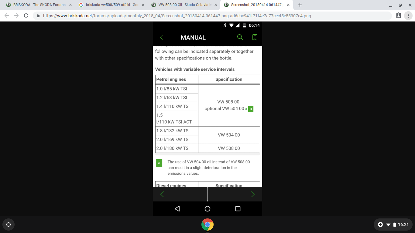

We will see in time just how good the VW508 / 509 so 0w 20 FS LL oil is, which VW Group went to to get the WLTP / RDE results they needed to get.
