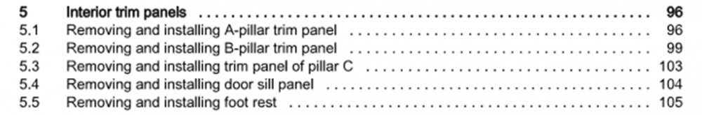

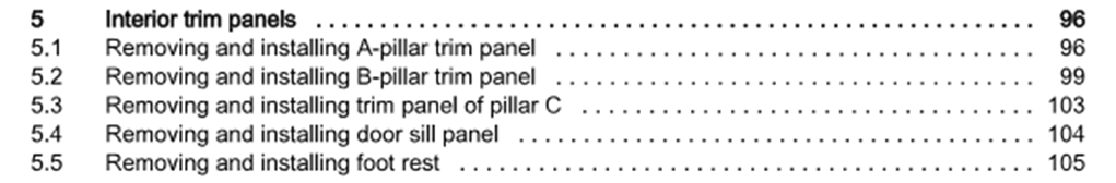

You can download the workshop manual here:
Thanks but the instructions aren't very helpful...

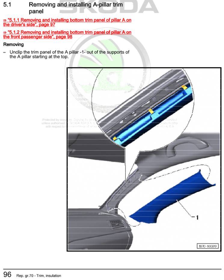

Removing–Unclip the trim panel of the A pillar -1- out of the supports ofthe A pillar starting at the top.
That's it. I could tell when I tried to remove it that there needs to be some sort of upward motion to completely free the clips.
Still looking for help if anyone has done this...?
As the words aren't doing it for you, maybe a picture helps:
:giggle:  :giggle:
Well it tells me where it is and that it has 3 clips but then I already knew that.....
