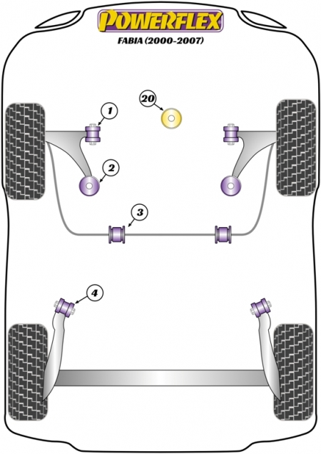

What is a fair price to pay for Cupra bushes and what about the bush located forward of the rear console bush? See No1 on polyflex site diagram
That's not the Cupra bush part number. The number is 6LL407183.
The number you posted is for the improved OEM bushes.
Bush number 1 in your pic never needs touching. They just don't fail.
