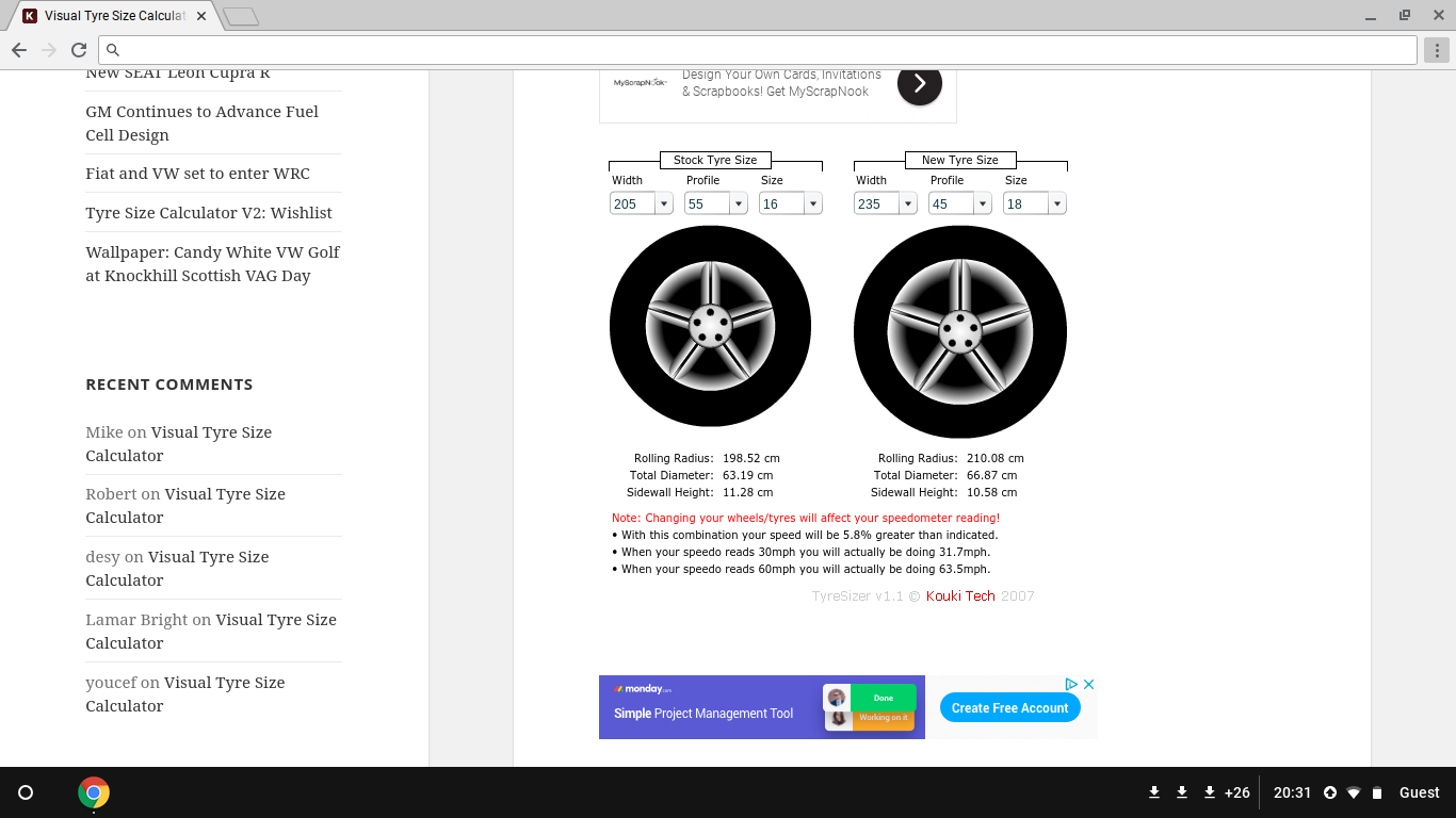

Can I fit these to my 4x4 S3 150 tdi without issue? I'm aware there will be discrepancies in the rolling radius (it's shot with 235 45 18 wheels)  but as I'll be changing all 4 wheels, will it be that big an issue?

I've used them online calculators before and seen the difference in size.

I don’t know about UK but in Croatia it’s illegal to have difference in circumference of more than 2% and your is 5.8%.
Right, point taken.
