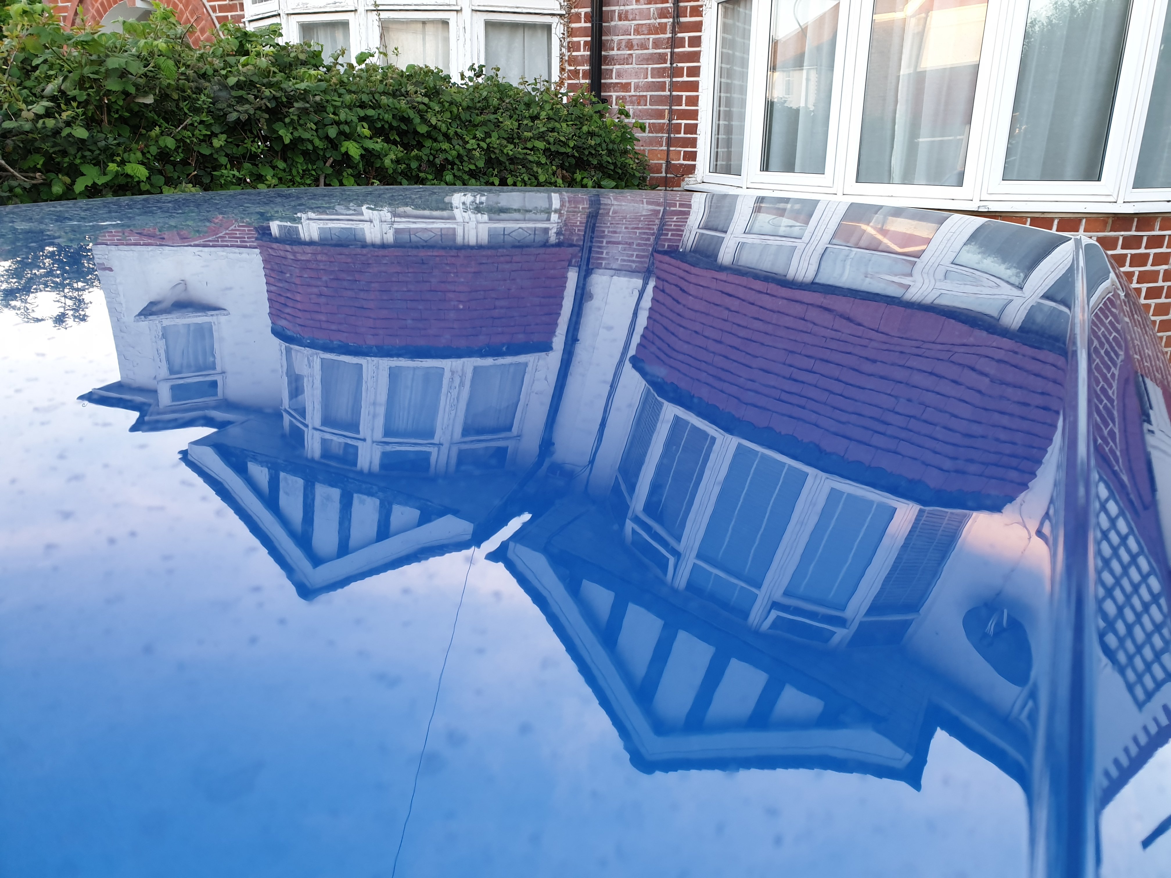

I have a Skoda Fabia 1.0 95 TSI 2019 car...…...After two weeks old I noticed what looks like a warped or distorted roof in several places...…..I know the car has not received damage, there are no impact marks or scratches, no folds or creases in the metal, just warps and a recess in the roof with no plausible explanation...….I have an ongoing case open with Skoda customer services UK, but I just wanted to ask if anyone else has experienced this issue.
Perhaps a deck of a road transporter was dropped on it and the repair job didn’t go to plan?
Naughty kid walked on it?
Photo's would be nice so we can see the damage! But your sort of damage is very uncommon.
Looking at the picture isn't anywhere near as good as the eye...…….But if you expand the pic I attach you can see the distortion via the reflection in the paintwork...…..
I’m convinced that is a repair to a roof with too much filler, or perhaps a cold dent repair that’s caused it. The roof is very thin and both types of repair can cause the metal to warp like that.
Be interesting to hear what SUK have to say about it.
In all honesty it's difficult to see any problems in that photo setting. You need to back it away from the house and you need to have straight lines reflecting on the roof.  However, if you are concerned you must go to the dealer you bought it from.
Look on the roof above where the drivers head would be.
Where you can see the reflection of the top of the downstairs window.
Thanks AG Falco
That’s what I could see :thumbup:

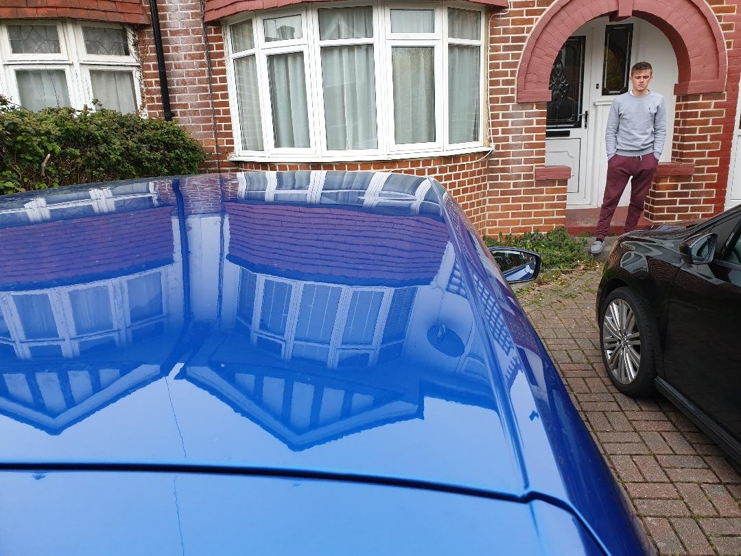

Thanks for your replies folks, I will attach another pic, hopefully when you expand it you will see it a bit better...…...Had the car from new since March...….No known damage to my knowledge. Only noticed this after washing it two weeks after having, and I thought at the time the roof is very flimsy...…..It's parked on my drive in our cul-de-sac, and at my local train station...….There are no folds in the metal, no creases, no impact marks, anywhere on the car.....Skoda UK have said it is not covered by a warranty repair but as a gesture of goodwill they will get some quotes to repair the issues...….I spoke with them today and they are waiting for a written quote from bodyshop via the local dealer, and they will book it in for repair.....Works would involve removing the head lining and pulling out each dent area and possible spot weld work...…...Even the approved coachworks company said it looked like someone had run over the roof but that they couldn't see any point of impact damage or scratches anywhere on the car!!
There are ways or pulling that out without the head lining being removed or the paint being damaged.

I am a PDR guy and have been for over 25 years, there is nothing hard for a decent dent guy with that damage, may not even need to drop the head lining to get a tool in. Bodyshops hate us guys that can do work like that, although the clever one's will use us and bill up a lot more.
Well the good news is that it has been sorted...….Skoda UK paid for suggested body shop of the dealer to work on the issue...….They completed an excellent job...….The Bodyshop manager explained that after they'd released the head lining they noticed two of the support struts were bent, but they got in their dent specialist who completed three hours of work and now the roof is looking good with no defects that my untrained eyes can see 👍
