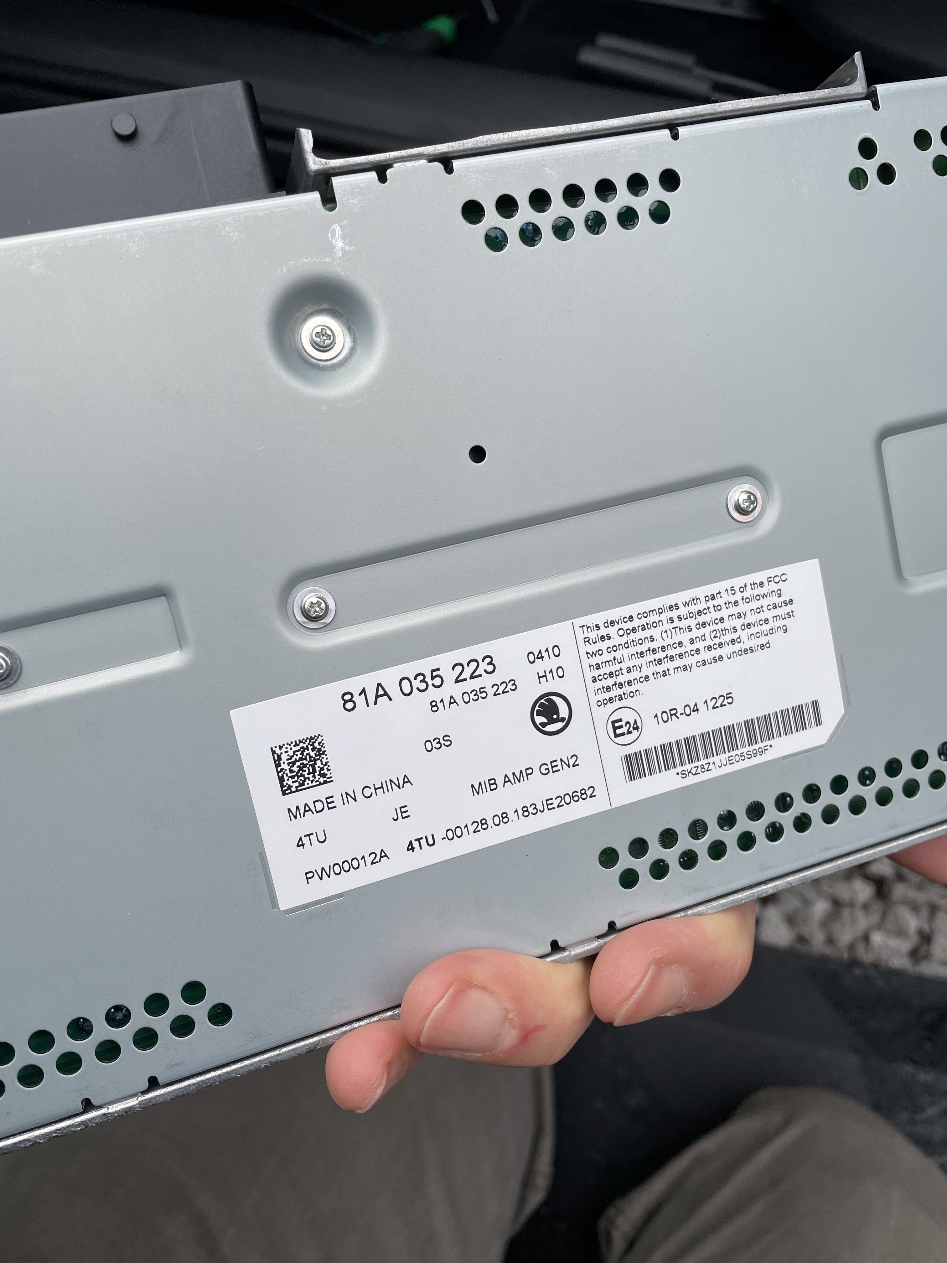

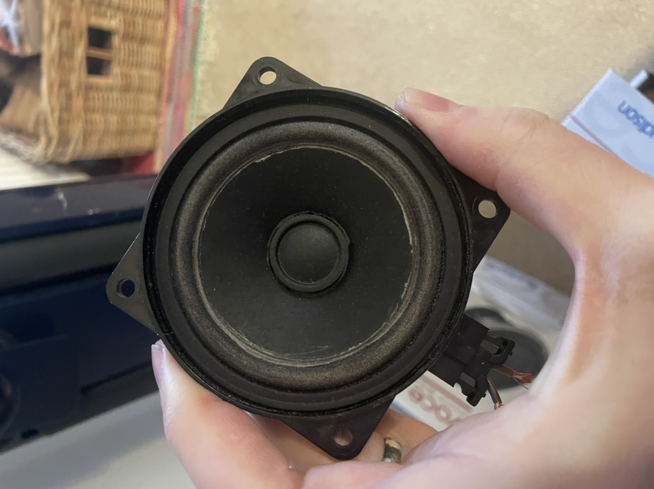

Is still a work in progress:

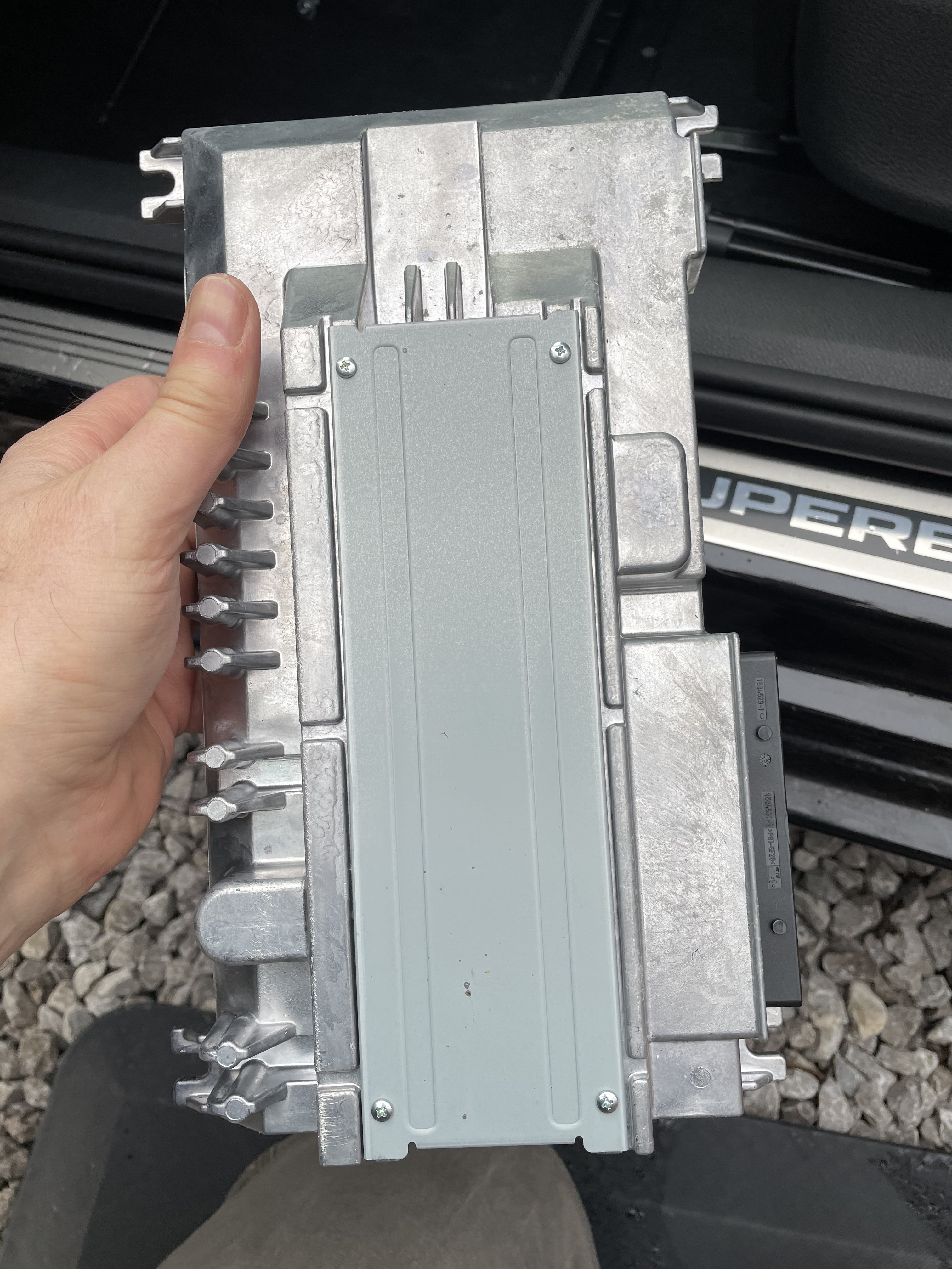

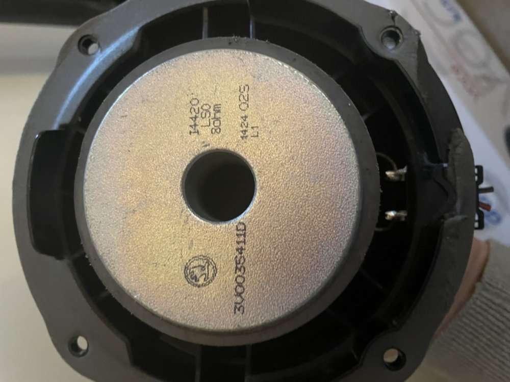

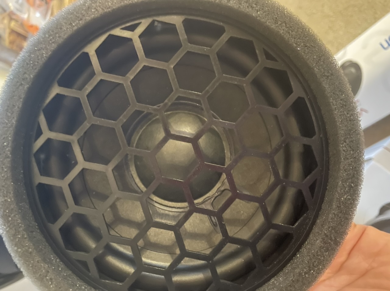

I’m in the process of getting my Canton upgraded in my 69 plate 272 estate.
Truth is, the Canton spec front speakers are cheap Chinese paper cones. As far as I can tell, I don’t think they’re any different from regular spec. The amp is a cheap standard VW jobbie.
My impression is that “Canton” spec simply adds a crappy one-note subwoofer and a dubious EQ curve - they might well have just named it “polish the turd”.
Pics of Canton speakers and amp attached,
Ben.
Edited by Bejam

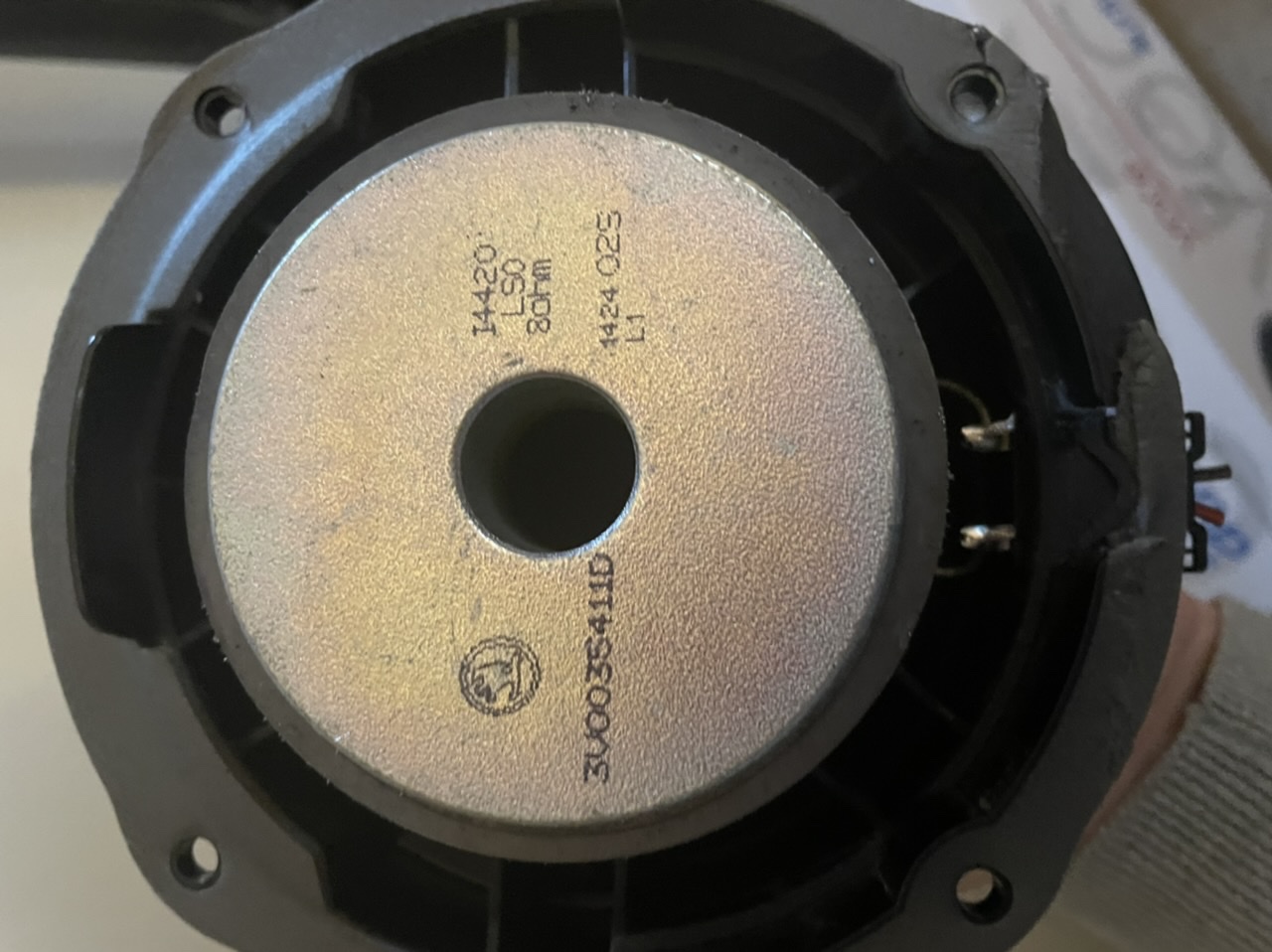

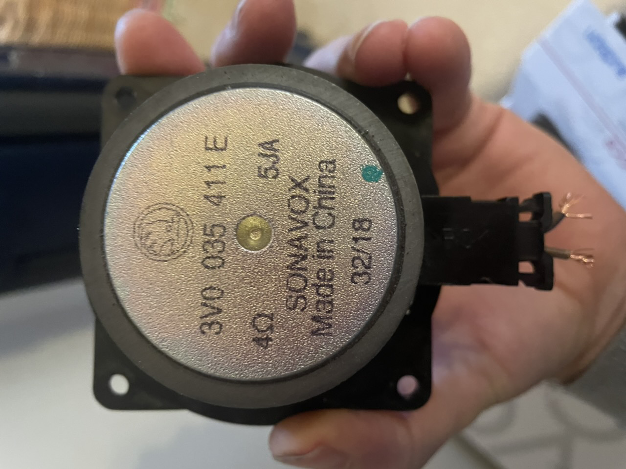

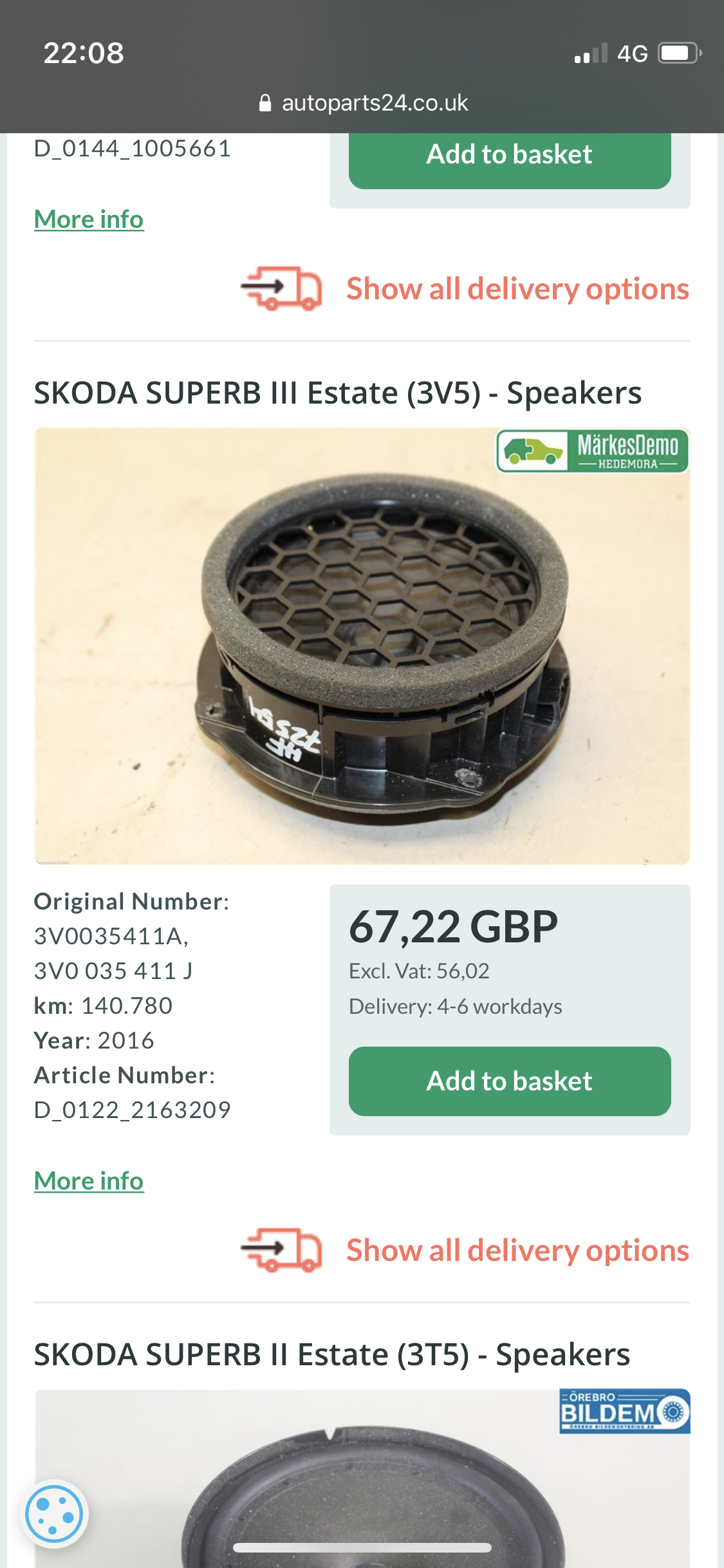

6” Canton door woofer is standard spec:
https://www.skoda-parts.com/spare-part/3v0035411j-bass-loudspeaker-skoda-40033.html
https://www.skoda-parts.com/spare-part/1z0035411e-mid-tone-loudspeaker-skoda-29103.html
So, yes, Canton speakers are indeed just regular VW/Skoda speakers.

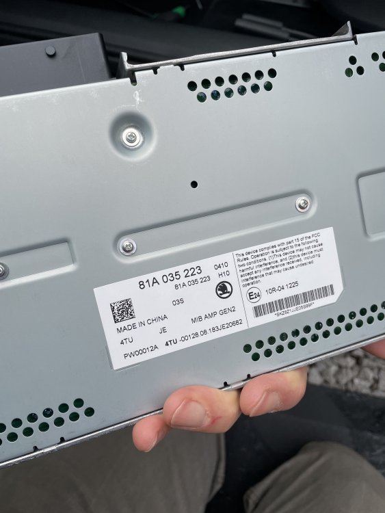

Amp is standard Gen 2 MIB amp.

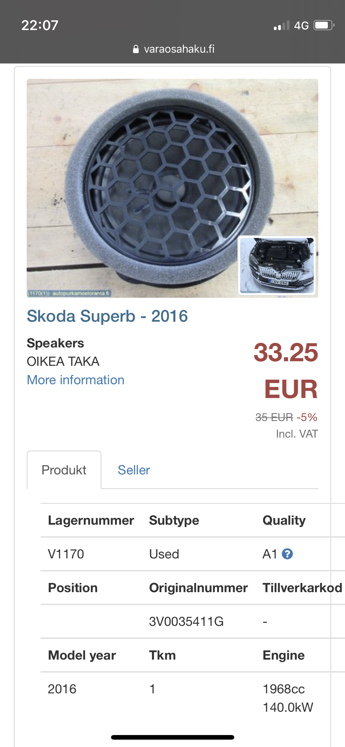

So your “Canton” money really just buys you a bloaty sounding dual 8ohm cheap pressed paper coned subwoofer, which just further masks the poor sound quality of the other components:
I’ve gone for Audisson Voce replacement 3 way components plus an F8.9BIT amp, Zen V-150 DAC and a JL Audio W3 8” sub. Being fitted by Audiofile in car, Bishops Stortford, early May.
Ben.
Couldn't agree more Ben.
It's shocking to sell the Canton system as an upgrade, and I certainly wouldn't consider the 'sub' as a sub at all
Sure, for the additional price, compoments are cheap, but overall quality is not bad and certainly worth over standard sound. Subwoffer is certainly powerful enough for most people.
